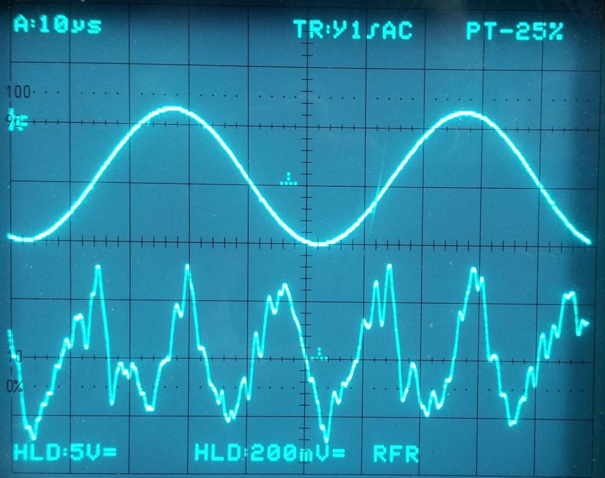

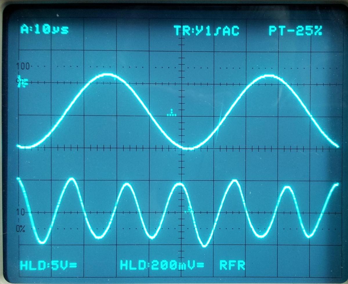

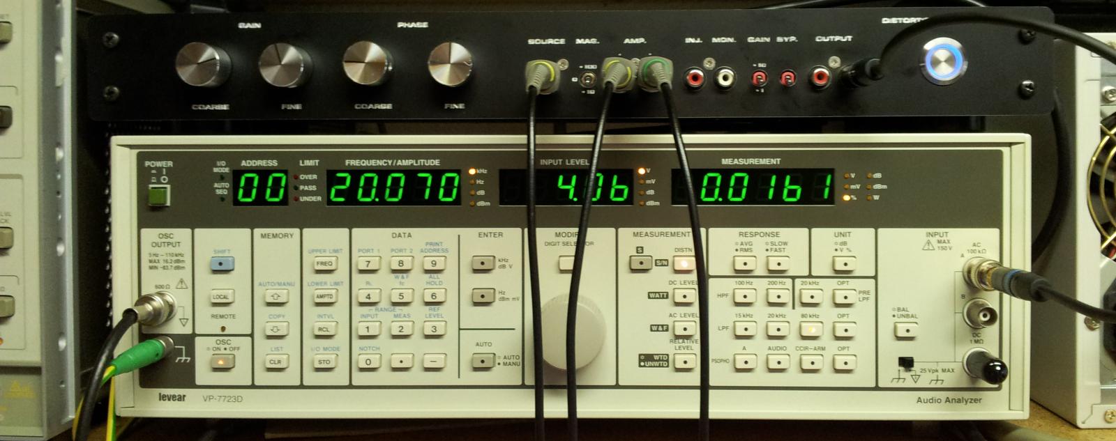

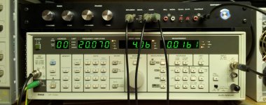

Can you probe the DM output on the scope so we can see what it looks like? IE whether it is H2 or H3 would be a big clue.
Voila!
2 Osci screen shots THD20k@200W@8R with and without 80kHz filter.
Signal CH1 taken from DM output - 4Vrms is 40Vrms real output voltage.
Signal CH2 is taken from monitor output of VP-7723D.
1 screen shot from THD analyzer setup: VP-7723D combined with Distortion Magnifier (by Bob Cordell).
Think mostly H2 - or am I wrong?
BR, Toni

I see mostly compressive H3. This is because at the output peaks the residual is always dragging it down.
It seems H2 is a lot lower than H3. Does this agree with simulation?
Can you check harmonic levels of the residual with a spectrum analyzer (if you have one) or a soundcard?

Using DM monitor output and spectrum analyzer HP-3585A H2 is 93dB and H3 is 91dB below fundamental at 20k@200W8R. Is 2dB a lot lower?
On correctly interpreting waveform of residual a la "mostly compressive H3": is there any literature online available? Maybe you know a link or some other source ...
BR, Toni

Astx, you don't need to read about it. Just use the simulator and put a bunch of sine sources in series. The first one is the fundamental, the rest are harmonics. This way to can look at the residual and each harmonic individually. Then you will come to understand how they add up.
Admittedly, I haven't done this recently, and I haven't done it enough to get any skill, evidently. But I CAN tell H3 is one of the biggest contenders.
2db is definitely not a lot.

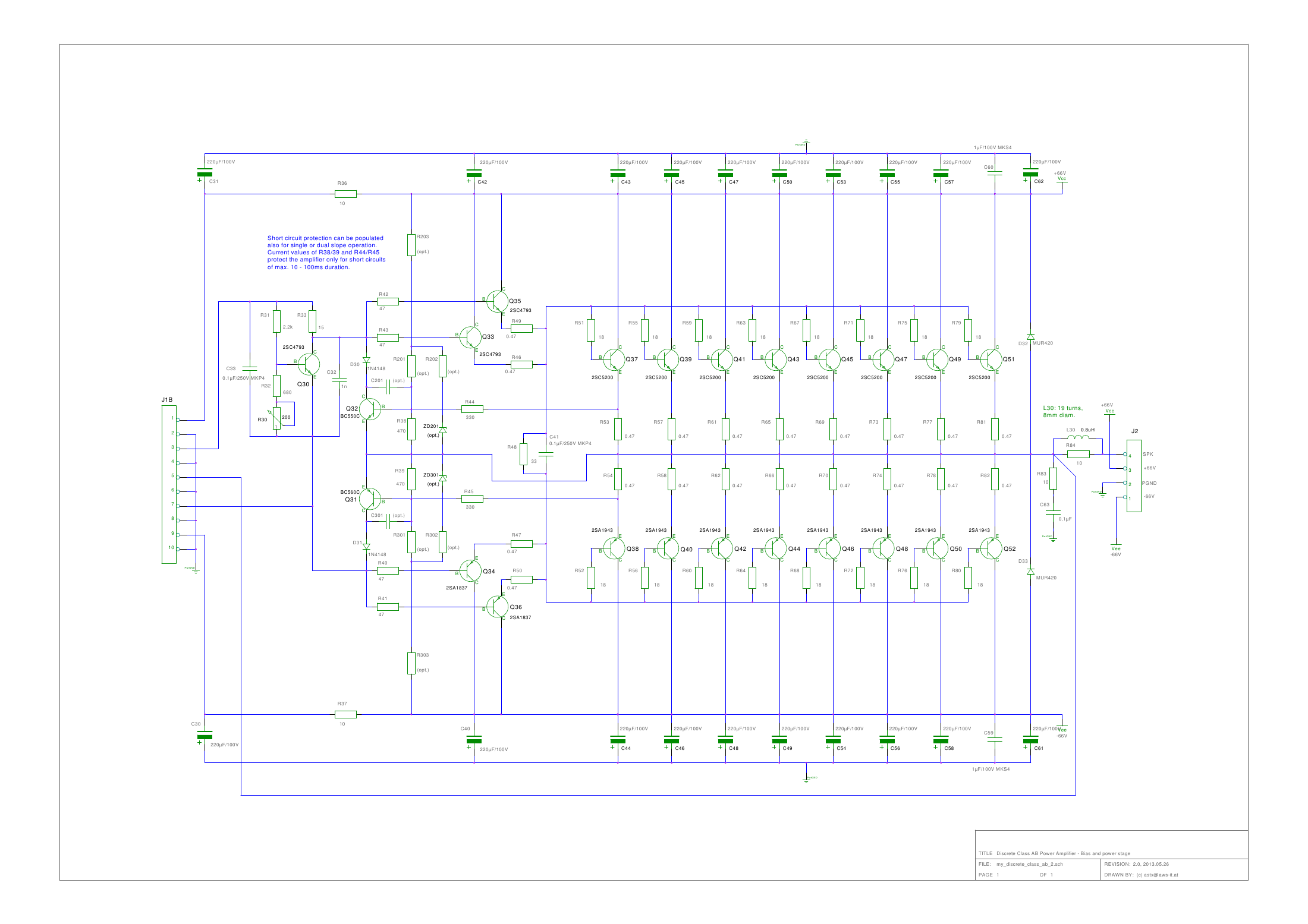

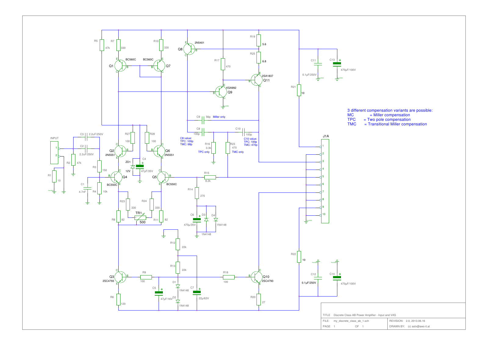

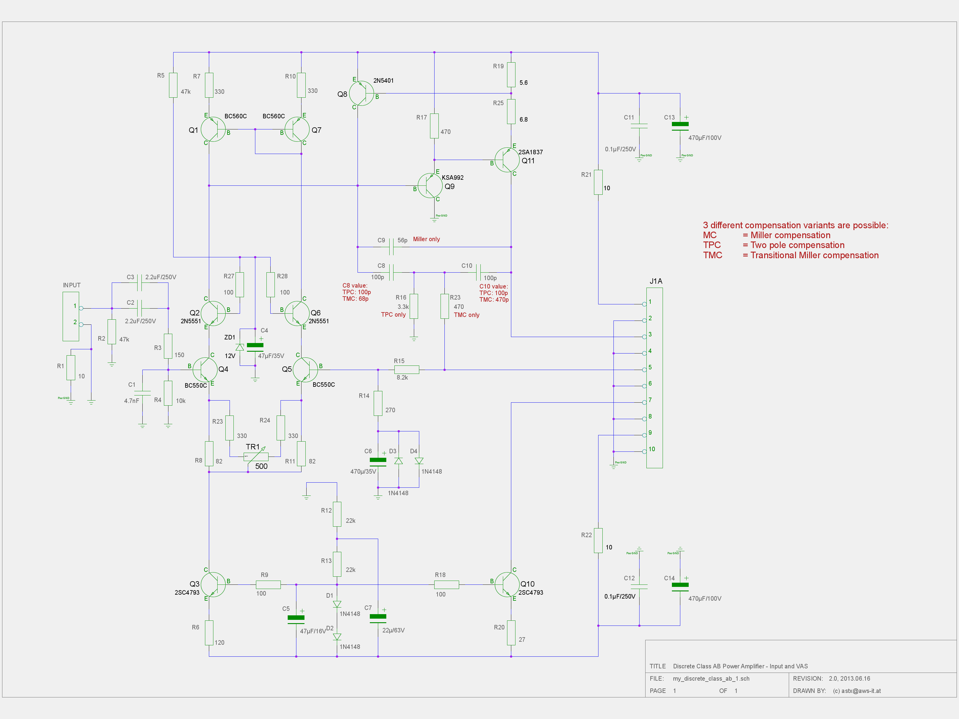

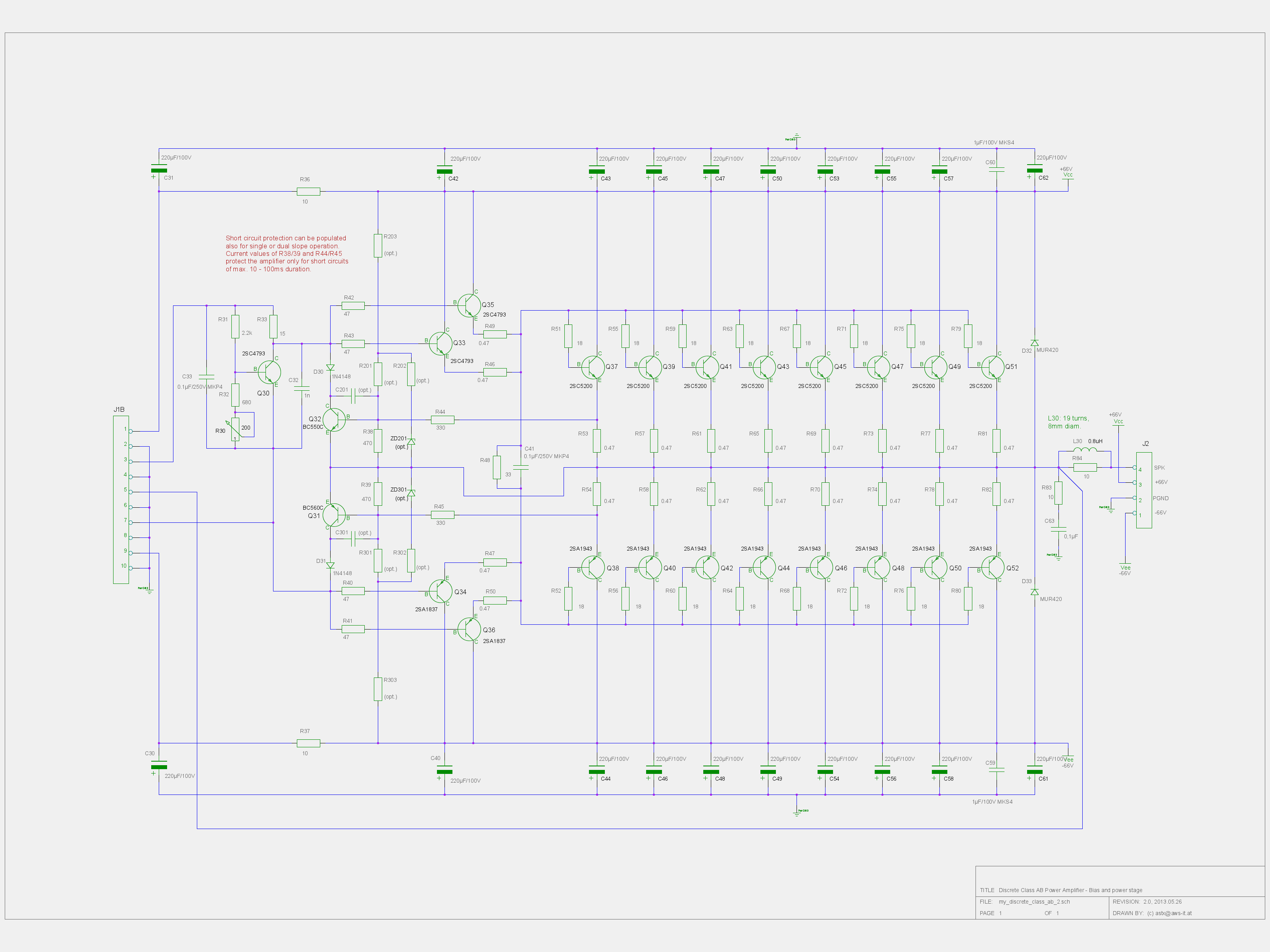

Revision 2.0 RC1 schematics ...
Version updated to revision 2.0-RC1:
Attached updated simulation files and schematics for current release candidate.
BR, Toni
BR, Toni
I get annoyed when a schematic is so large you can't make it out when it's shrunk to screen size but when you expand it you can only view 4 transistors at once.
you are right. Using open source has it's limits too. For this reason I have attached PDF's. I am using "gschem" (from gEDA project) as schematics editor and this program has limited picture output features...
better now?
- 2stageEF high performance class AB power amp / 200W8R / 400W4R
