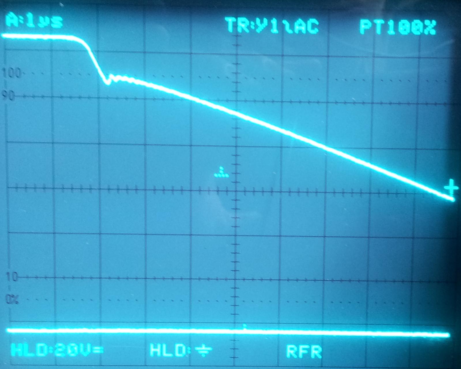

1837/4793_a used in VAS/CCS for this sim There is a small amount of 'blocking' as it comes out of +ve overload but if this was 20kHz, it would be considered 'mild'.
Toni, please confirm this is what the 20kHz overload looks like.
If you have a 1930/5171 version still around, please take some pics of 20kHz overload if you ever fire it up again.

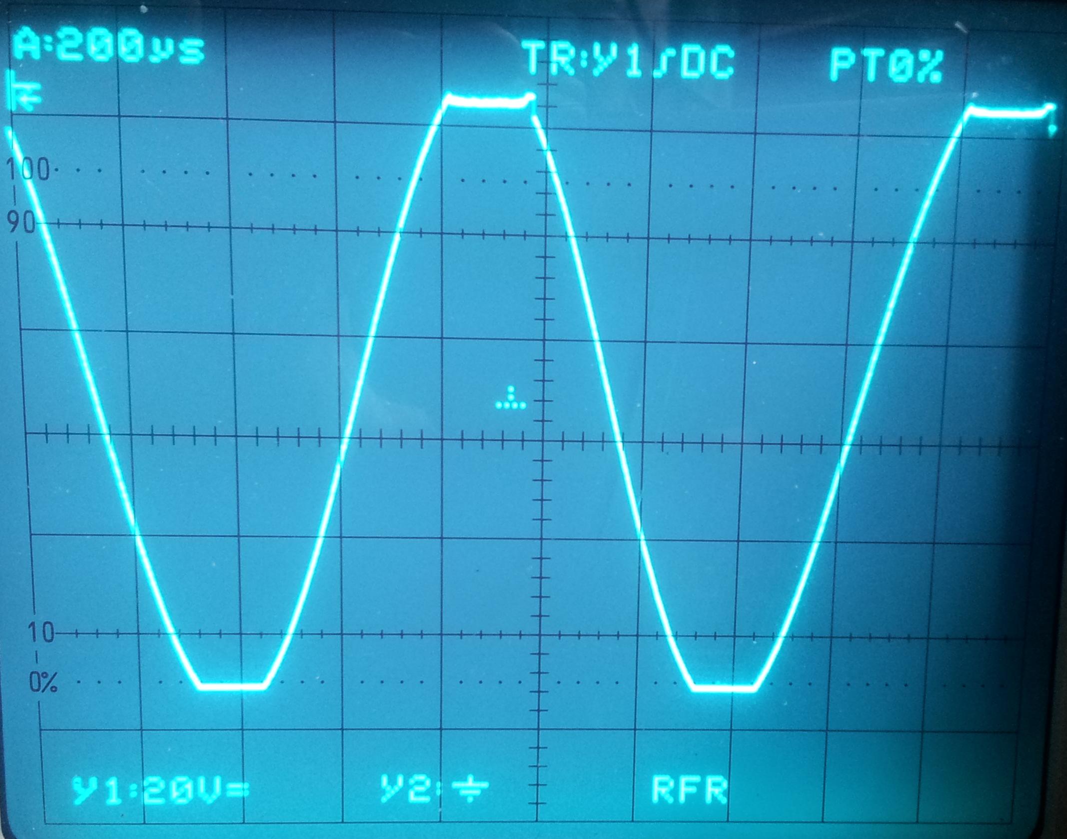

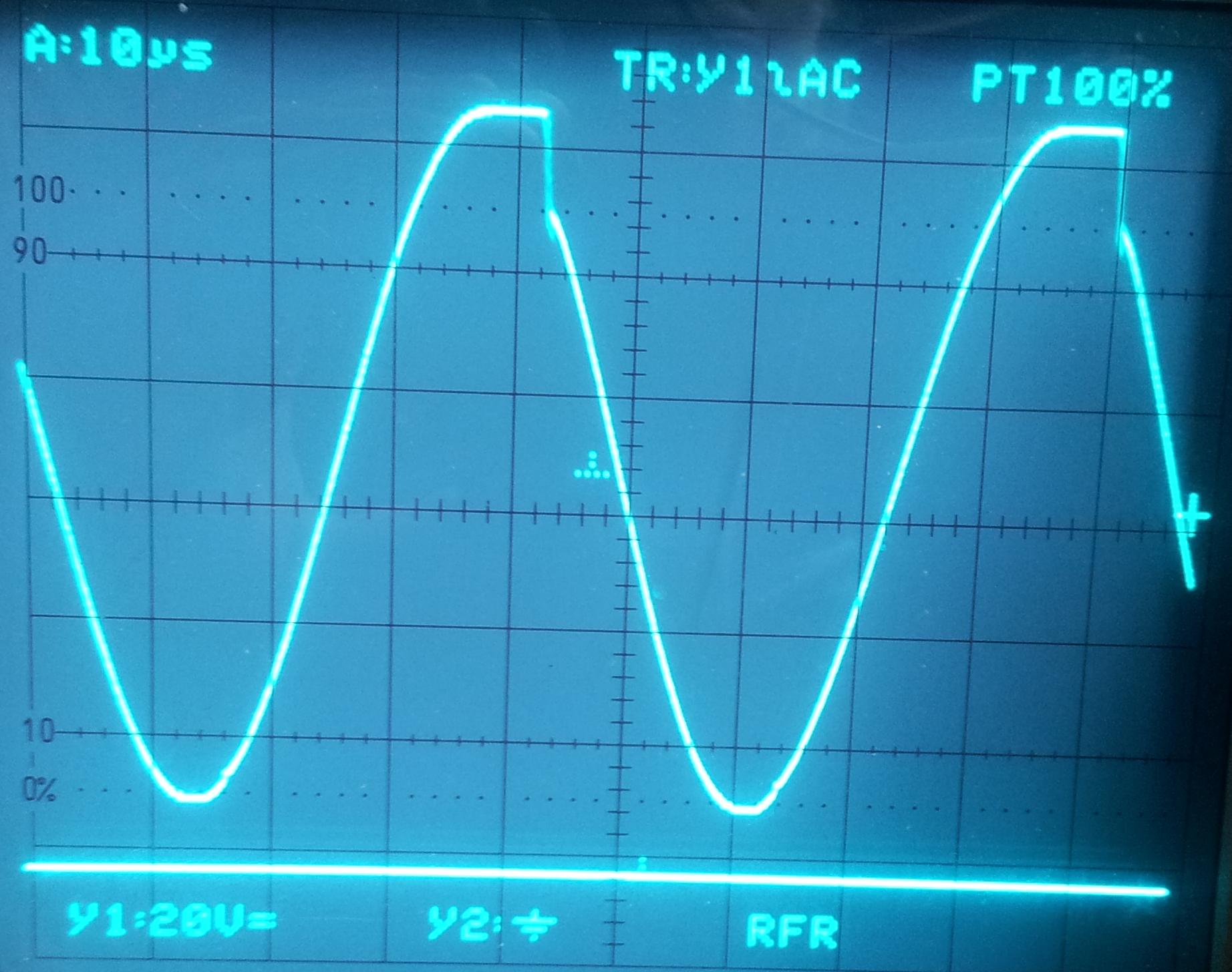

Dear kgrlee,
attached overload screenshots from 1kHz and 20kHz using real life 1837/4793 bjt's.
Real life 1930/5171 will follow soon.
BR, Toni
overload behaviour
Real life VAS 1930/5171 overload looks nearly the same as 1837/4793 overload. It makes not really a viewable difference using
1837/4793 bjt's either in VAS and/or output stage regarding overload behaviour.

Overload Recovery etc
This level of blocking is sorta what I expect to see from an amp like yours.
It means neither AndyC's or Harry Dymond's models accurately sim overload recovery in your amp. AndyC's 1837/4793 show too much blocking and Harry's 1930/5171 show none.
For me, simulating macro behaviour like overload is more important than whether THD is 1ppm or 2ppm. 😱
Damn! 😡
Mr. Dymond, any chance of you tweaking your models to show some blocking with Toni's circuit?
