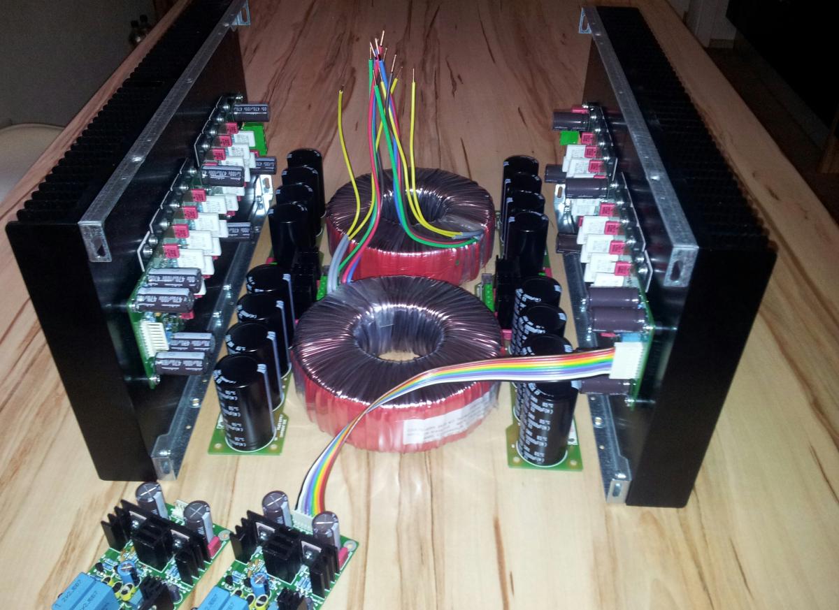

Some more parts for this prototype are finished:
The powersupply pcb's are ready to deliver energy for next tests...
Now we need mains control pcb's including microcontroller which controls
  • mains inrush current
  • DC speaker control
  • muting
  • overtemperature
BR, Toni

Photos look nice. The boards in that orientation will be thermally asymmetric, probably small but have you evaluated this?
Best wishes
David
Dear Dave,
What do you exactly mean by thermally asymmetric? Outputstages have been tested hours under 20kHz@200W@8R in both horizontal positions to check influence on bias thermal drift (which in fact is very low from cold to 50 degree).
BR, Toni
