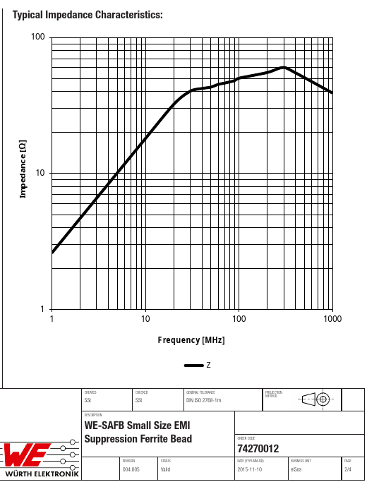

The outer rails are driven by 8 pairs IRFP240/9240. To hold the gate resistance low I plan to add ferrite beads and like to ask you if you have experience using ferrite beads like the attached one.
BR, Toni

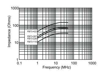

My problem with ferrites is they are often not resistive enough for what I want. However I have fixed this by just using them as small inductors, paralleled by resistors.
Years ago I bought some Bourns FB-73 series ferrite beads, which according to the datasheet appear to be nicely resistive above 10MHz with reasonably high inductance. They went obsolete and it is hard to find similar beads. Here is something similar with DC bias info:
https://www.mouser.com/datasheet/2/150/2773019447-346321.pdf
For an audio amp I think you are looking for high inductance and low resistance (like in the attached FB-73 chart), but most beads are intended for RF or SMPS use.

thx for reply. Your part is similar but needs to be soldered. I plan to use a gate resistor of 47R AND a through hole ferrite bead in series. Ferrite bead directly mounted at gate pin. This adds 30 - 60 ohm extra Z above 20MHz where the VMOS devices are prone to oscillation.
Gate DC current is very low so hopefully there is no Z reduction due to DC saturation.
Using IRFP240/9240 the gate resistor is usually kept higher as 100R to avoid oscillation. Bob Cordell has used 47R gate resistors and a zobel network from gate to ground using 39p in series with a 100R resistor.
(page 11 in http://www.cordellaudio.com/papers/MOSFET_Power_Amp.pdf)
I hope I can avoid this extra zobel if the ferrite bead works as desired.
Maybe Bob could add a comment?
EDIT: on page 12 of his PDF Bob talks about using a 10R gate resistor and ferrite bead and well shielded gate to driver connections instead of the zobel network.
BR, Toni

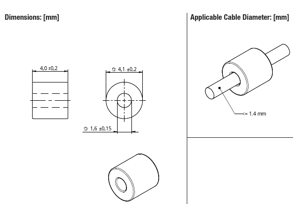

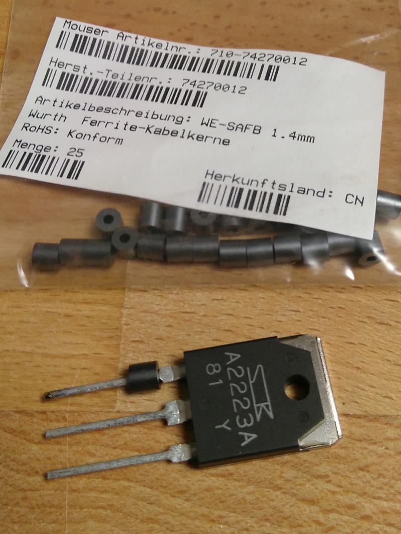

... yesterday got the ferrite beads for testing. Also the (high current, low reverse current) power schottky for lower rail voltage.
The ferrite bead fits well on a power transistor leg (only for upper rail MOSFETs; used a BJT just to test the through hole size).
BR, Toni

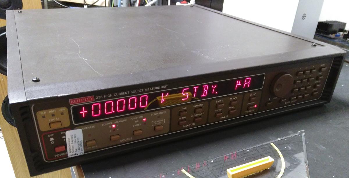

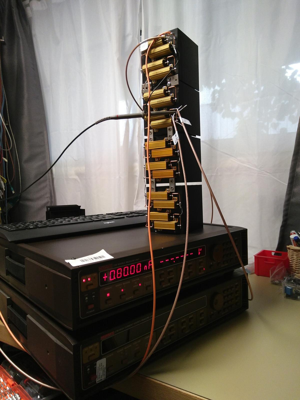

New test equipment - a keithley 238 SMU
... had the chance to get a used but in good condition SMU unit from Keithley model 238 ...
The triax ports and cables are a nightmare when you look at the prices ...
Need to manufacture DIY measurement cables ...
The first Linux 4.2.x GPIB tests where successful. Can read the version, set and read parameters and values ...
Combined with a relay board to switch between 10 devices it should be easy and funny to build a highest quality transistor matcher ... or curve tracer. The instrument can measure and deliver +/-110V or a current from fA to a maximum of 1A.
BR, Toni

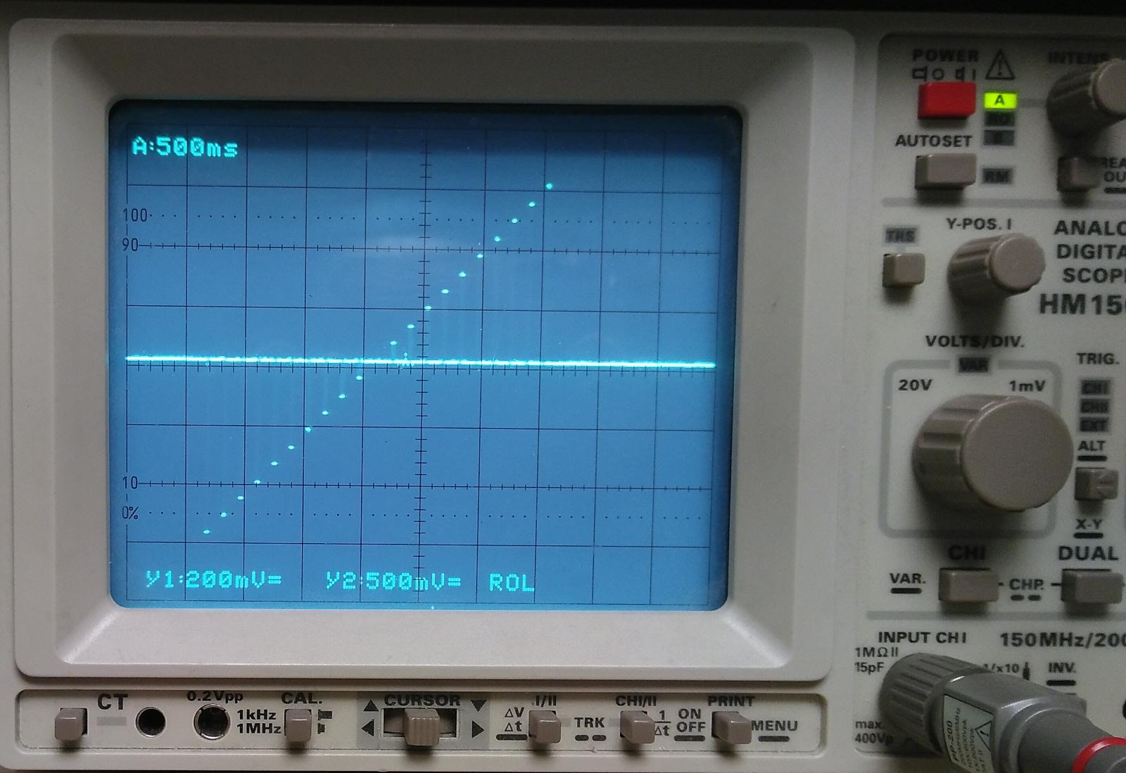

New test equipment - a keithley 236 and 238 SMU
BR, Toni

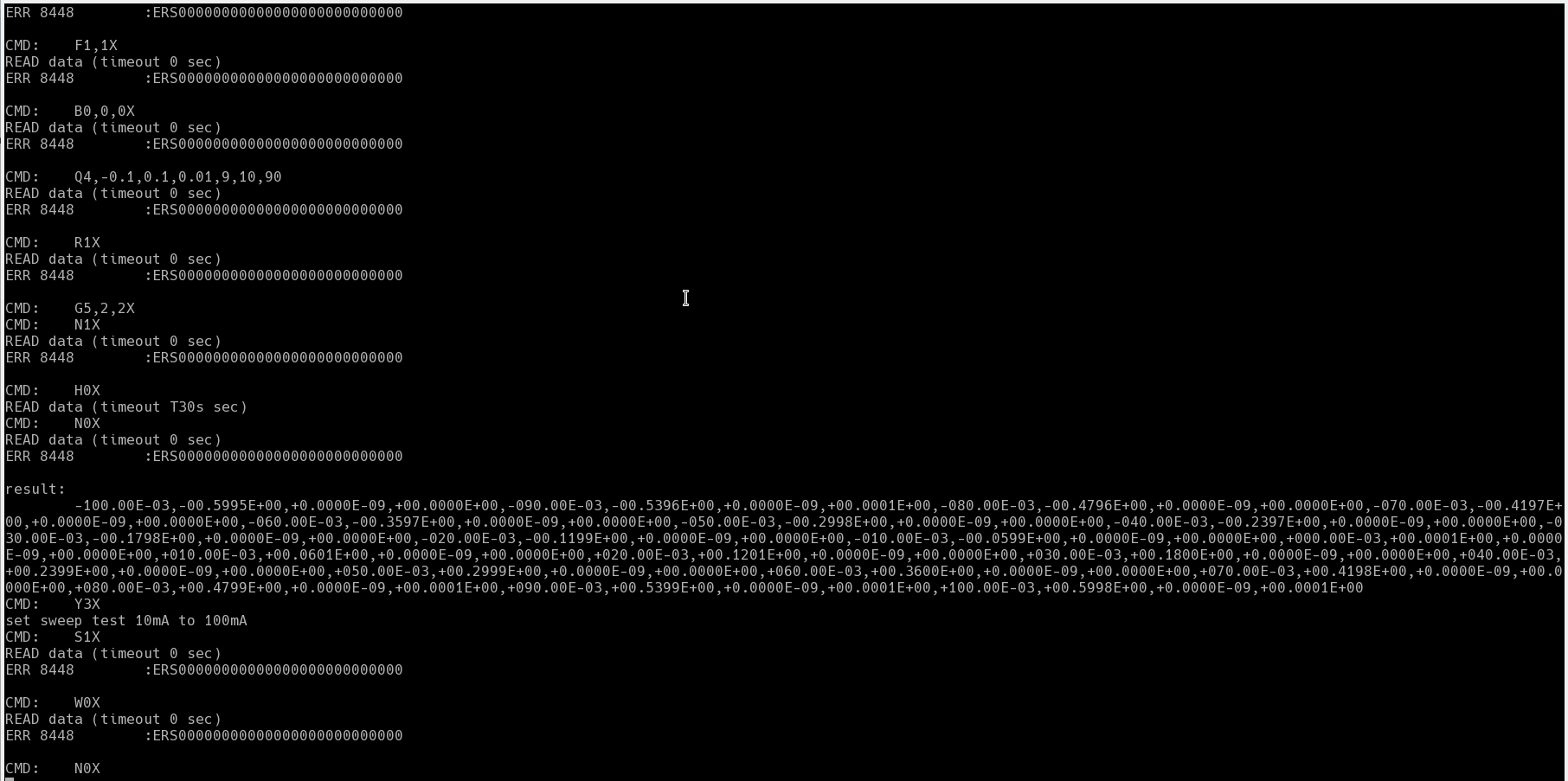

- had some time to create 6 Triax cables - that was a nightmare ...
- had time to program a simple LinuxGpib perl script for testing linear sweep.
BR, Toni

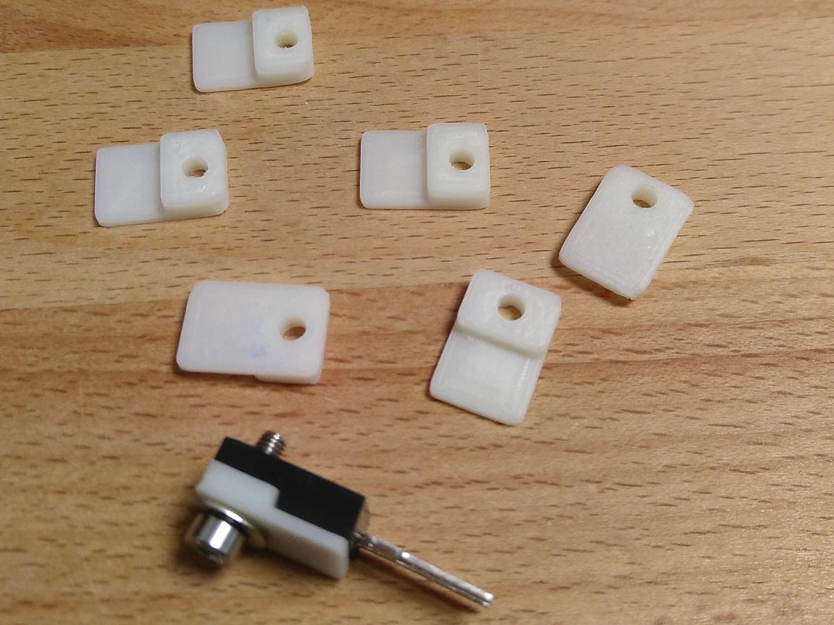

TOSHIBA TO200 mounting helper
Here a 3D STL file if you want to 3D print yourself this Toshiba TO220 mounting helpers.
You can adapt the STL in changing the dxf files and using the openSCAD script.
BR, Toni
BR, Toni
