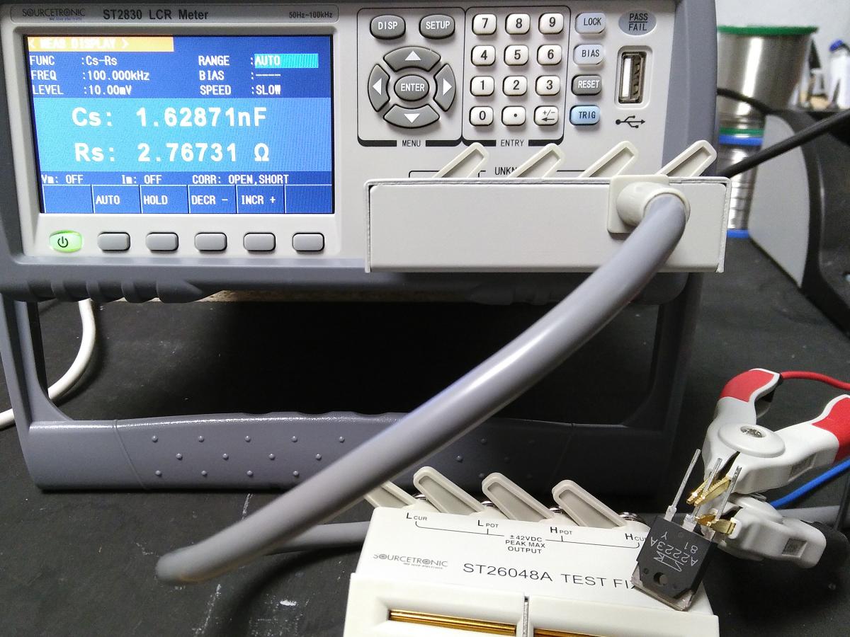

... a Cbc measurement of Sanken 2SA2223AY using 10mV/100kHz test signal. (Cjc space charge capacitance at vBC=0V)

Quicktested the 2SA2223A: below 25kHz the display of the series R is wonky. Above 25k it stays nearly same ...
BR, Toni

... a Cbc measurement of Sanken 2SA2223AY using 10mV/100kHz test signal. (Cjc space charge capacitance at vBC=0V)[/QUOTE]
Hi Astx 🙂,
I did check your values on my bridge, and here are the successive values as I did get them that I did find at 5mV and 100kHz :
933.33 pF and 58.9 Ohm Avg 10 times 2SC6145AY
1.6478 nF and 23.1 Ohm Avg 10 times 2SA2223AY
933.95 pF and 58.5 Ohm Avg 10 times 2SC6145AY
1.6493 nF and 23.1 Ohm Avg 10 times 2SA2223AY
I have found that the Rs value dipends on the V of the measurement : at 10 mV I find lower Rs values : around 32 Ohm and 15 Ohm.

Dear rephil,
my LCRZ measurements Cs-Rs results are relatively independent from test signal 10mV up to 190mV (where the bjt diode starts conducting a bit) e.g. for the 2SA2223AY Rs is about 3R at 10mV and slighly reduces a few percent up to 190mV test signal.
From 25kHz up to 100kHz the values are also stable within a few percent.
Maybe your LCR isn't able to go as low as needed. Your measured Rs values are more as 10 - 20 times higher as my results.
My new LCRZ regulates the output impedance automatically from 3 Ohm to 30 kOhm and works even if you apply an external bias voltage.
Take some small capacitors and increase the test signal level from 10mV up to 2 Vrms.
E.g. use a Wima 10nF MKP10 630V. The Rs should stay same at same test frequency (100kHz) during test voltage sweep. I measure 0.11R
BR, Toni

Hi Toni 🙂,
I have bad news (for me) : I did check at first my LCR before doing the test you are suggesting : it is a GWinstek LCR model 819. So, I have seen after recalling the calibration factory set up that at first the internal battery should be changed 😡. With the reloaded factory settings, I did repeat the measurement I did do with the same transistors. Now the Rs is mostly 6 Ohm and 4 Ohm at 10mV, 5mV and both at 100kHz. I apologize with you for the values I did provide here. The internal battery will be changed, and I wil let perform a calibration of the instrument by authorized people (after 10 more years, it should be done 😉). I have now to find out who could do that in Belgium for me, people being able to perform that well !
Please nobody should consider the measurement values I did provide, these have been done with a very good LCR meter that is today in need of help ... Sorry 😱 for that.

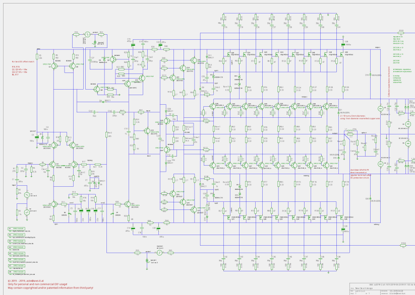

SA2019 - Going green - New Class H
I'm currently planning a new monster green amp (SA2019) with those specs:
+/- 85V rails, +/- 20V rails
450W@8R,900W@4R,1600W@2R
Idle power dissipation ~ 20W
The outer rails are driven by 8 pairs IRFP240/9240. To hold the gate resistance low I plan to add ferrite beads and like to ask you if you have experience using ferrite beads like the attached one.
BR, Toni

THx - can be needed!
Anybody has experience using ferrite beads - see 4 post ago:
BR, Toni
I don't think these beads act as reactances, i.e. increase the leads' inductances. This wouldn't suppress oscillations, but solely decrease their frequencies, and possibly lead to further instabilities imho.
The ferrite these beads are made of deliberately is a very lossy one. Hence possible resonant circuits are damped due to the losses. For this reason these beads were very common with tube technology, and I've also seen them yet in SS circuits. The pic, for example, shows the PSU/power amplifier of an old DUAL KA 60 console. Note the beads at the base leads of both left handed transistors.
So I think you might just try it. What could happen?
Best regards!
