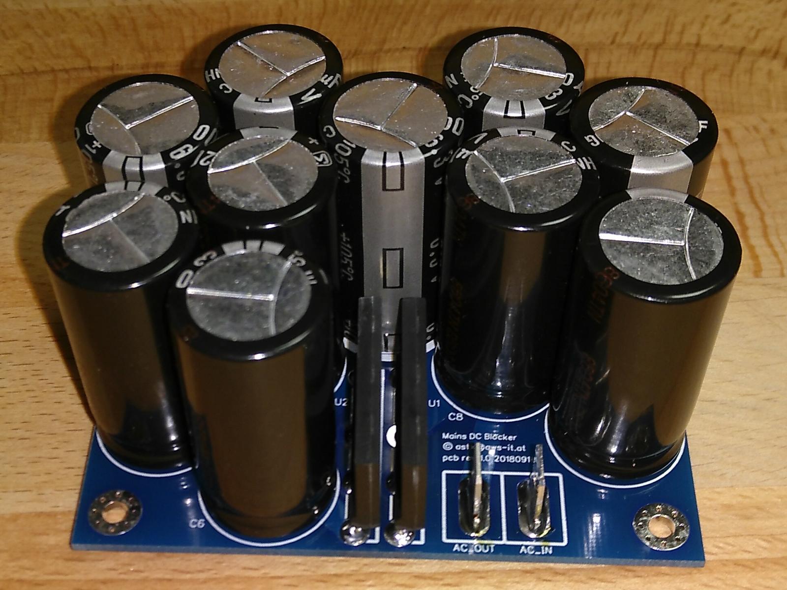

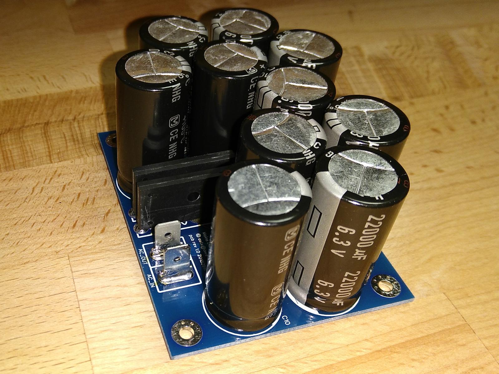

AC mains DC Blocker
... got pcbs ...
BR, Toni

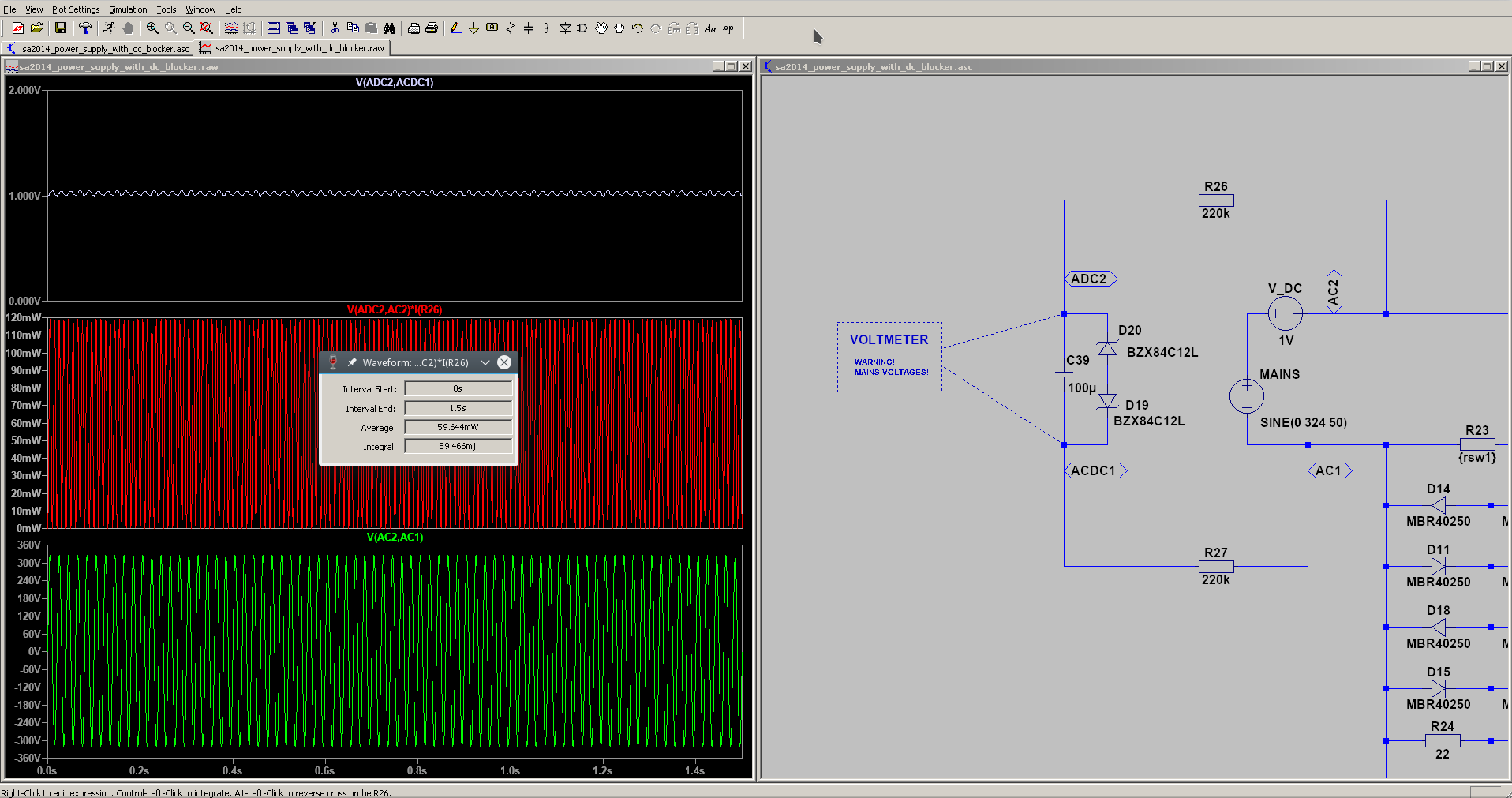

AC mains DC Blocker
... using a 50/60Hz filter ...
WARNING: very dangerous to measure! DO NOT DO IT unless you know what you are doing!
You not always have DC on mains. It depends on the devices that are currently consuming power.
BR, Toni

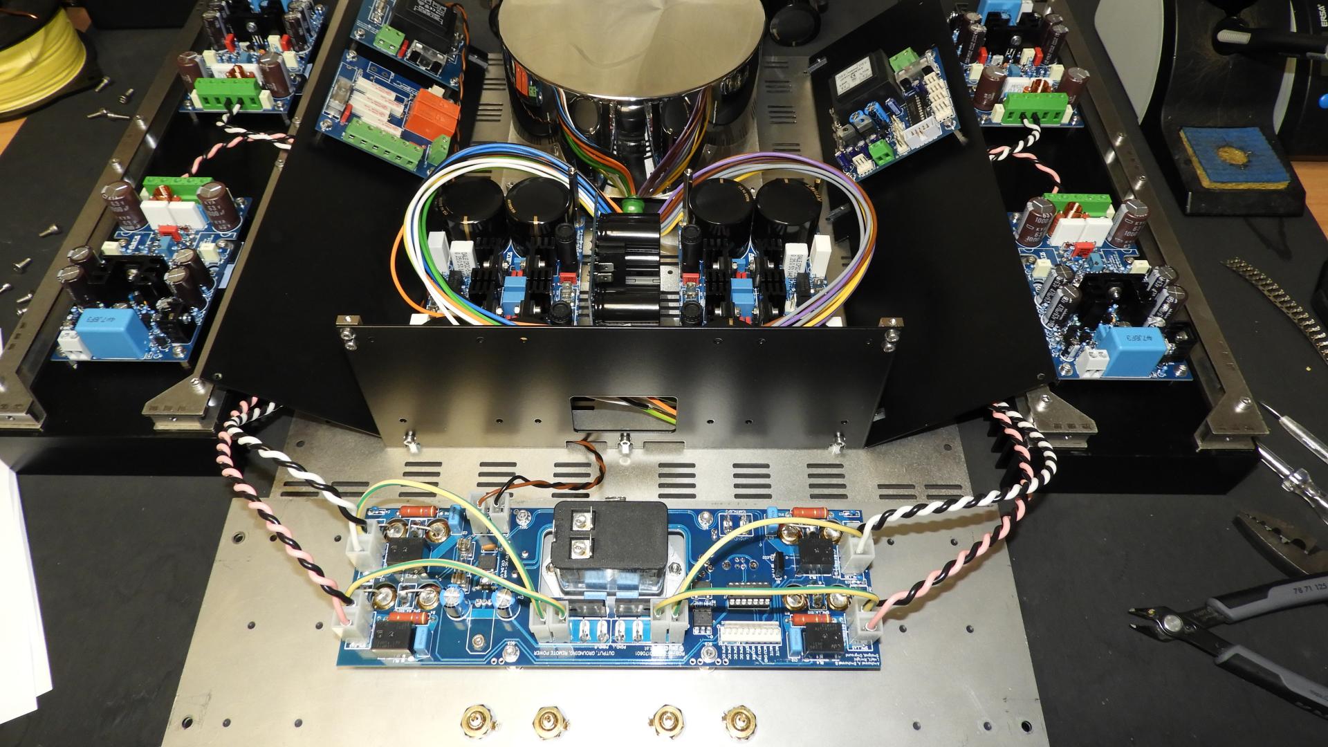

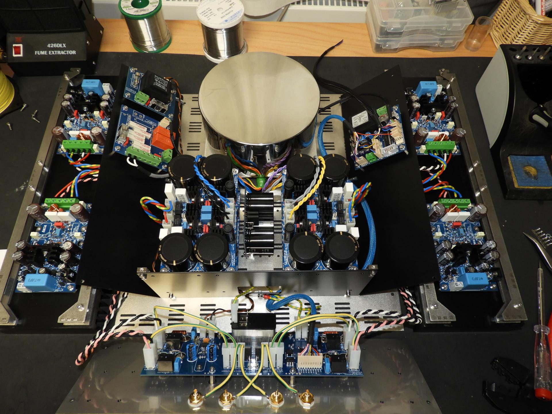

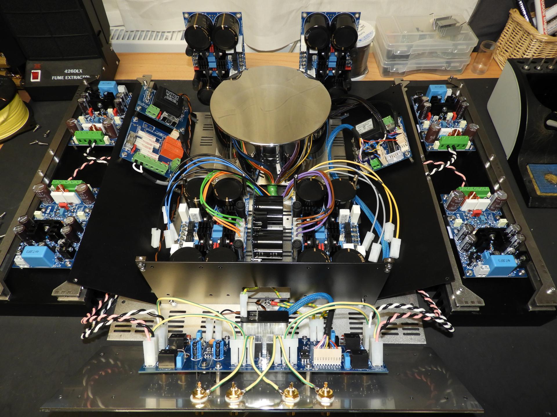

ASTX LABS - SA2017 VMOS IXYS
... mostly finished ...
just need to do
  • RCA cables
  • power switch/leds soldering
  • temperature sensors
  • AC 230V cables
BR, Toni
