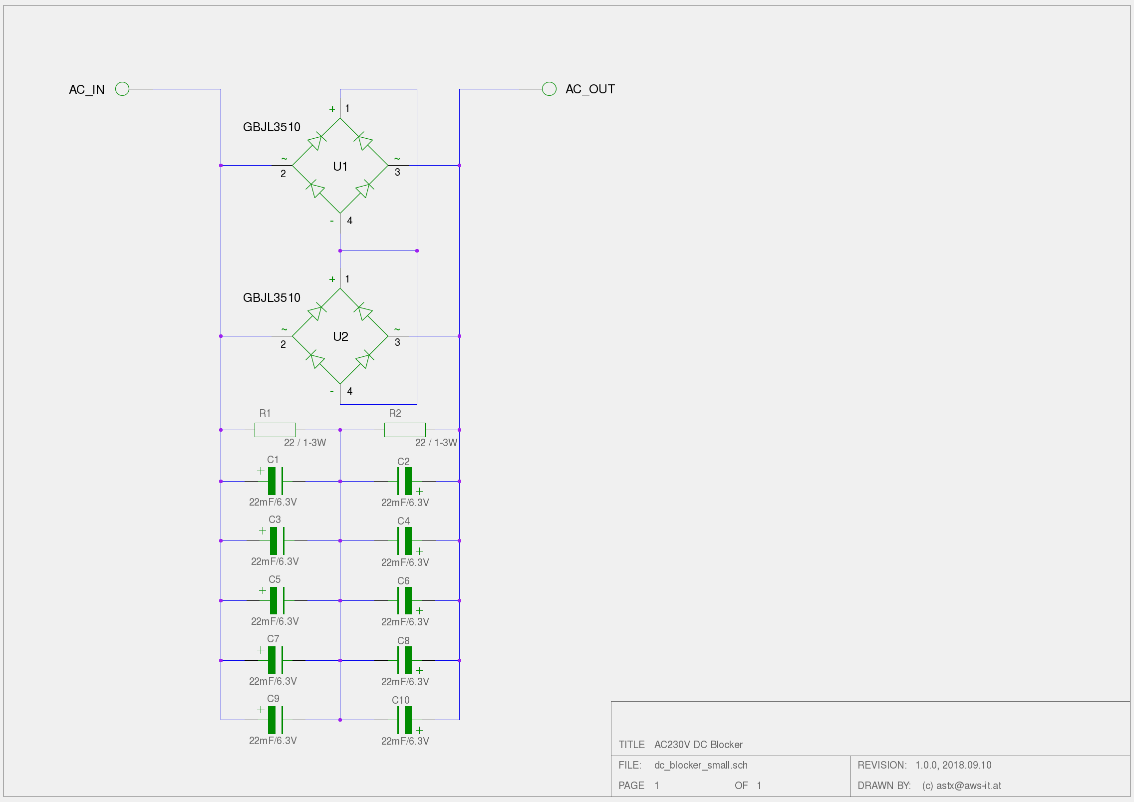

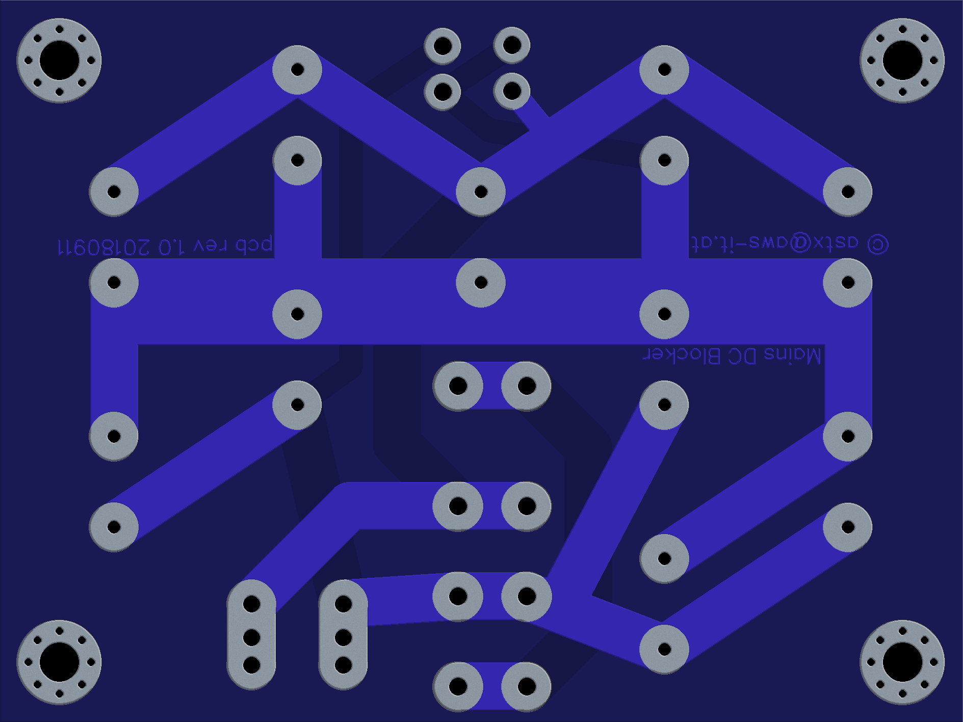

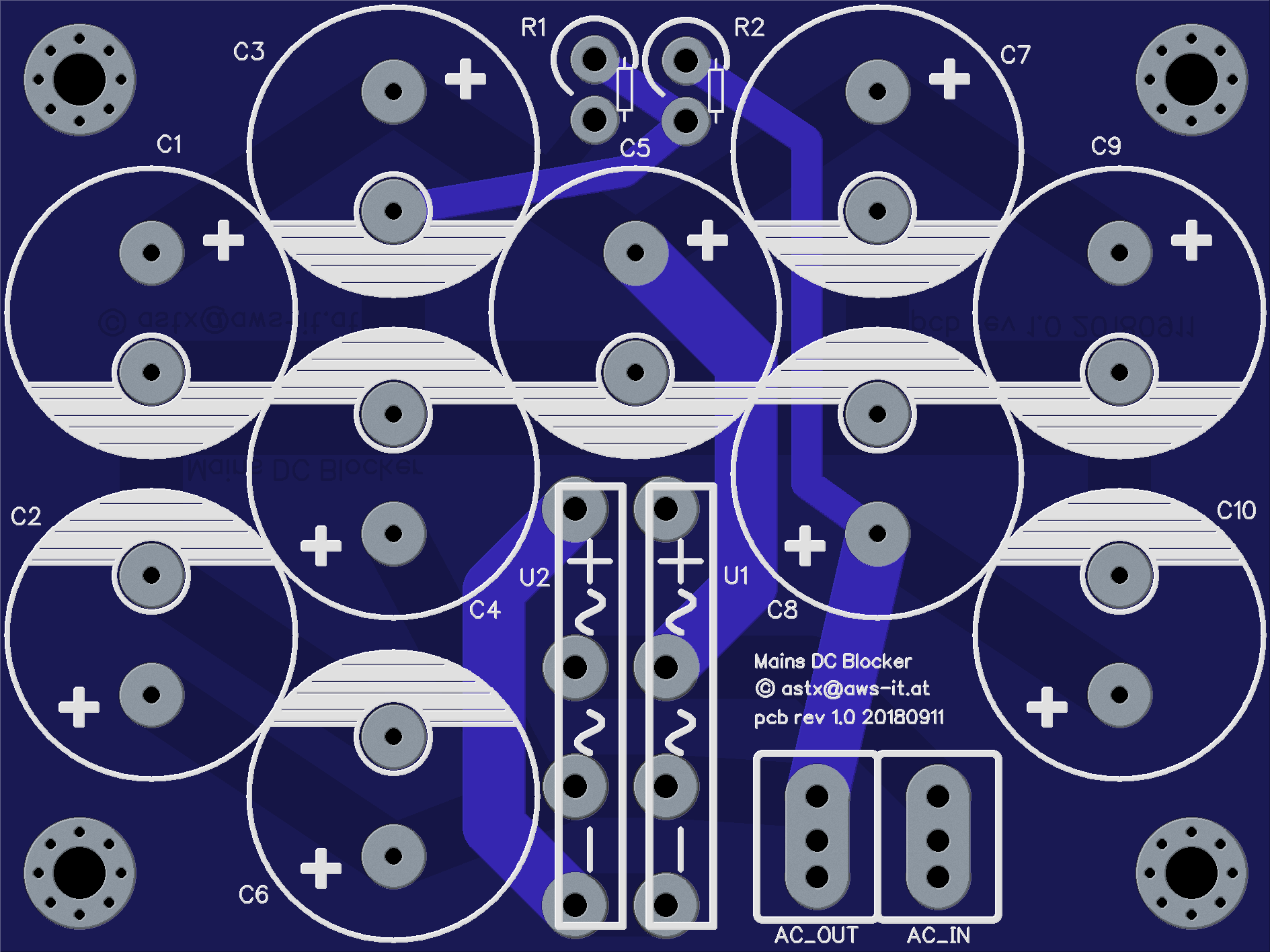

AC mains DC Blocker
attached schematics and gerber files.
Feel free to use for non commercial DIY projects.
WARNING: this circuit carries AC mains voltage and is therefore very dangerous and can be lethal. I am not responsible for any costs, damage and/or injury using these schematics. Do not use this schematics if you do not have the necessary experience and knowledge!
BR, Toni

2 diodes in series and antiparallel give a DC blocking voltage of ~ 1,4V.
As you know the AC mains sometimes carry a small amount of DC voltage which move your transformers working point out of the optimal zone and make the transformer physically hum. Especially if the transformer is a toroid with high output power which has a low input resistance on primary side. Typically all 300VA and bigger transformers are affected.
The lytics are acting like very low resistance for the 50/60Hz AC voltage so the AC voltage itself will not be reduced.
BR, Toni
BR, Toni
You mean, all DC voltage below 1.4V is blocked by diodes, AC voltage goes thru caps and above 1.4V thru diodes. Right?
I would not trust it. If it burns in an electrical device, then there.
Burn with 70A diodes which withstand easily 700A peak? Even with dry lytics there is nothing to get hot enough to burn...
I have already seen power switch, they were completely melted (small power devices). Don't ask me why. I couldn't explain that either.

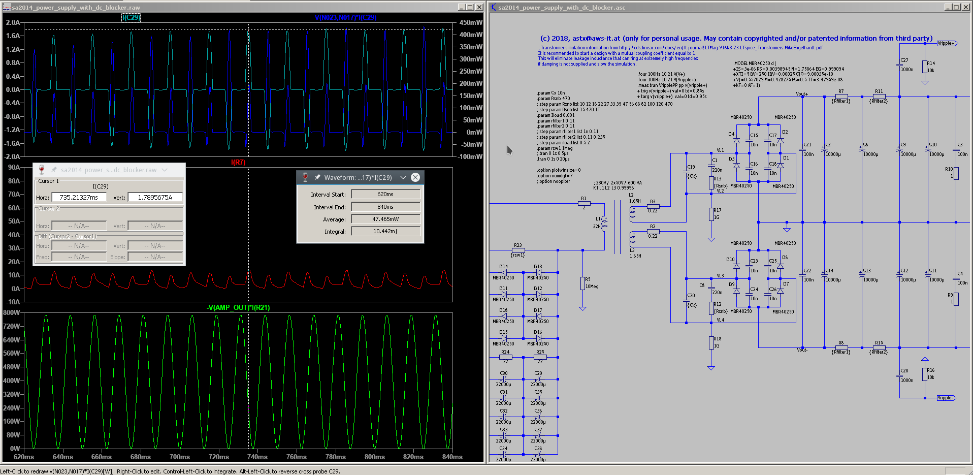

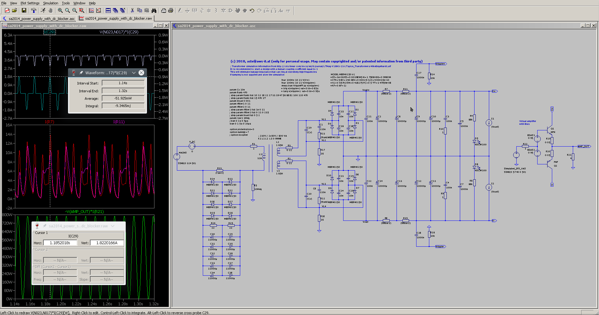

Here the simulation of the new sa2014 power supply with dc_blocker_small included.
Simulation shows the power supply load of the amplifier providing 400W@4R. The power dissipation in the individual lytics are very small during heavy load: 47mW. Ripple current well between spec.
BR, Toni
BR, Toni
R1,2,3 are the toroids DC resistance and R5 is needed for simulator only. Ltspice doesn't like floting grounds.
