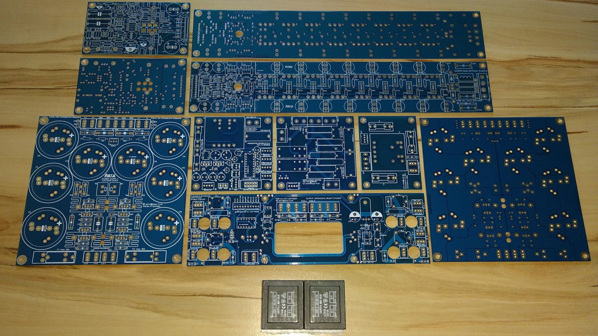

A giant amplifier!A complete pcb set for a SA2014 dual mono build...

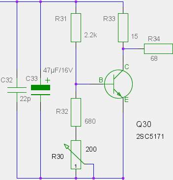

Hi Toni, first I want to say you have made a very nice and well engineered amplifier!
I have a question I haven't yet found any answer to, in the attached picture is a section of the Vbe multiplier of your amplifier, I wonder what is the function of R33, why don't we connect R34 to the upper side of R33?
A V-be is running with constant current source. Current change doesn't matter that much. Changing the rails from e.g. 60V to 50V changes the bias voltage +-4.4mV (with darlington configuration by +-1.8mV). Nevertheless I would not prefer the darlington config because you get then thermal issues.
Many thx! It is more or less also a community result based on the blameless amplifier from D. Self.Hi Toni, first I want to say you have made a very nice and well engineered amplifier!...
R33 makes the bias circuit more independent from bias current changes. (BTW: you are using the old schematics of SA2014; see index in post #1 for the latest SA2014 schematic)... I wonder what is the function of R33, why don't we connect R34 to the upper side of R33?

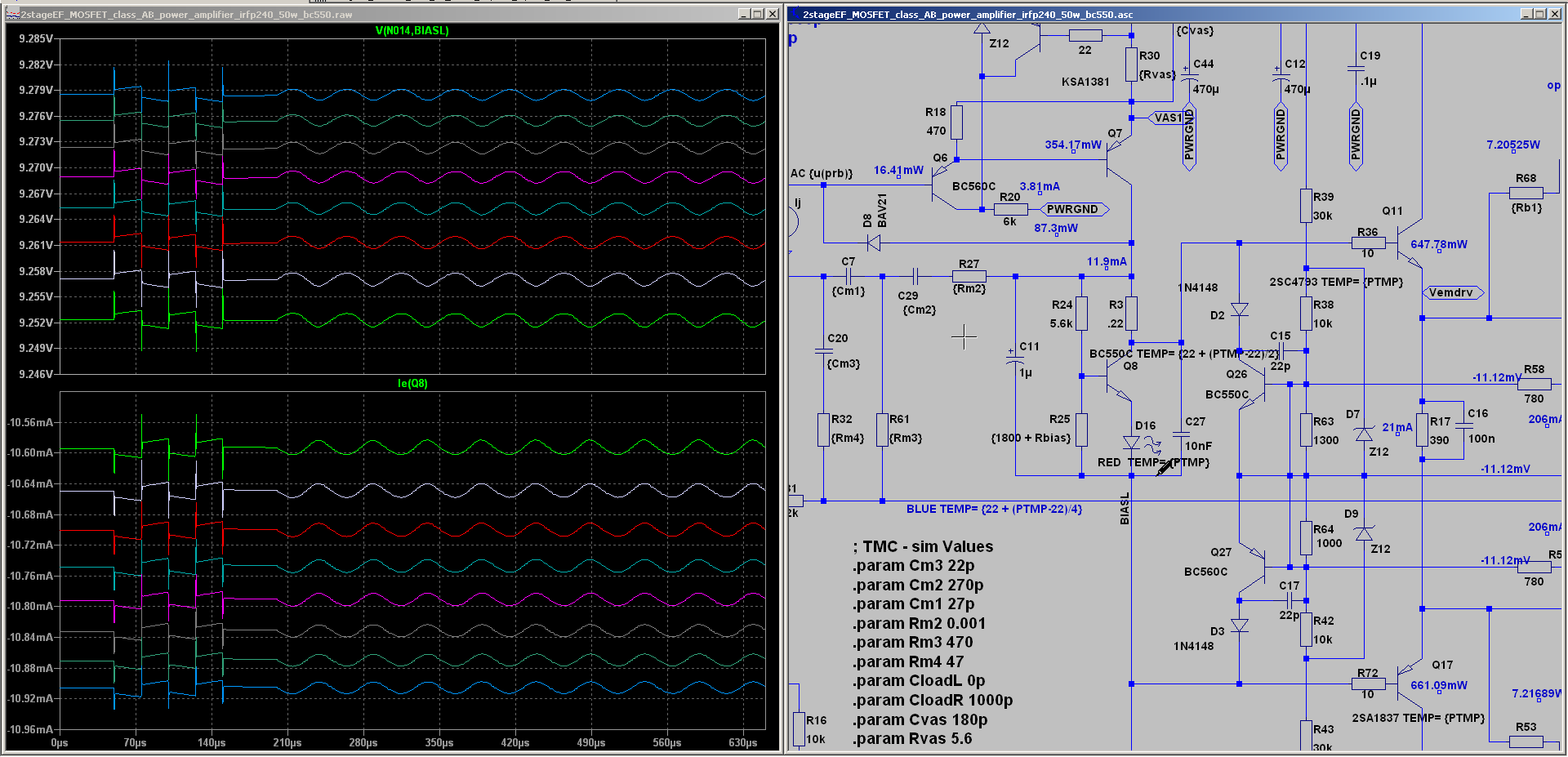

We have small bias current changes, because the constant current reference voltage source isn't fed with constant current. VAS constant current changes when rail voltages changes happen. Rail voltages are also dependent on AC voltage which is never constant over the day/hour/minute/second.

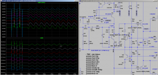

Attached 2 pictures to show the difference of BIAS voltage. With 22R bias resistor we have 20mV difference if we step the rail voltage from 35V to 56V and 27mV difference using 0.22R bias resistor.
Not much difference - only one of many details which makes the amp a bit more stable.

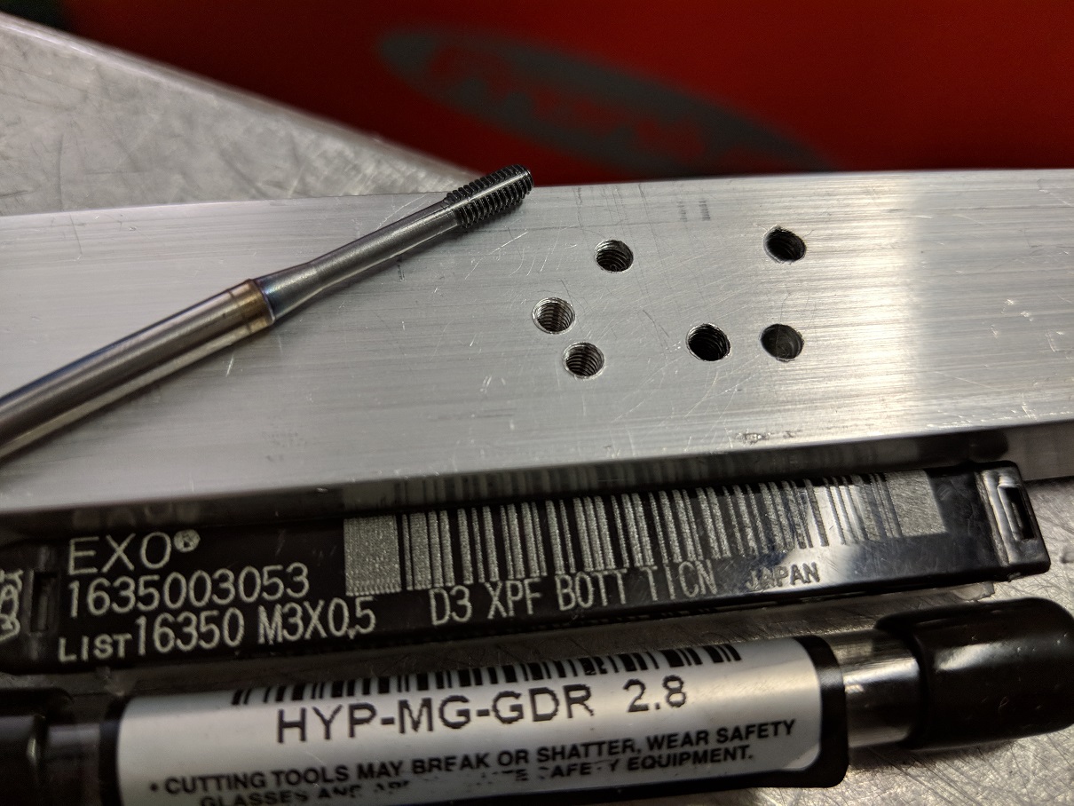

A test with M3 blind + through hole would be a big help.
Tested the M3 form tap in a piece of 10mm thick 6061 flat bar.
Set the speed to max and the clutch to min. Tapping went well, with the tap bottoming in the hole and the clutch slipping without tool breakage. Backed out full speed no problems. 10mm through hole no problem either. For lubricant I used "Tap Magic" but I'd say any lubricant would be fine.
The first few holes were drilled freehand, the last 2 (on the left) were done in a drill press. As you can see, the ones using the drill press gave a much better result. Due to the fact that the drill size is only .2mm smaller than the tap, any amount of wondering with the drill leaves you with no material to form the thread.
Bottom line: As long as you use a drill press for the holes and have an adjustable clutch, the form tap is very successful using a cordless drill.

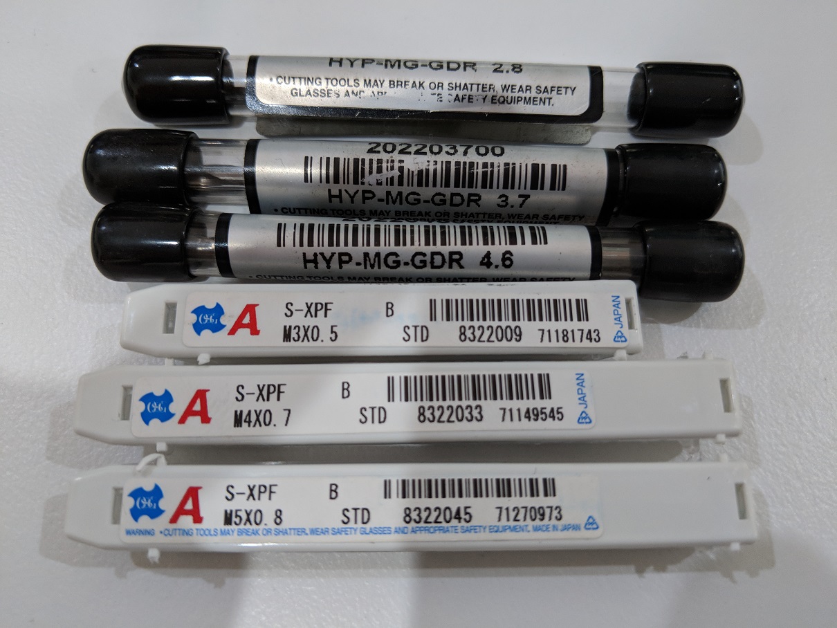

I'm sending a "Care Package" to Toni with M3,4,5 taps and suitable drills.
