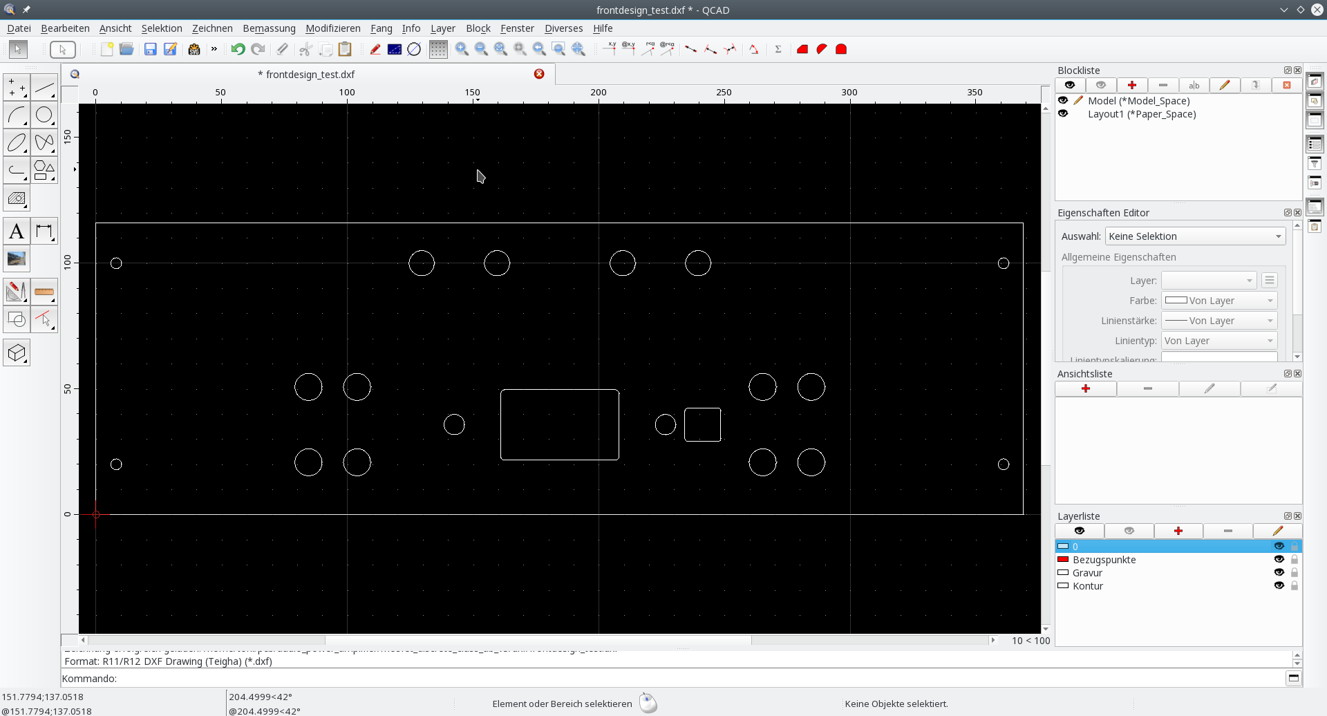

Could briefly explain how cutworks works; I mean I guess I have to create a design with a CAD program. What are the next steps; how do I get a quote and order panels?
On this side of the world laser cutting becomes more cost effective when you are getting a complete 4' x 8' sheet of metal done. We pay more for the operator to load the machine, and less for the laser to cut. That might be the case there too.
Most prefer CAD drawings. Laser just requires 2D drawings.

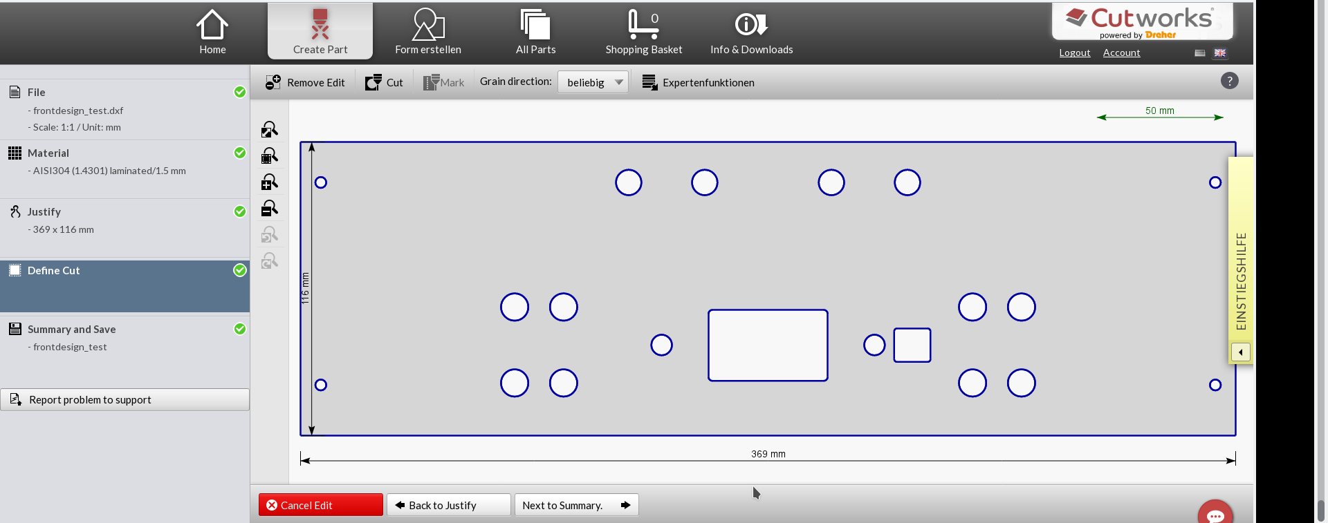

- create your part with a cad program to generate a dxf file. QCAD, LibreCAD or similar.
- login to the shop and upload your dxf file using "create part" and follow the wizard to "next step choose material"
- chose steel, stainless steel or aluminium
- button "next to justify"
- button "next to define cut"
- button "next to summary"
- select number of copies and button "save and goto ..."
BR, Toni

Schaeffer's Front Panel Designer is able to export DXF files. Have you ever tried using that to order panels at Cutworks? Do you think it would work?

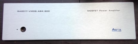

Diy near enough to hi end commercial products.🙂... today got ...
- CNC-machined and -engraved frontpanel by schaeffer-ag.de ...
- panel material is from modu.it
