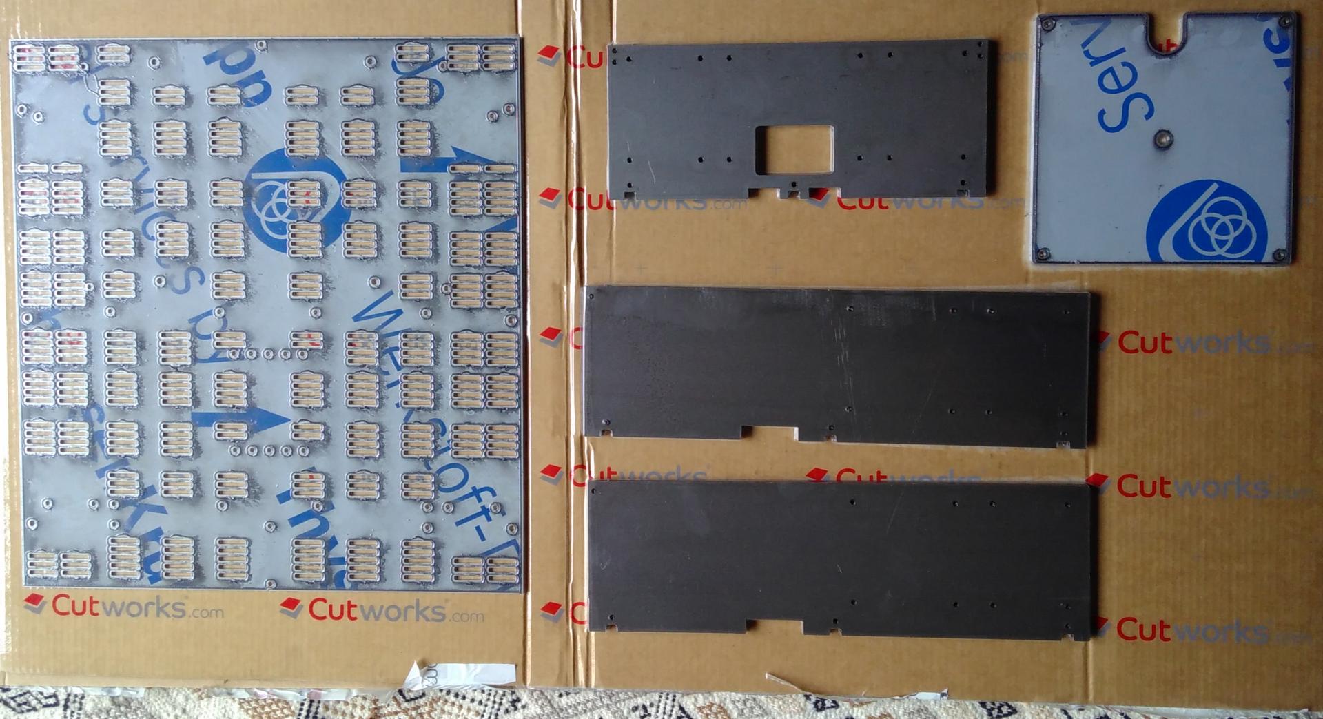

3mm alu isn't really more expensive. A few Euros extra I think. Printing is cheap. Think in sum below 100 EUR incl. shipping.
Beautiful. Sexy. A work of art. I have a hardware hardon.

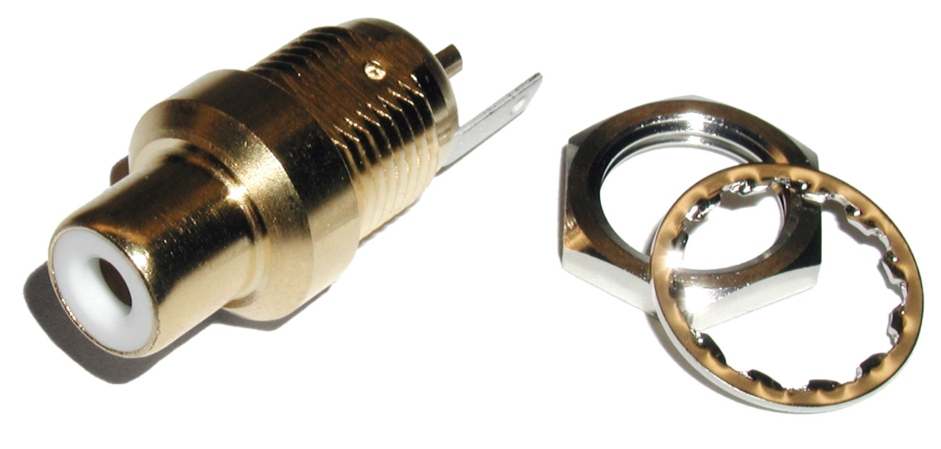

Are the threaded portions of your connectors perfectly circular or do they have flattened areas? It is usually too much work in DIY to make the holes with flats to match, but your lasered panel maker should be able to do it without charging extra. Something to consider for your next batch.
http://www.markertek.com/productImage/HI-RES/RJ-RWE.JPG
How do you ensure that there are no visible tool marks when you tighten the connectors?

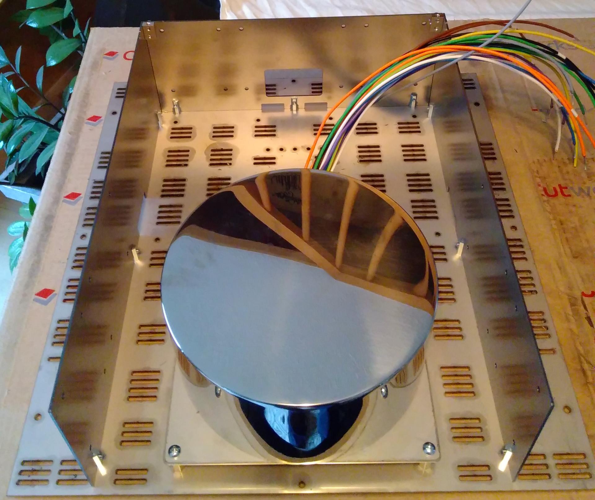

In compact designs there always seems to be a tradeoff between compactness and serviceability. Quite often one has to do a lot of dismantling and reassembly to replace a faulty component. How much attention have you paid to this aspect of your design?

No flattened areas and fully isolated from chassis.Are the threaded portions of your connectors perfectly circular or do they have flattened areas?
Careful mounting using high quality tools.How do you ensure that there are no visible tool marks when you tighten the connectors?
Maximum - to this new design.In compact designs there always seems to be a tradeoff between compactness and serviceability....

Edit: what height is the enclosure? How many u?
You are welcome!
Overall size is about 3U.
Heatsinks and case is exactly 120mm in height.
Frontpanel 130mm high.
Transformer totally oversized. 800VA and 8 x 35V secondaries.
