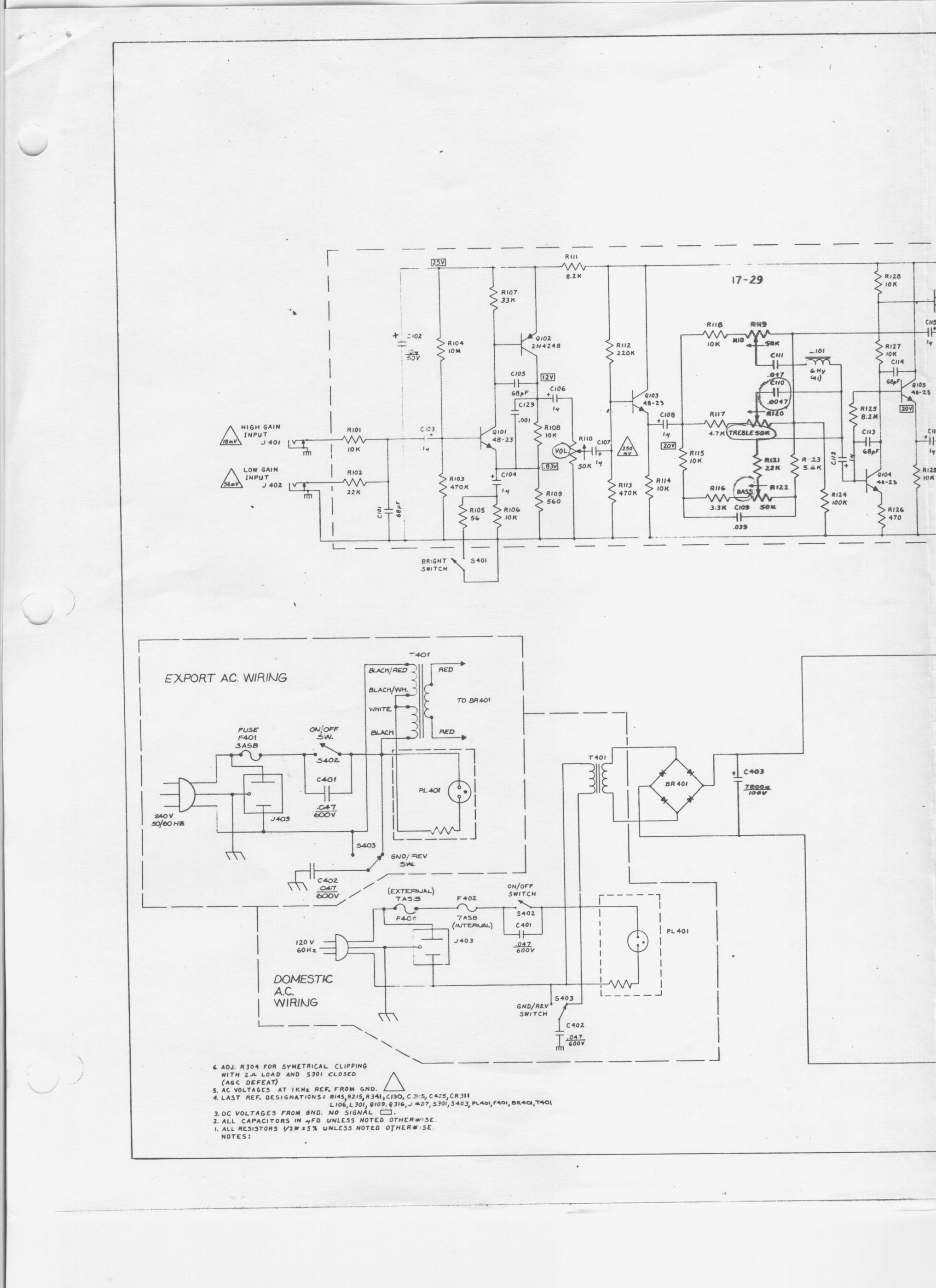

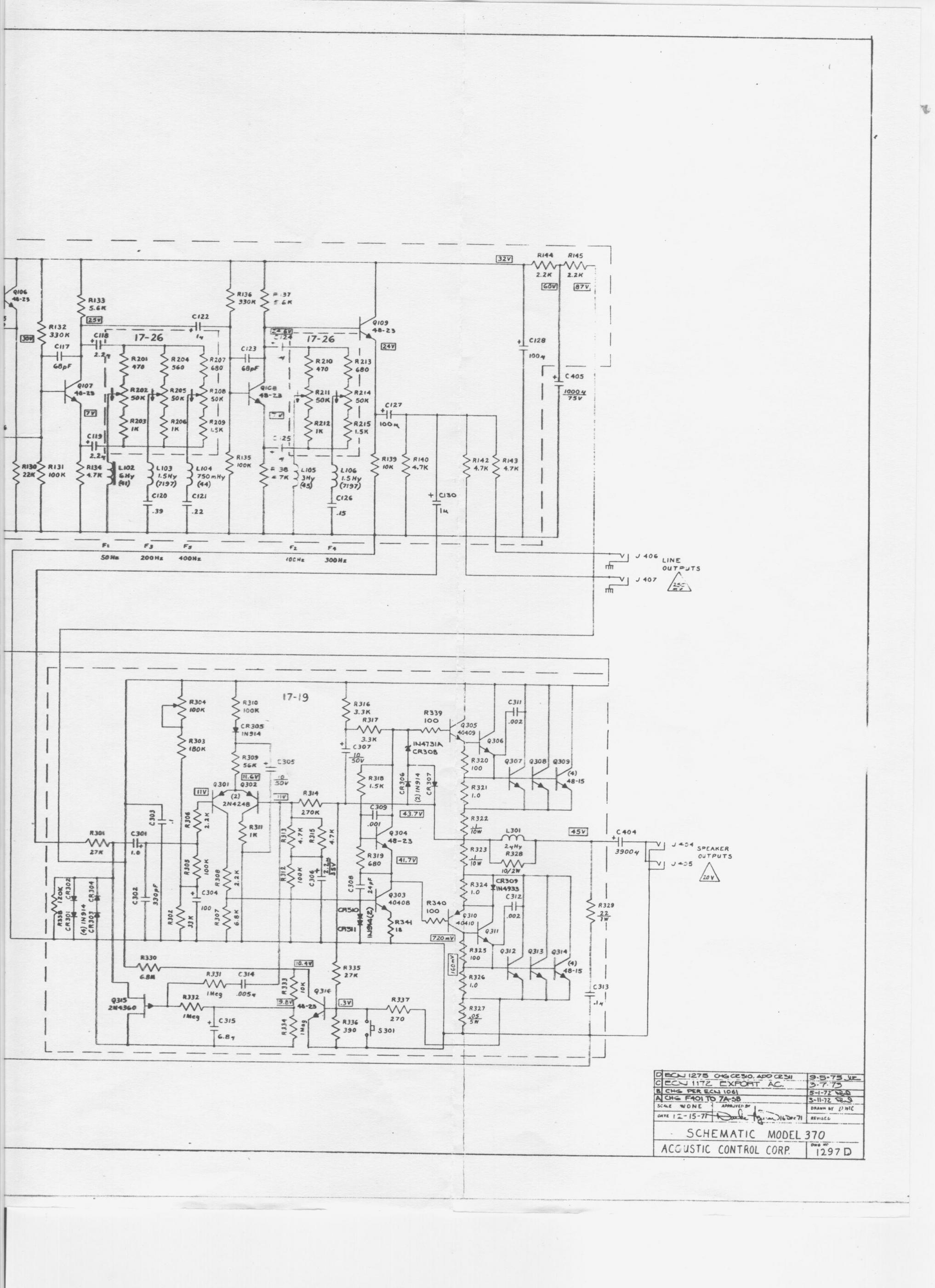

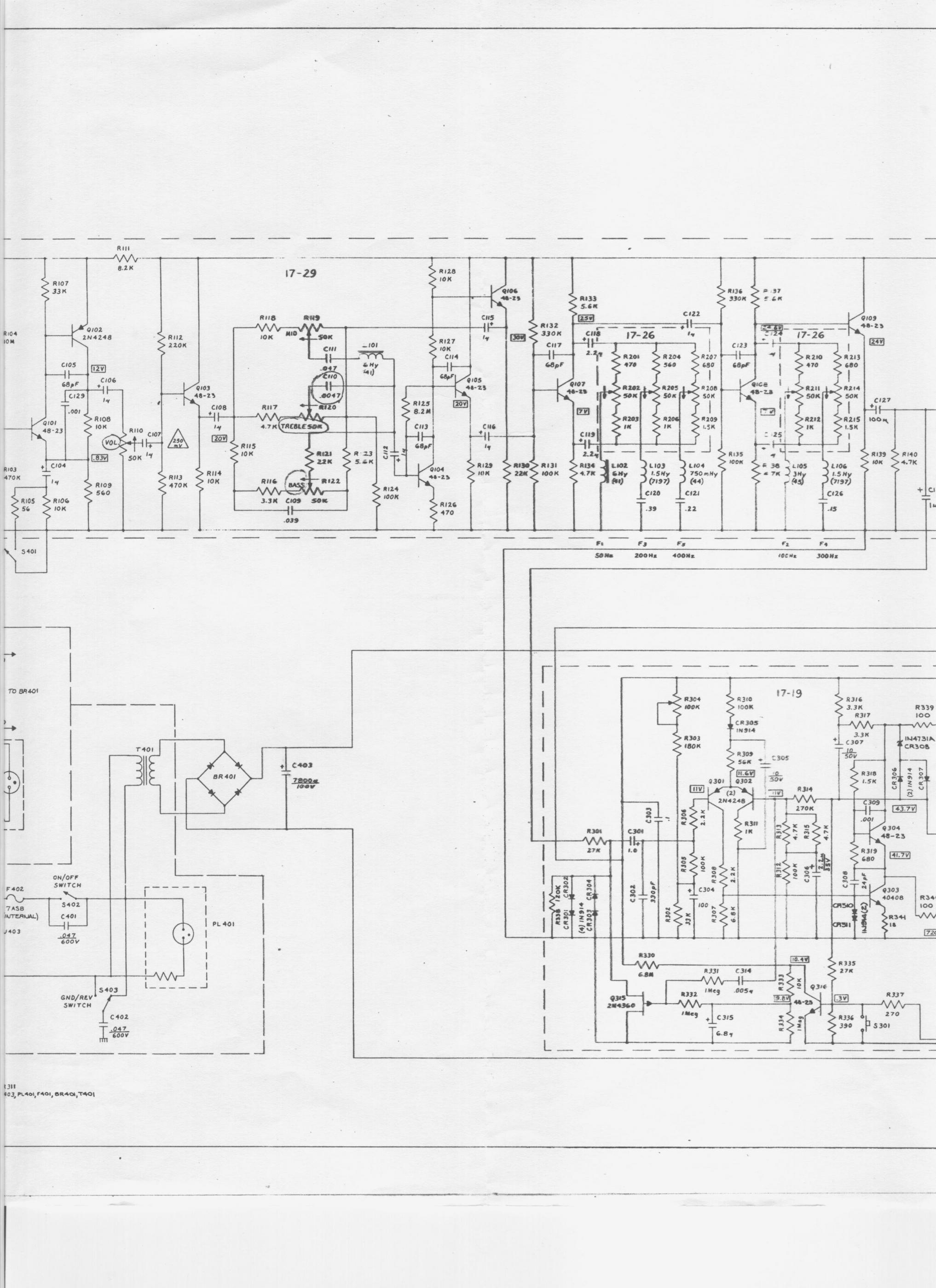

In the attachments schematic jpg's with higher resolution.
as to the Acoustic 370 problems, i never did get that beast working. i tried 3 times rebuilding it from input to output, replacing all the silicon and burnt resistors. i'd bring it up slow on a variac, and as soon as i got to 60V BZZZT!!!!! up in smoke it went.... i later found other techs had the exact same experience with 370's and wouldn't touch them. 20 years later i have offered to rebuild my friend's amp again, this time using a different design amp circuit. (fully complementary with MJL4281/4302 outputs)
By this output buffer topology and the kind of parallel operating mode without emitter resistors (and only 1 ohms for the second buffer stage transistor), for me it is a miracle which great reliability with the original components was achieved. By repair I remove the first stage of the buffer (darlingron is enough) and switched parallel only three darlingtons (resp. sziklai darlingtons in the lower half).

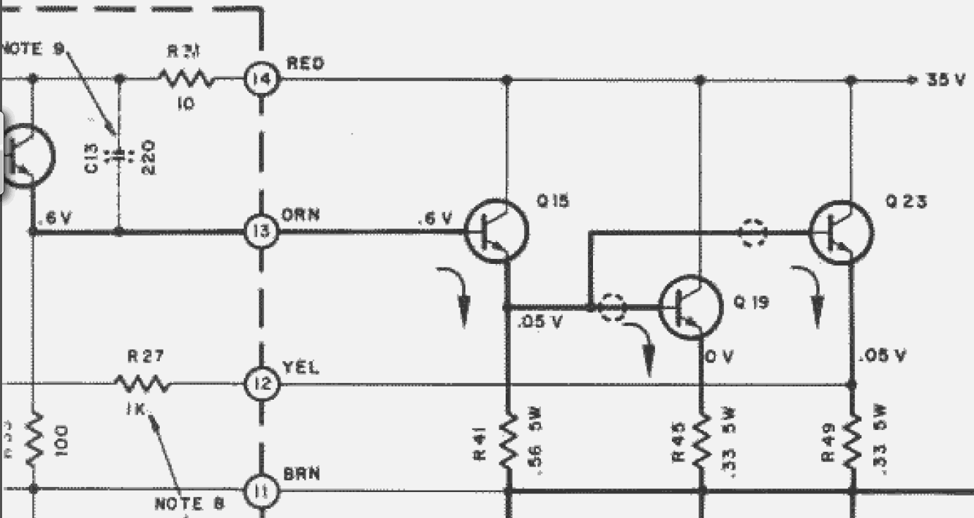

another thing i'm thinking here is that with non-factory selected devices, the miller capacitance is different, and the repaired amp is oscillating for the few milliseconds it takes for the amp to self destruct. since this IS a bass amp, maybe starting with a 1nf cap across C308, (overcompensated is better than undercompensated) and experimentally working down from there might stabilize the amp for the newer devices. current limiting the supply to the drivers and output devices with resistors may also be wise on the first power-up (as well as using a dim-bulb limiter after the variac, which i didn't know about 20yrs ago).... just a few thoughts.....
At first, I found the MC2100's choice of emitter resistors confusing.
It seemed to me a deliberate unbalance at max current. And it is!
But not so much as might seem, if the outboard pair are droopy,
and that droop starts about 3A (sound familiar?).
It seems they are all matched to the same collector current at the
point of greatest challenge to SOAR. The halfway point of voltage
and current. Not at max current as I had first assumed. But droop
might be required to maintain current balance beyond halfway.
The inboard transistor will not exceed 3.75A + drive.
The outboard transistors will not exceed 4.2A apiece.
A Darlington watching the last emitter cuts off bias if it trys.
I calculate 35V-5Edrops=31.5 into 2 ohm tap =15.5Amps,
but the emitter watcher will cut us off at 12.6A, assuming
all three are still in balance.
I don't see any particular reason (beyond VCE) 2n3055 shouldn't
work here? If the outboard pair droop a bit, it only helps collector
balance. But I see no advantage for the first of this trio to droop,
only makes the small transistors on the driver board work harder.
So maybe one modern non-droopy type, and a matched pair of
good old 2n3055 on the cheap... If we can prove they are 80V.
The one with the insulator is probably the last quasi, as it has
0R33 in the collector to watch current there (don't go looking,
its slightly below where my image crops) . I've seen videos of
MC2100 repair misidentify that transistor as the driver...
