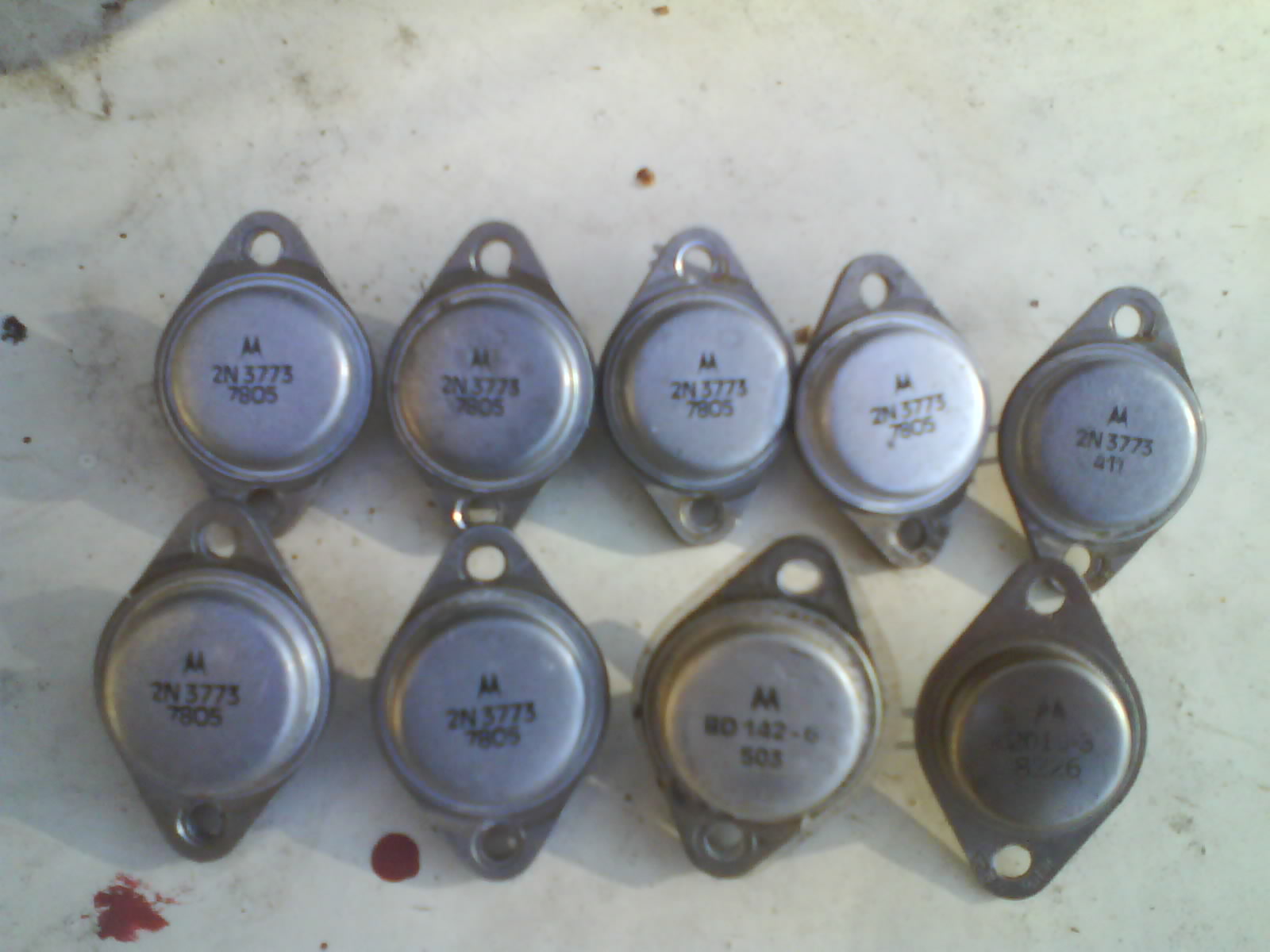

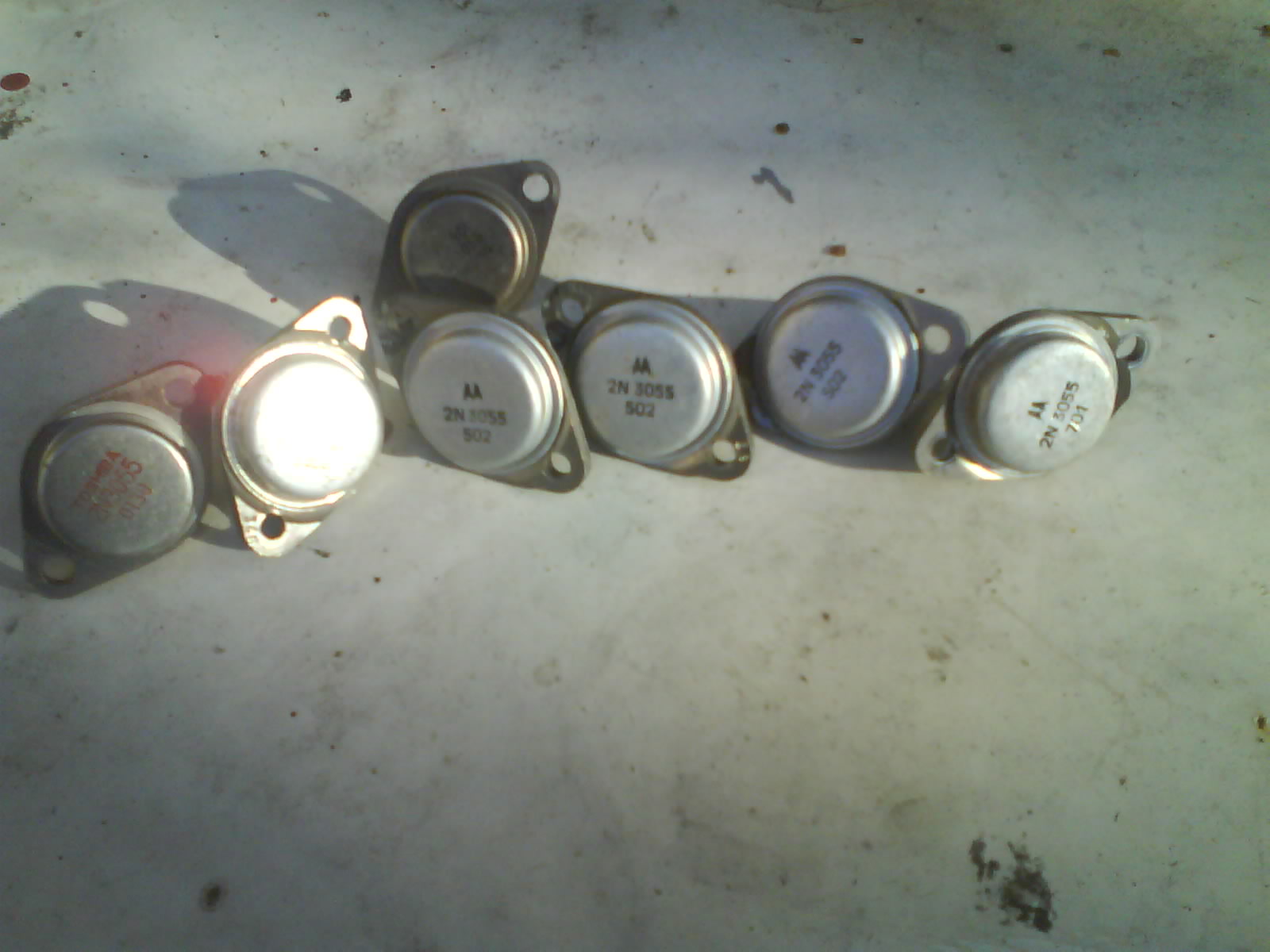

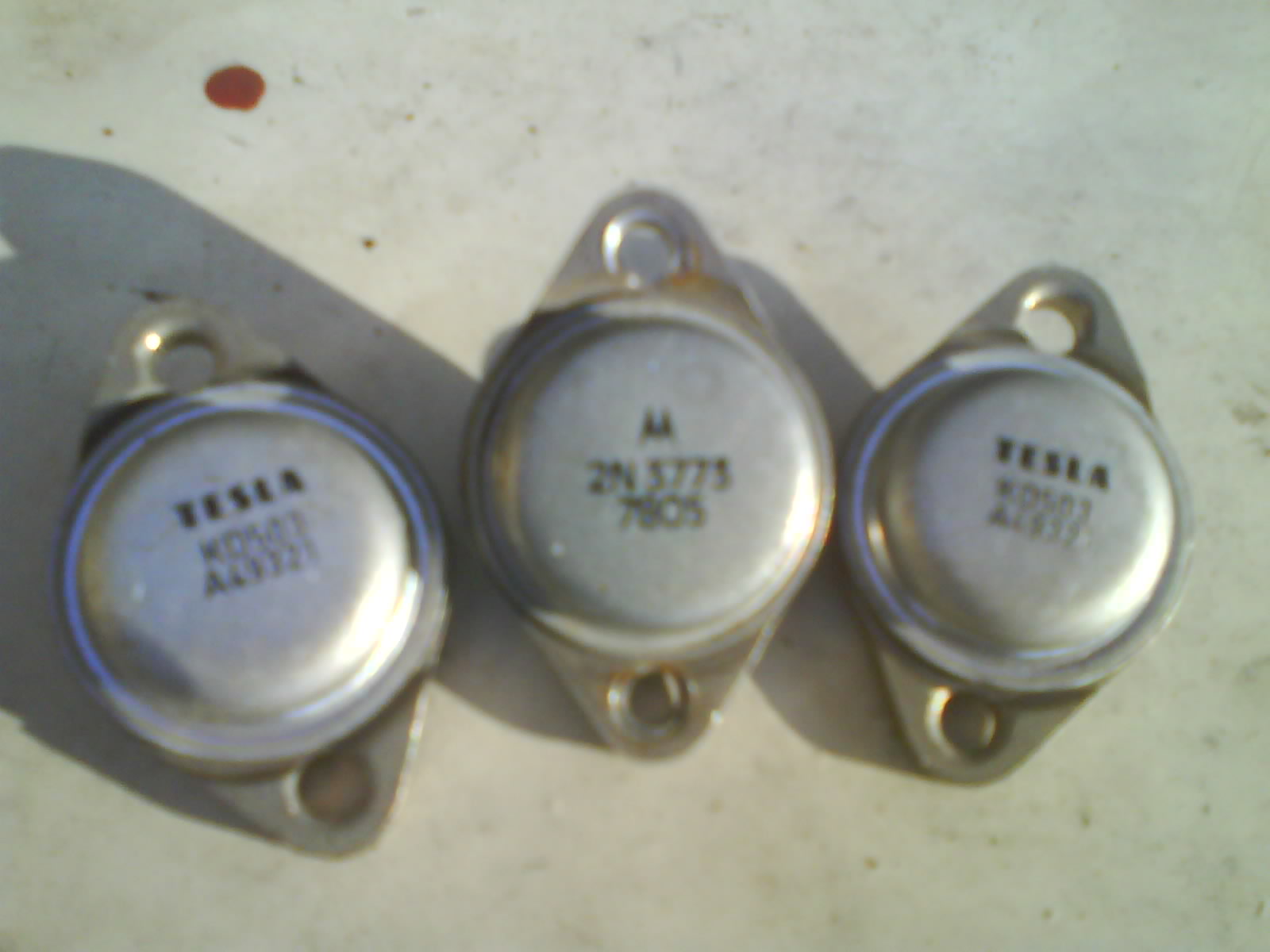

Tiefbass here some pictures from my modest vintage SS stash :
Picture 1 ) Motorola 2n3055 , 5pcs , they all come to me from discarded very old EI NIS B10 color CRT TV which date from early or mid of 70 ` , they serve there as output power Tranz. in Vertical deflection unit driving deflection Yoke .
First from left is very old Toshiba 2N3055 , from same source , very massive one , with twice of Motorola weight , and with very thick pure CU bottom plate .
And top one is example of very old SE3055 from Hong Kong , they work as charm .
Picture 2 , is vintage Motorola 2N3773 , several very old but OK pcs.
And picture 3 , two very old Tesla KD503 in comparison with Motorola 2N3773 where is obvious that Tesla have perfect copied Motorola , 100% same shape ,100% same case material , but more powerful than 3773 , second difference is that Tesla used much thicker device pins plated with gold .
Best Regards !

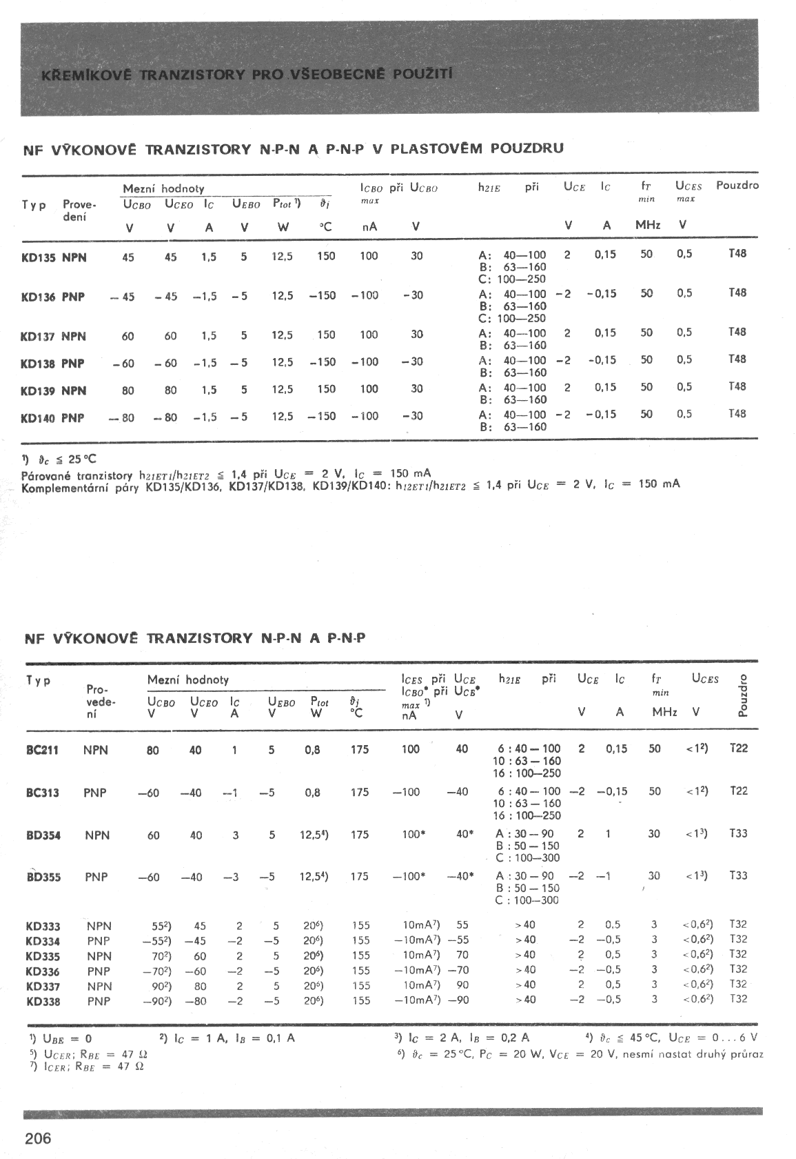

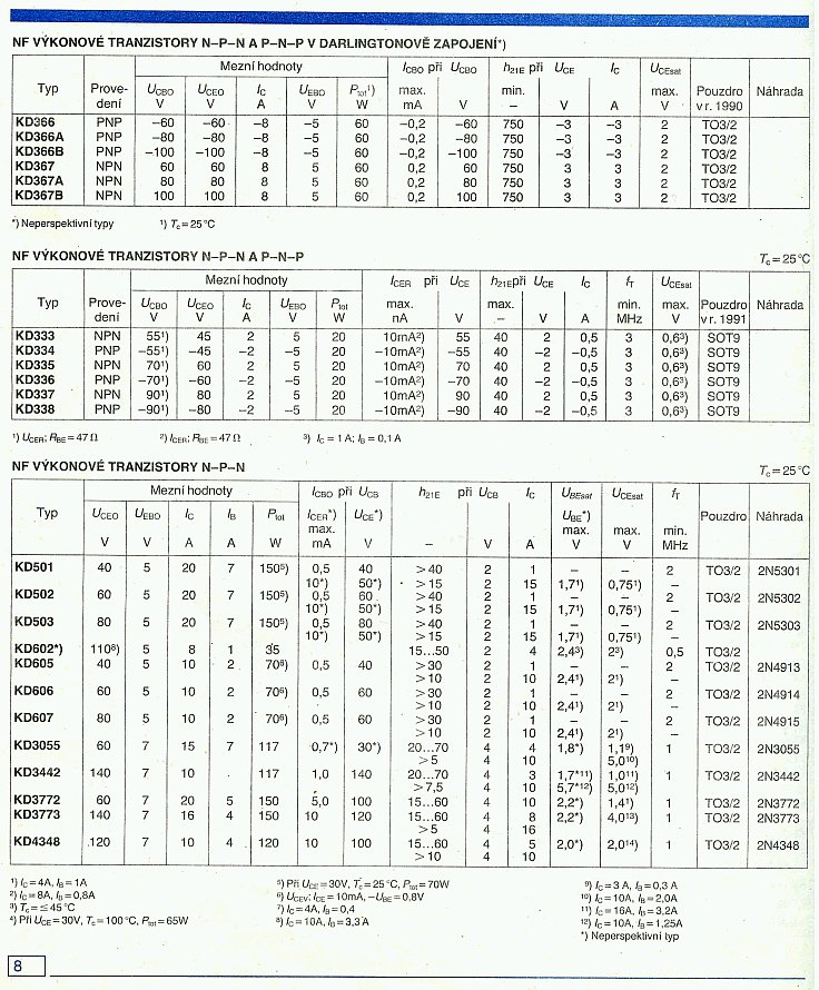

Here is document with that vintage Tesla SS parameters for you :
Must check for that old electronics magazines , they exist here for sure , but I need some time to recheck all that !
