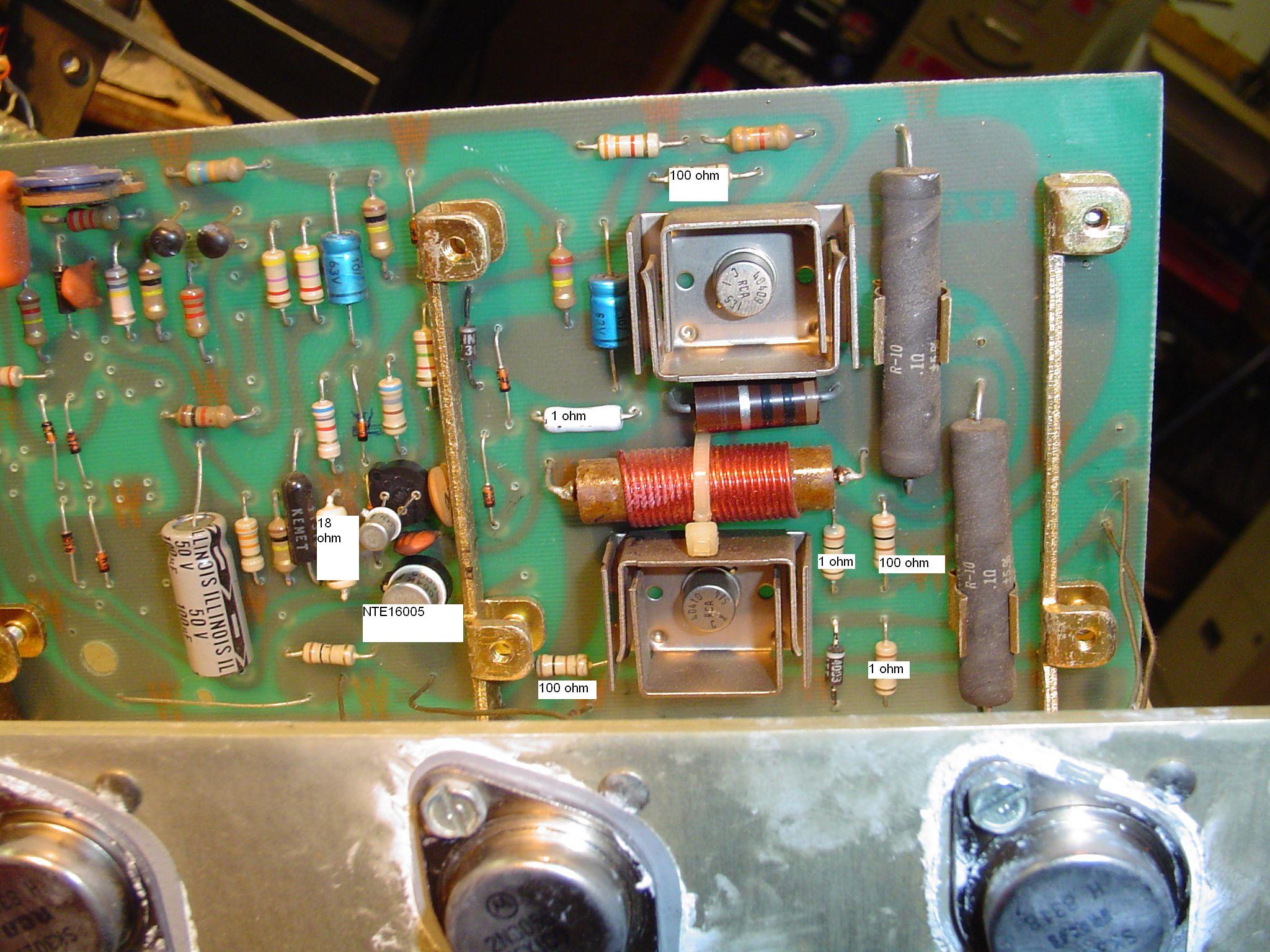

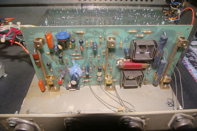

Thanks for the schematic. Several years ago I had the Acoustic 370 or model 371 (same amp but in combination with 301 bass cabinet) for repair. Like by several other amps with triplet quasi-complementary super ß buffer in the output also here was unwanted oscillation the main problem - read more from post #20 aboutlet's not forget the Acoustic Controls 370 bass amp..... the "house numbered" transistors are actually 3055s. only one problem with this amp... if the outputs blew the amp was done. no amount of rebuilding would fix it.
http://www.diyaudio.com/forums/solid-state/113943-quad-303-triple-cascade-2.html
In this case, I had made short work: I reduced the upper half to a normal darlington topology and the lower half to a Sziklai Darlington. The amplifier is running fine since performing this steps.
The challenge to achieve stable operation with a super beta push pull quasi complementary follower was too large (because too expensive) for me.

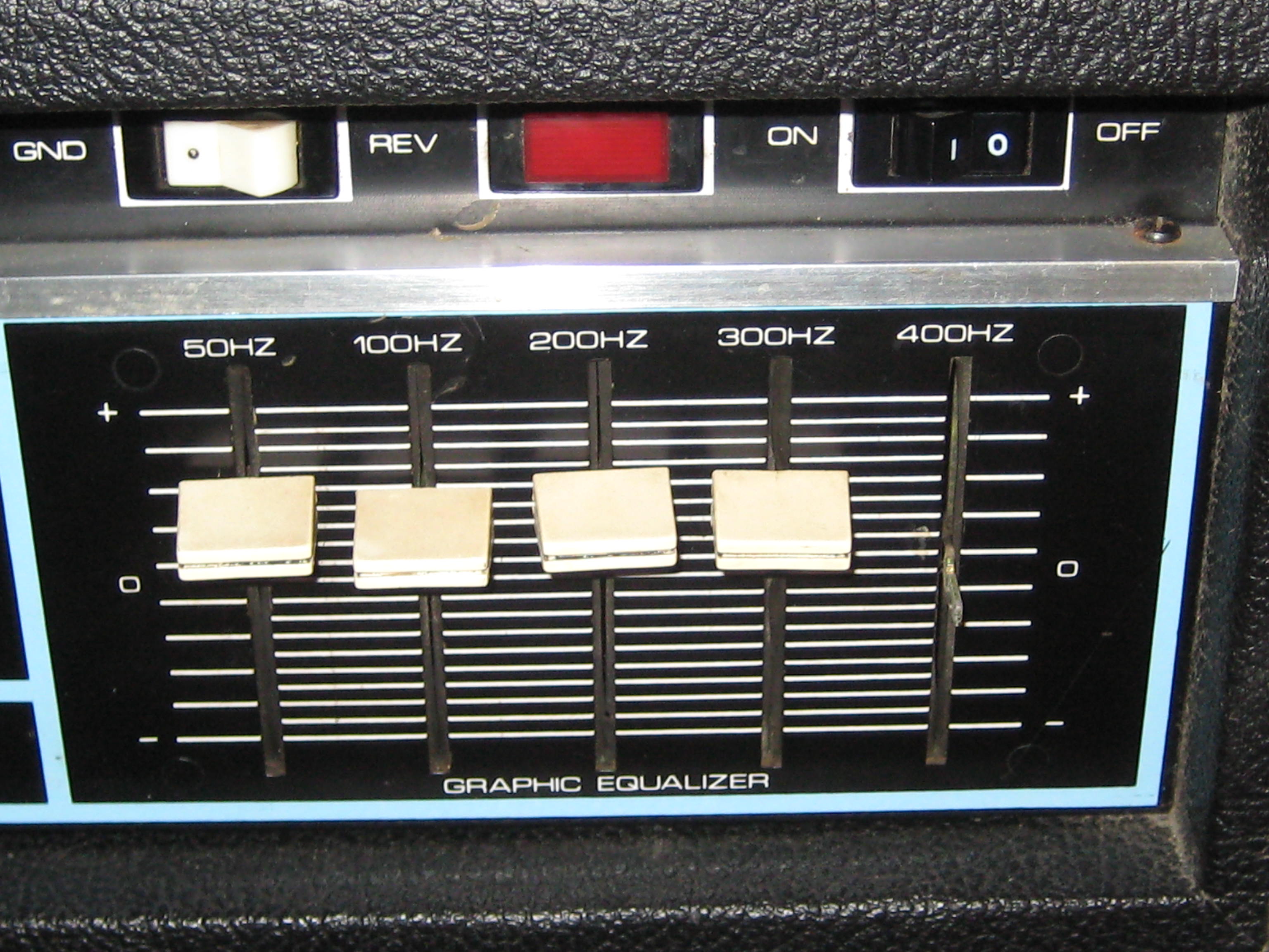

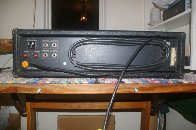

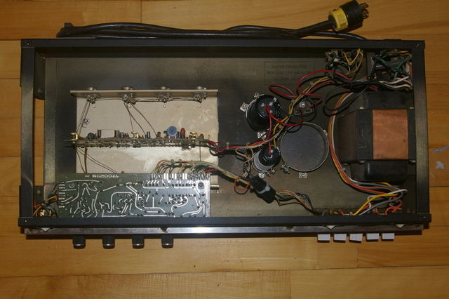

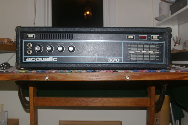

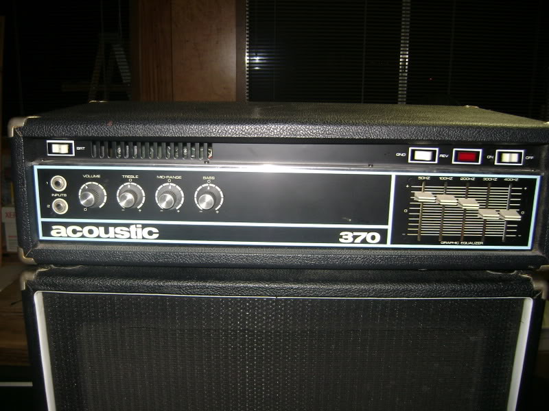

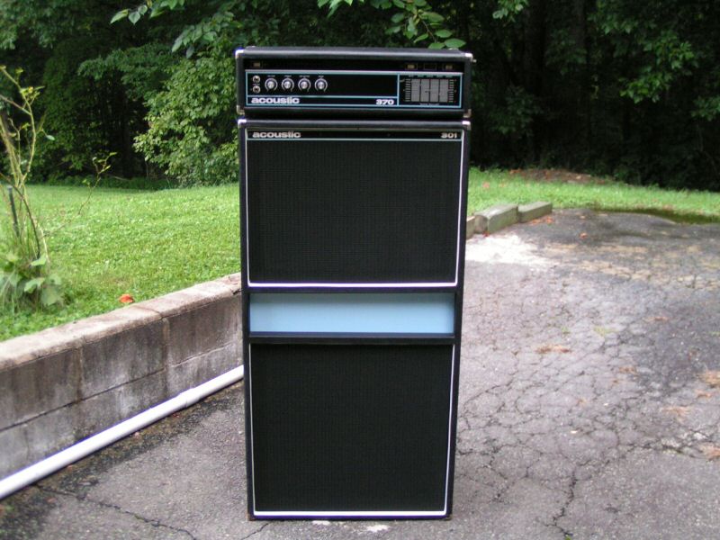

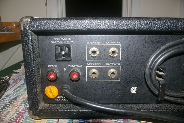

Several pics (unfortunately not from my own repair work) you will find in the attachements and about
