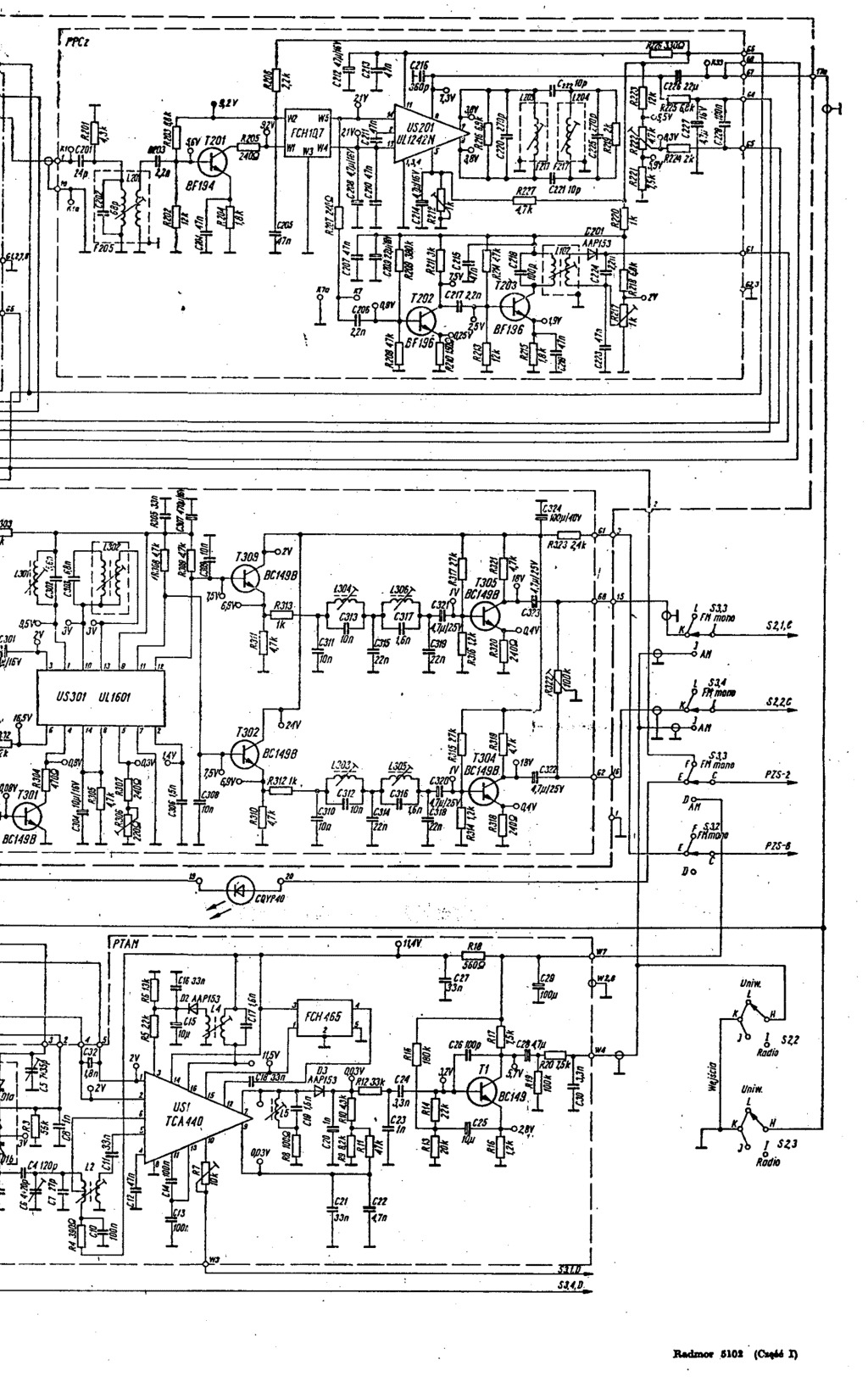

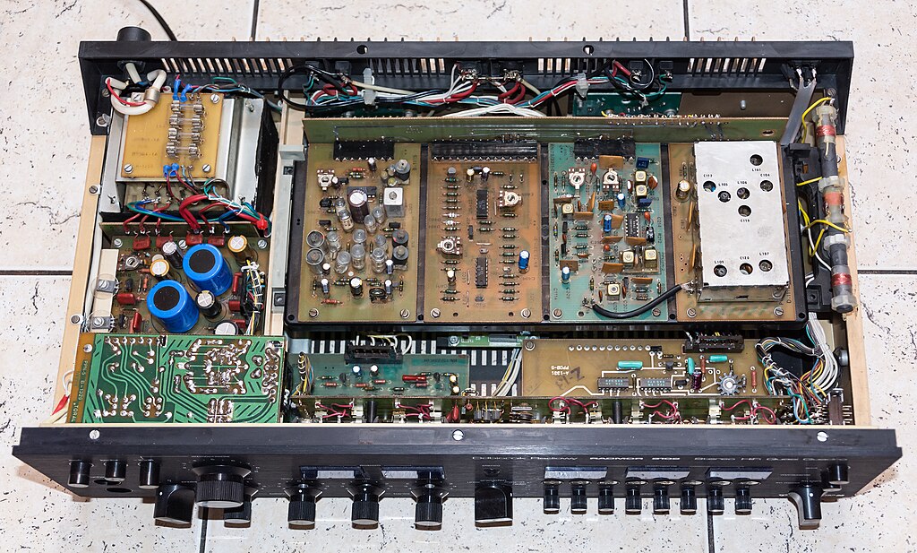

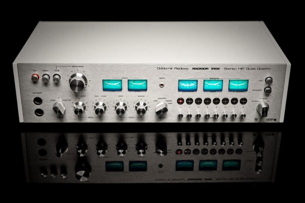

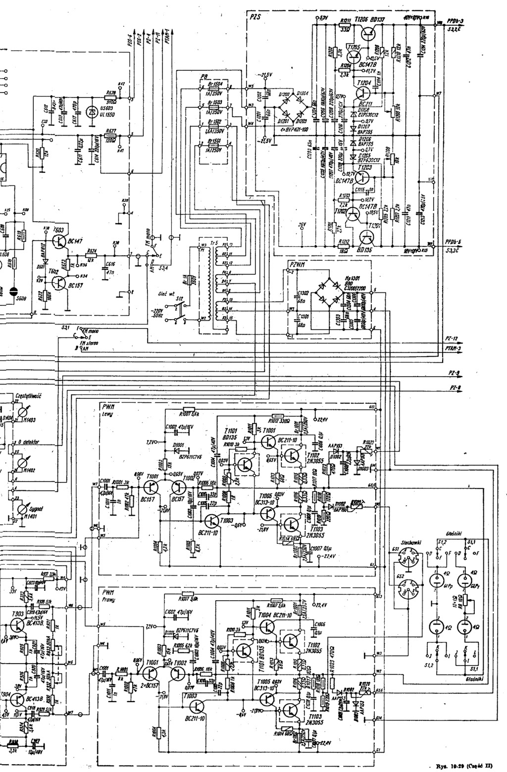

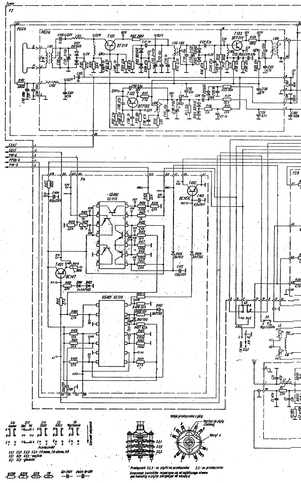

Amplituner Radmor 5102 Hi-Fi Quasi Quadro. 2x25W + 2x15 4ohm, nominal DIN by THD 0,3% from Poland. On YouTube are all mods which make sound better (add current mirrors, lighter loudness like from 5412 model, etc.)and about 60-80 watts per Channel (it's sth abouth change connections by the secondary wirings transformer to have higher power supply on the power amplifier, and change all capacitor's on higher voltage).
It has modular interior. Two screws, socket and you throw out this PCB which you need. 5102-TE has led indicators and output for equalizer.

On this channel you have all the best mods of this amplituner.
https://youtube.com/@systemix1?si=_yOHTUhd2XUU4rgH
If you write to the author, he gives a link to all mod schematics on Google Disc.
Oh, i forgot.
It has OIRT (64-74 mHz)FM. If you want to use a tuner, you must convert it to CCIR (88-108mHz). It isn't difficult.
It has programmable 8 presets with touch buttons, -20dB, phono stage, fader with +/- 6 steps (each side from 0)

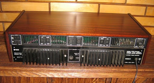

Phono input is between the heatsinks and by it is MM/MC switch.
Quite good piece can buy about 100 euro, worse about 50, but the most expensive are 5100 from the first series (250-500 euro and more). Below you can see front with LEDs from 5012-TE and a back side.
