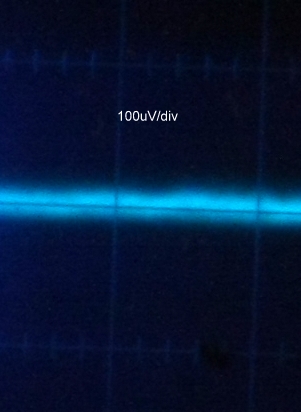

I would say with 10mV ripple it is probably oscillating, what is the ripple going in after the prefilter ?
Well, it was with my bench HT supply and breadboarded with clips and long cables. Low frequency ripple though. I'd do a proper test with an accurate multimeter and the proper power supply over the weekend and report back...
Measured properly today and got just 4 mVrms of output ripple. Similar noise I get when HT supply is turned off, so it's my workbench noise what I get at the output. Still need to test stability with the 26 preamp as just loaded the Salas regulator with a resistor.

From my experience of building a few shunt regulators, 4mV ripple is way too large. You're either not measuring it properly or the regulator isn't working well enough. My shunt regulator, when measured properly, shows ripple below 200uV p-p.
I've an update on my 26 preamp. I mentioned before that using the Hammond 156C plate chokes gave me some nasty hum/ripple on B+. Replacing the plate chokes with either 4k resistors or IXCP10M90S ccs got rid of the hum, so I thought it was some weird interaction between my shunt regulator and the chokes. But no, it wasn't.
I replaced the discrete shunt regulator with a VR-150 tube regulator, and the ripple was still there. Tried to cover the chokes with some metal cans but this shielding had no effect.
Next I separated the power supply from the rest of the amp; indeed, those of you who said that the plate chokes pick hum from the rest of the power supply were right. Even at a distance of 3 feet there was some hum picked from the psu transformer. Moving the psu about 5 feet away from the tubes+chokes shows no ripple at the plates! To me this was quite surprising.

In my noise workbench can't measure anything below 4mv. Surprised you can measure 200uV!
Interesting comments around noise pick up, had a similar experience with a PP amplifier and since then all my designs have separate chassis. My 45 SET works like a charm with separate chassis and DC filaments and cant hear any audible hum even with my Grado headphones!
Yes - indeed those 156C pick up hum from anything. The worst thing for me was the chokes in the filament bias supply - they hum really loudly!! Good thing I built all the supplies in different boxes with 1 metre cables.

In my noise workbench can't measure anything below 4mv. Surprised you can measure 200uV!!
Look, my shunt regulator on my old Tektronix 502A:

This is an open frame EI choke, and therefore very sensitive to stray fields.
This build is the worst you can possibly pick to load your beloved 26...
Much better will be a single c-core with two bobbins, so that much of the iron is screened by the coils.
When necessary some mumetal shielding and there you go, a quiet choke....
