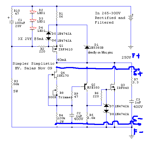

You have to modifie your Salas HV reg. for 4 wires Kelvin to avoid cable lenght.
Why? Will it gave a HF impact? Sure everyone would try to avoid long cables but if compensated properly should work fine?
May be able to squeeze the board on the preamplifier chassis but prefer not to.
Why? And how? Can you please explain?
Salas shunt regulator board completed today. Tested and works nicely. Set output voltage about 170V with input of 200V. Ripple is below 10mV but probably is picked up by my oscilloscope leads in my noise workbench.
Now back to metal work and get the supply chassis done!
Schematic four wires Kelvin for remote sense, link:
http://www.diyaudio.com/forums/power-supplies/134801-simplistic-mosfet-hv-shunt-regs-205.html#post2746868
Tested today with a 50cm leads and couldn't see the difference in voltage drop/ripple. The shunt regulates fine, so will go with the original circuit. Also don't have space left in the chassis, so will be placed on the supply chassis. Will build as is and report results (hopefully soon)
I would say with 10mV ripple it is probably oscillating, what is the ripple going in after the prefilter ?
