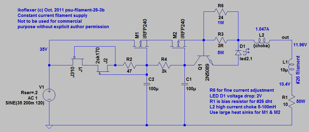

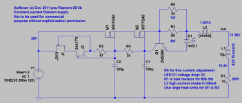

In case people are interested, this is my filament supply for my 26 preamp. My aim was to get as ripple free constant current through the filament as possible, a high impedance looking from the filament to the power supply, and a low impedance looking to the bias resistor/ground.

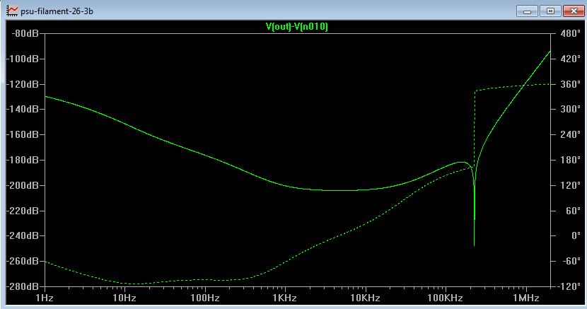

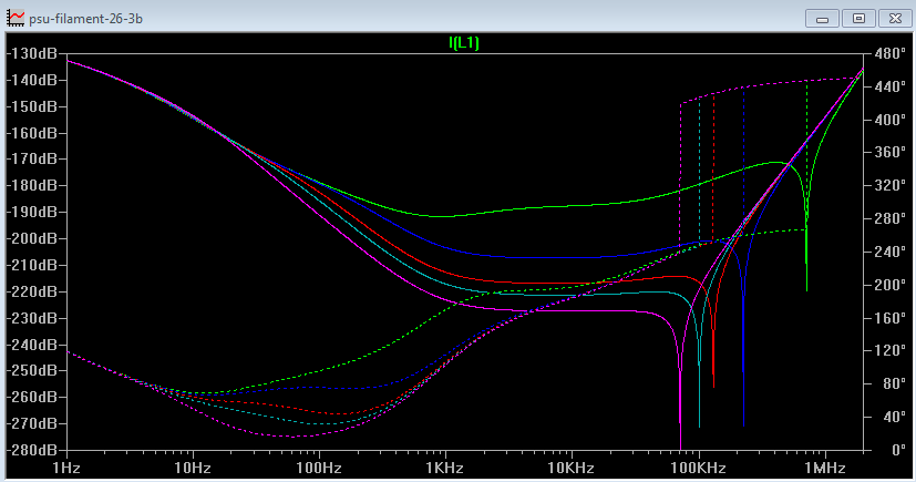

For what it's worth, here's a simulation of the current for various values of L2: 1mH, 10mH, 30mH, 50mH, and 100mH (1R DCR, 50pF parallel capacitance). The green line is for 1mH, and the rest go lower in dB as the inductance gets higher.
The third plot shows the voltage across the filament; changing the dB values positive would give the line rejection of this circuit.
I am aware that reality and simulation are not the same; the simulation results are here only for illustration purposes. 🙂
The exact values for R3 and R6 should be chosen in real life via measurement. But good values to start with would be so that the parallel value of R3 and R6 be equal to sum of Q1 base-emitter voltage drop (approx. 0.65V) and the voltage drop across the LED (in my case approx. 2V), divided by the desired current through filament supply (in my case I aimed for about 1.045A).
I cannot stress the importance of using large heat sinks for the power mosfets. And yes, the large voltage drop across the mosfets is necessary, so that they can do their job properly.
Edit: oh, I forgot to mention, 100R-220R gate resistors for the power mosfets M1 and M2 may be employed if necessary.

Right, Rod. I could make it more efficient, and it would be quite easy to redo the circuit with power bjts, but the performance would not be the same. Even so, lowering the input voltage to 25V (about 10V across the mosfets) would still give a very reasonable 90dB reduction in current ripple. But yeah, it's just another option.

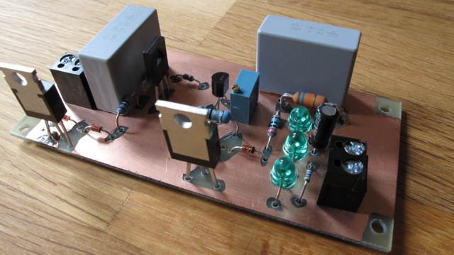

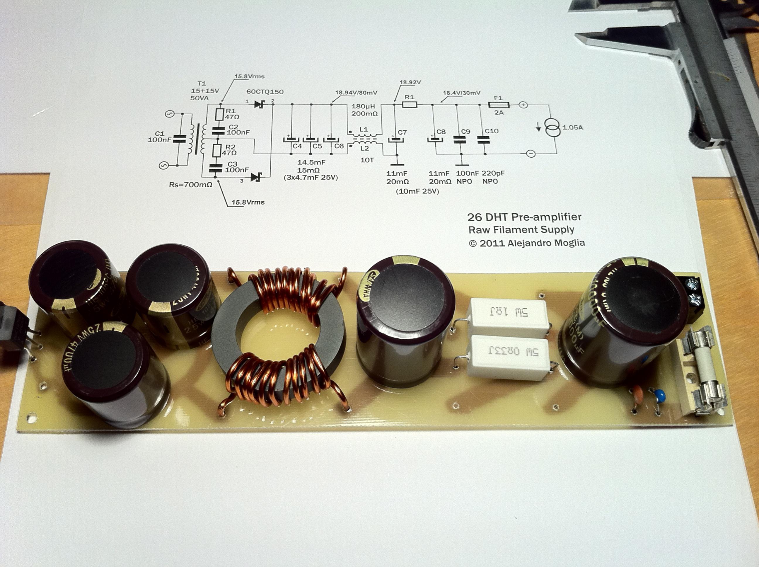

Slowly making some more progress on the supplies. Today I finished the two LT filament raw supply boards to deliver 18V with minimum ripple. Using PSU designer and recommendations from Rod Coleman, I came about with a circuit that delivers 18V and 30mV ripple at full load (1.05A).
I will stack the boards in the supply chassis to save some space. Now I need to work on the HT supply. That will be interesting!
BTW: I found that the noise I have was the HT bench supply. Will see what happens when I get my final HT.
Also did a THD test today and got THD=0.03% @ Vi=1Vrms and Vo=1.84Vrms with a CX-326... nice!

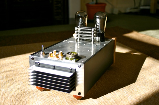

Yes Felipe. You can get very clear instructions from Rod Coleman to design your raw power supply circuit to use Rod's boards. Mine have to be 18V as I'm using filament bias.
Have breadboarded the HT PSU with AZ1 and CLCLC smoothing stage succesfully. Now will crack on the Salas shunt regulator.

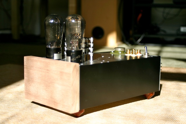

Also finished the pre-amp chassis with a nice wood touch. See attached....
