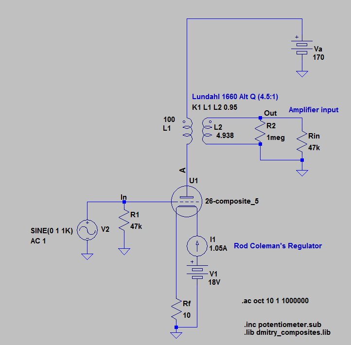

Hi all,
Just another one who fall into this great preamp. Having had the opportunity to listen to Andy Evans' 26 preamp and finished my 45SET, is now time to embark myself on the DHT preamp quest.
After my conversation with Andy yesterday, I've made the decision to go for filament bias. Also have some DHTs at hand that I want to try: CX112a, 01a, 26, 30, 30sp, 10Y and 4P1L. I know that people may suggest to keep with the 26, but I want this to be a learning experience for me.
Hopefully tomorrow will arrive a pair of Lundahl 1660 I bought from Thomas. So will be breadboarding the preamp soon.
I did a quick simulation in Ltspice. See attached. I'm not entirely sure if I modeled the Lundalhn in 4.5:1 connection in the right way. I biased the 26 at 163V and 5mA with a filament bias voltage of -10.5V. The stage gain is around 1.7 and the frequency response is 15Hz-15kHz. Is the anode inductance responsible for this response? Any way of improving this a bit?
Ale

Hi all,
Ale
It would either be interlayer capacitance or leakage induction, can't imagine spice would be able to predict HF reponse out of an amorphous transformer.
So you are floating the Colemane regulator at -10.5V, using a battery?.

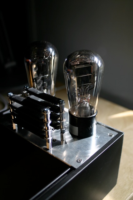

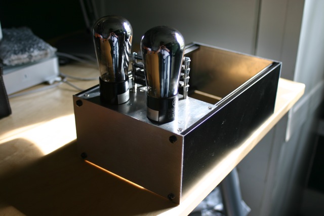

Slowly coming to life. This morning managed to complete the valve board and fitted it in the modular chassis. The board has the two sockets for the 4-pin valve of choice (first one to try will be 26). Also have added the filament bias resistors...
Now will go for the OT board for the LL1660s....
All thanks to Andy Evans who kindly helped me out with some of the parts...
cheers,
Ale

Hi Ale,
looks great! Those black resistors ( I assume filament bias ) Look cool the way they are mounted!
Best regards
Thomas

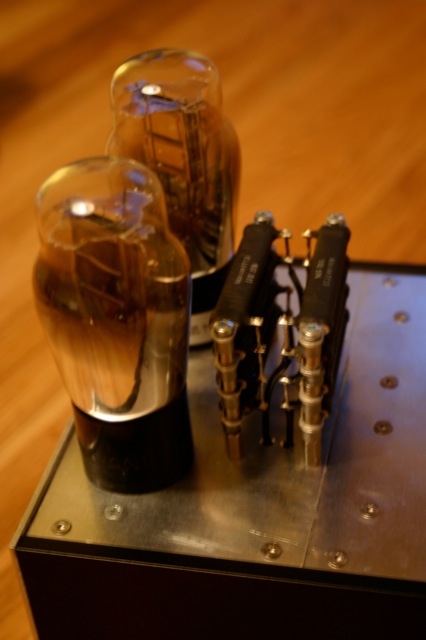

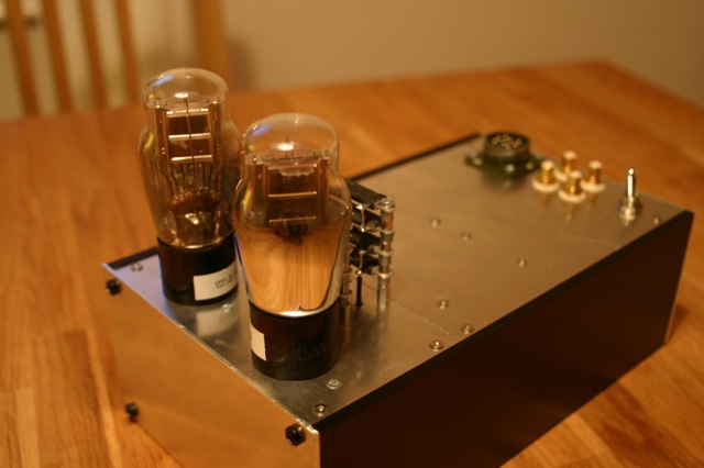

Hi Thomas,
Thanks! Indeed, those are the filament bias resistors that Andy gave to me. This afternoon managed to complete the second top plate in which I mounted the LL1660 you sold me. See attached.
Just did a simple test with my bench power supply and managed to get Av=3.5 at Va=162V, Vsupply=170V. Ia=5.6mA and Vg=-10.5V
Looking really good. Now need to crack on with the remaining bits and start with the power supply. That will take me some real time...
Ale
