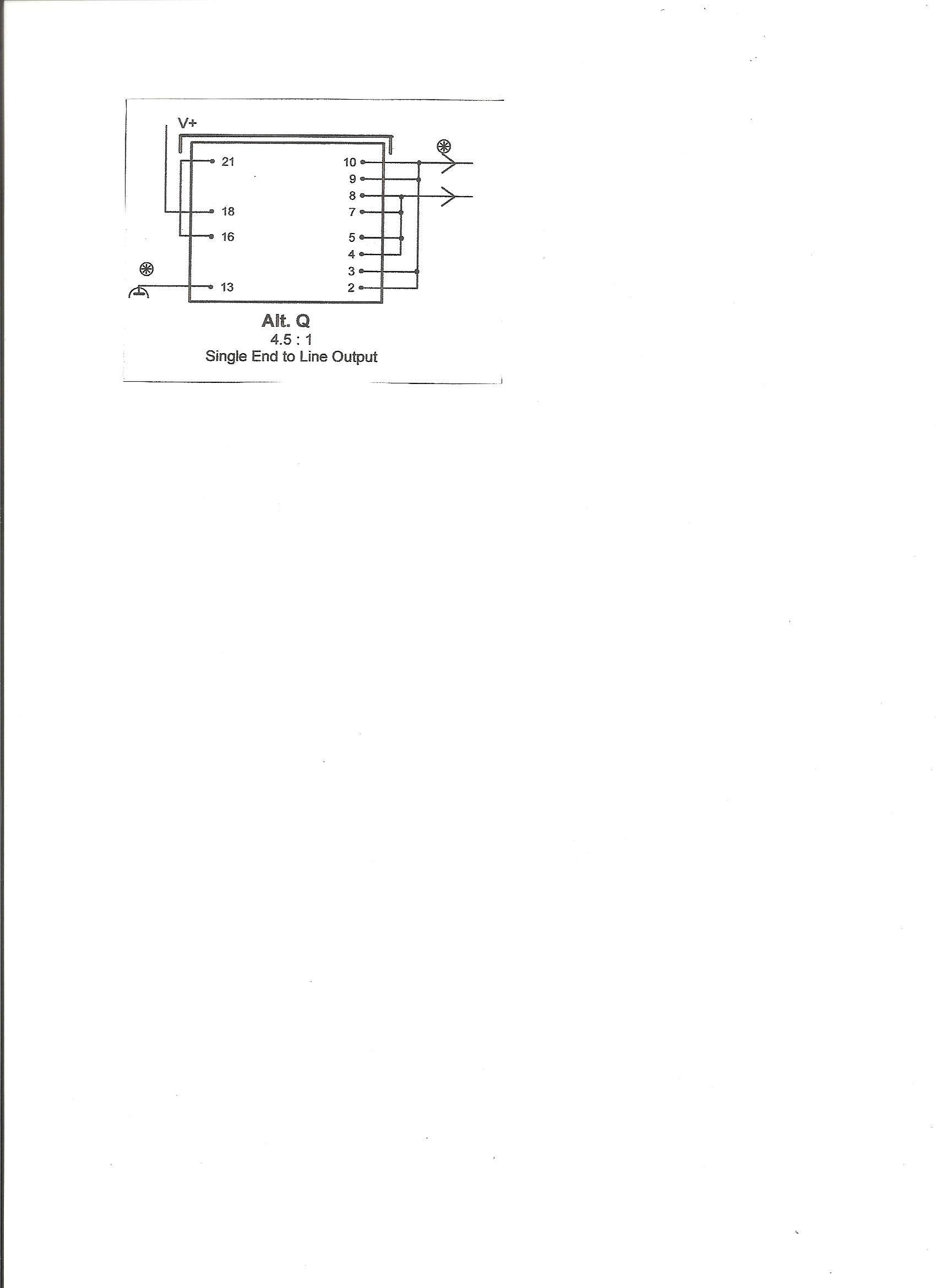

-LL1660 must be wired as per attached pic?
Yes

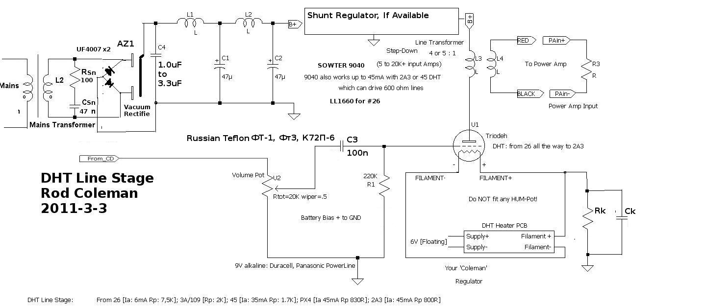

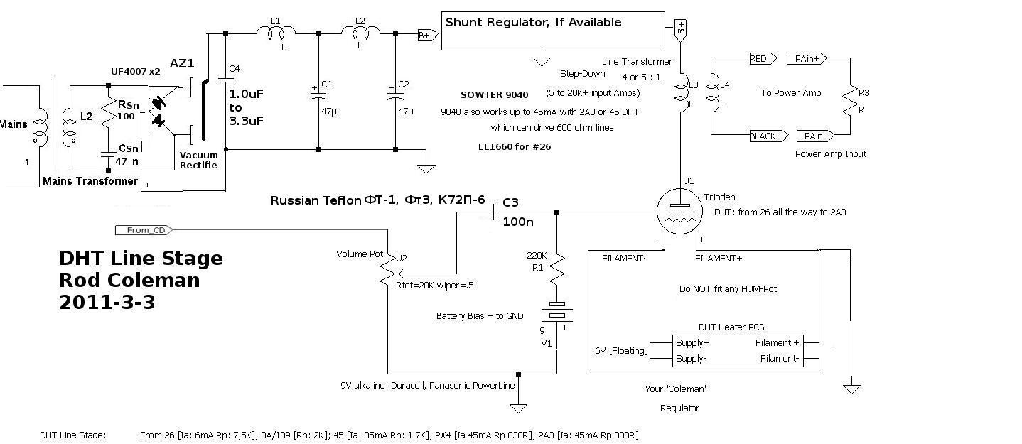

Hi Felipe,
This is the schematic I use for starting work on a Line Amp. I have drawn it with Battery bias, and Kathode bias versions. Maybe you can use this to start your own schematic?
You will have to decide a value for the rectifier capacitor [C4]. Wire the transformer, rectifier, chokes, capacitors, then try the power supply and change C4 until you get the right voltage you need. This capacitor should be 4.7uF or less, or the rectifier will suffer.
When you are happy with the supply voltage, you can adjust Rk to get the operating current in the 26 (Kathode bias version).
Connecting the Filament Regulator: For Kathode or battery bias version, the filament regulator FIL+ terminal connects to the Kathode resistor, or Ground (battery version).
(With Filament bias, it's the -ve terminal).
Please make sure there are no hum-pots, or ANY other wiring to the filament regulator. If you can wire it like this, the preamp will be completely quiet, and sound wonderful!

Hi Rod,
I always see snubbers across secondaries in you schematics. How do you determine the values of R and C? Is there a rule of thumb, or do you measure by scope what is optimal.
Have you ever listened to the effects of snubbers? I mean are they there for better measured performance or for better sound quality (or both!)?
Peter
Hi Peter, When the rectifier conducts (and when it blocks) the current waveform in the trafo-rectif-cap circuit might have steep edges.
But, we know that the transformer is inductive - we have an LC tuned circuit! This can make the current with a large resonant peak, which might be coupled into the signal wiring ( by conduction, or by radiation).
A series R-C circuit will provide damping, to control the current peak. To make an accurate snubber, you must make a current probe (ferrite toroidus with a few turns... rectifier lead goes in the toroid centre-hole). Adjust the R and C until the current waveform in minimized at turn-OFF).
Measuring voltage is not much help, the current probe is needed.
The R & C values depend upon the transformer inductance - but with most trafos, 47nF to 220nF and 47 to 100 ohms will reduce the kick-back waveform quite well.
I find that even small changes to remove high-frequency noise in an amp make a big difference to the sound. This is even more important, if the transformer/rectifier/caps are not fully shielded from the signal stages of the amp.
It's exactly the same with the Filament Regulators - every small reduction in high-frequency noise can be heard. DC heating solutions that fail to tackle this problem will sound worse than ac heating!
Interesting stuff Rod! Thanks for clarifying!
I will make a current probe from a ferrite toroid and will de some measurements and listening tests.
This method is unfortunately not suitable for bridge rectifiers since the measurements are taken from the anode or cathode lead of one of the diodes. Is it also possible to measure this phenomenon with a current probe around one leads of the transformer secondaries?
Peter
Hi Peter, please try measuring current in the trafo lead, and maybe also in the capacitor (after the rectifier -C4 in my schematic above).
Please make sure that the wiring between the rectifier/trafo/capacitor is short - this reduces radiation. The measurement will be easier, and the sound of the amp will be better!
