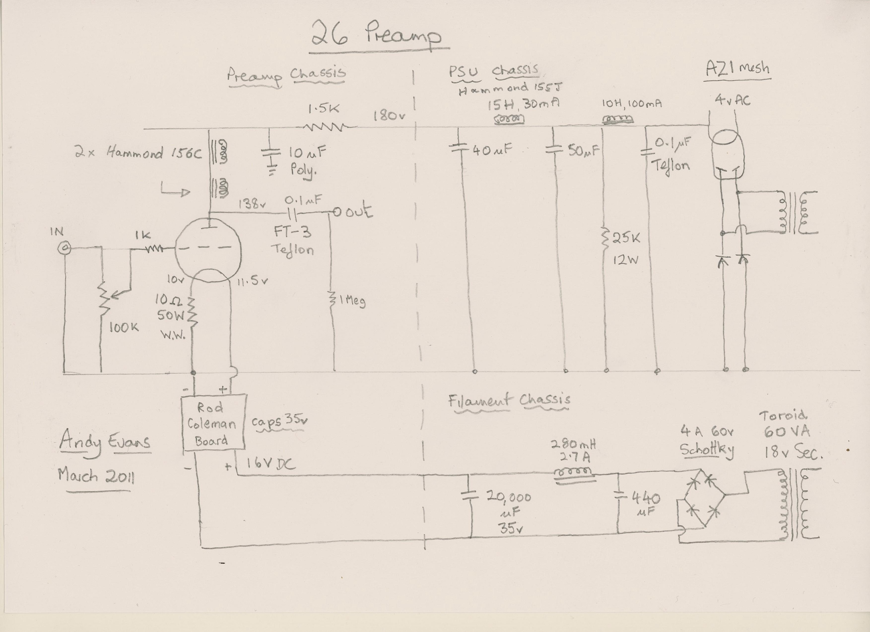

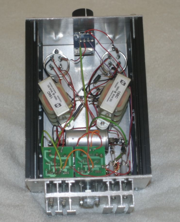

Who's using plate chokes in their 26 preamps? I've been playing about with four 156C Hammond chokes - 150H at 8mA - using them in series as pairs. I put them bottom-to-bottom and wired them out of phase since I read that somewhere. Resistance in series is 7K.
Sound is damn good! Quite surprising. I'm using Teflon FT-3 output caps and filament bias with 10 ohm resistors. 140v on the plate, 10v on cathode. Rod Coleman filament supply - his original one which was posted early on in these pages. This is a really cheap and effective way to build a 26 preamp, except that in my case I'm using choke input supply to Rod's boards with a 280mH choke, 2.7A, and 20,000uf caps.

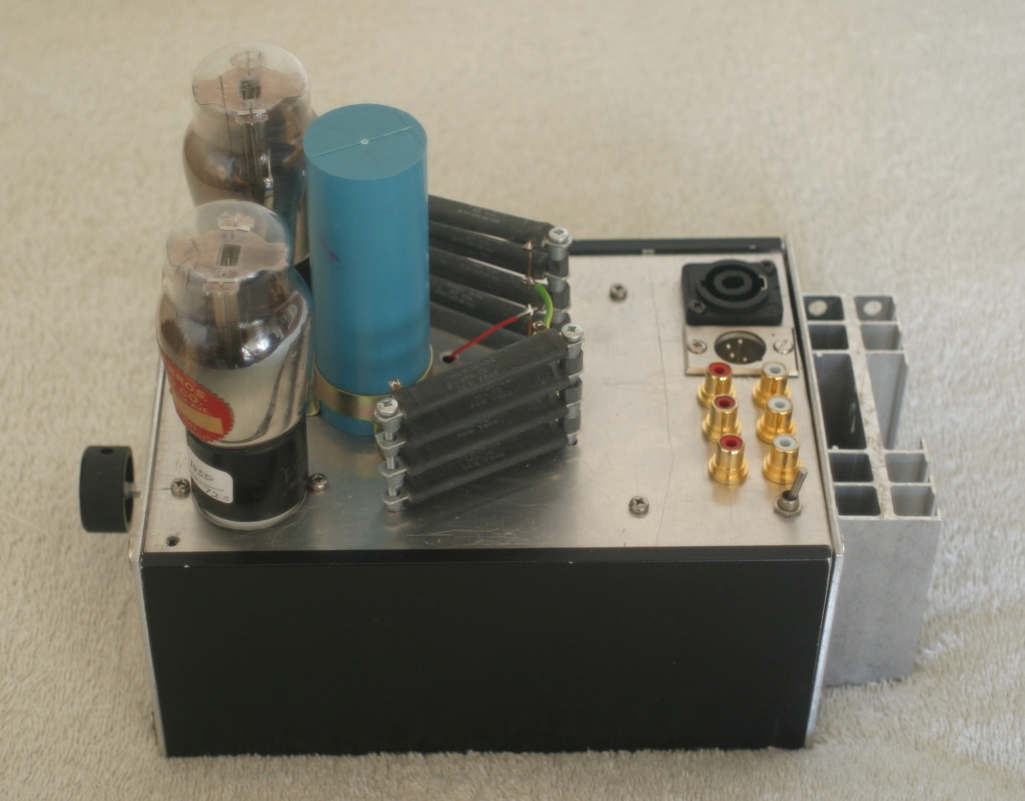

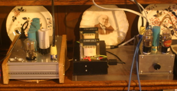

Here's a picture of my 26 preamp. Power supply on left - AZ1 mesh, choke input, motor run caps. Middle is filament supply with two large 280mH chokes for choke input. Preamp on right is tiny! Rod Coleman boards, filament bias with a 10 ohm resistor. Sounds very nice. The preamp bit is ultra cheap - just four Hammond 156C plate chokes, wired in series in pairs with FT-3 cap outputs. Chap on the plate is Disraeli.
andy

Very nice. What does the 10 ohm resistor do?
With filament bias the filament supply is connected between one side of the filament and ground. The other side of the filament has the 10 ohm resistor going to ground. So the filament supply goes through both the tube and the cathode resistor. This can sound really excellent, but only on condition that the filament supply is really pure and clean, since the signal goes through it. Compromise the filament supply and the sound can get sharp or gritty - some people have tried and rejected this, but I suspect they really needed a no-compromise filament supply. You can see the size of the filament chokes I use!!

Thanks to share, could you post the schematic used?
Felipe
Andy, it looks splendid.
I particularly like the stacked array of Vitreous enamel resistors.
Is that the LCR motor cap in the blue plastic enclosure? If so, may I humbly recommend a go on their newly-acquired AMPOHM audio MKPs? These are HUGELY better than the motor-type, in my trials.
The motor series pay no heed to mechanical resonances, and the sound really varies according to whether they were wound tightly (e.g.: before important football match) or slack (Friday afternoon).
