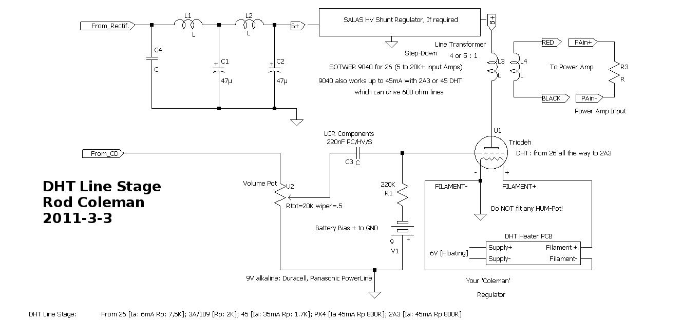

Independent of the price, what´s in your opinion the best sounding transformer for the #26 in a circuit like Rod´s or kevinkr?
Hi!
In such a circuit with a step down lineout, which is the right way to go in a linestage, the Lundahl LL1660 is hard to beat, independent of price. This is the application in which the 1660 excels. I have not tried everything on the market. But for me the 1660 wired 4.5:1 performs so well that I stopped thinking about alternatives and rather look for other things to optimize.
Also to you I can offer to send a pair to you, if you don't like them, send them back.
Best regards ... Thomas

fully agree with your approach! As input stage in a power amp, you can couple the 26 1:1 or similar. That's why my recommendation above refers to the use as a linestage where low Zout is desirable.
But the full potential of a lowZ linestage can only be explored if the opportunity of the drive capability is also used to drive an inductive volume control.

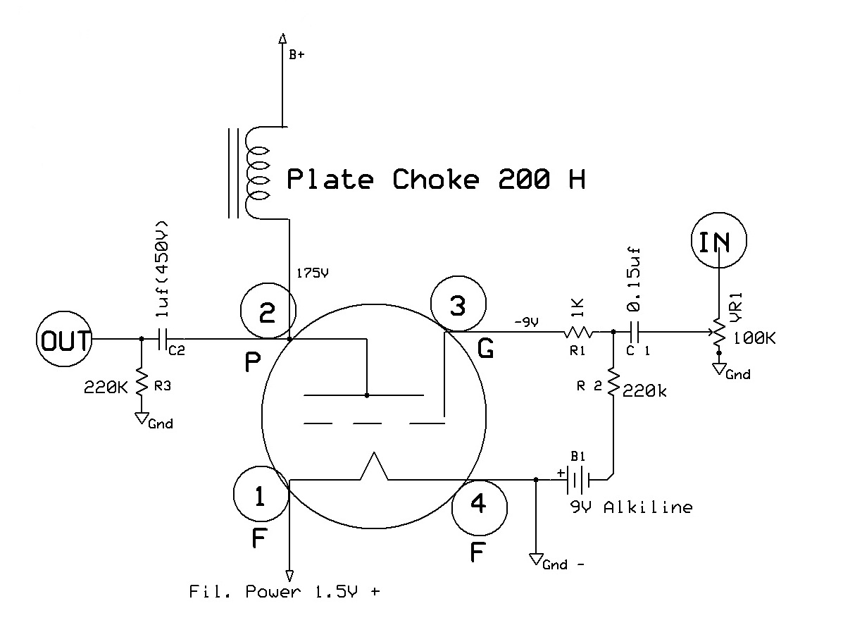

Hi All,
I am in the process of completing Phaeton RC 26 preamp published on VT52.com site (Jim de Kort) as my latest DIY project. But still I am little puzzled with few things with my current project. Hope someone could provide an expert advice to me to figure out those.
One thing I am confused with is the hum coming out from B+. I figure out it is something to do with the grounding however. Lately I found out that if I ground the filament negative with B+ negative with 470uf capacitor, the hum is almost disappearing. But not sure whether this method is right or safe because what I did was sheer coincidental . Need advice on this. I used separate power rail using a SMPS for filament and both filaments were connected serially with 3V supply. Only connection for B+ negative from this rail is 470uf negative to negative (capacitor + to filament's negative and capacitor - to B+ negative).
Second thing I am puzzle with is the bias supply. Should I use separate 12 V supply for bias for 26 tube or should I use voltage divider to get the bias supply? Where exactly should I connect the bias voltage in this schematic?
Greatly appreciate if someone could clarify these for me.
Hi coolzero,
""...Only connection for B+ negative from this rail is 470uf negative to negative (capacitor + to filament's negative and capacitor - to B+ negative)....""
In your diagram, there is already a 470uF capacitor, connected between GND and three resistors.
Did you add one more 470uF capacitor?? If so, could you show it on a diagram please??
Thankyou,
King
