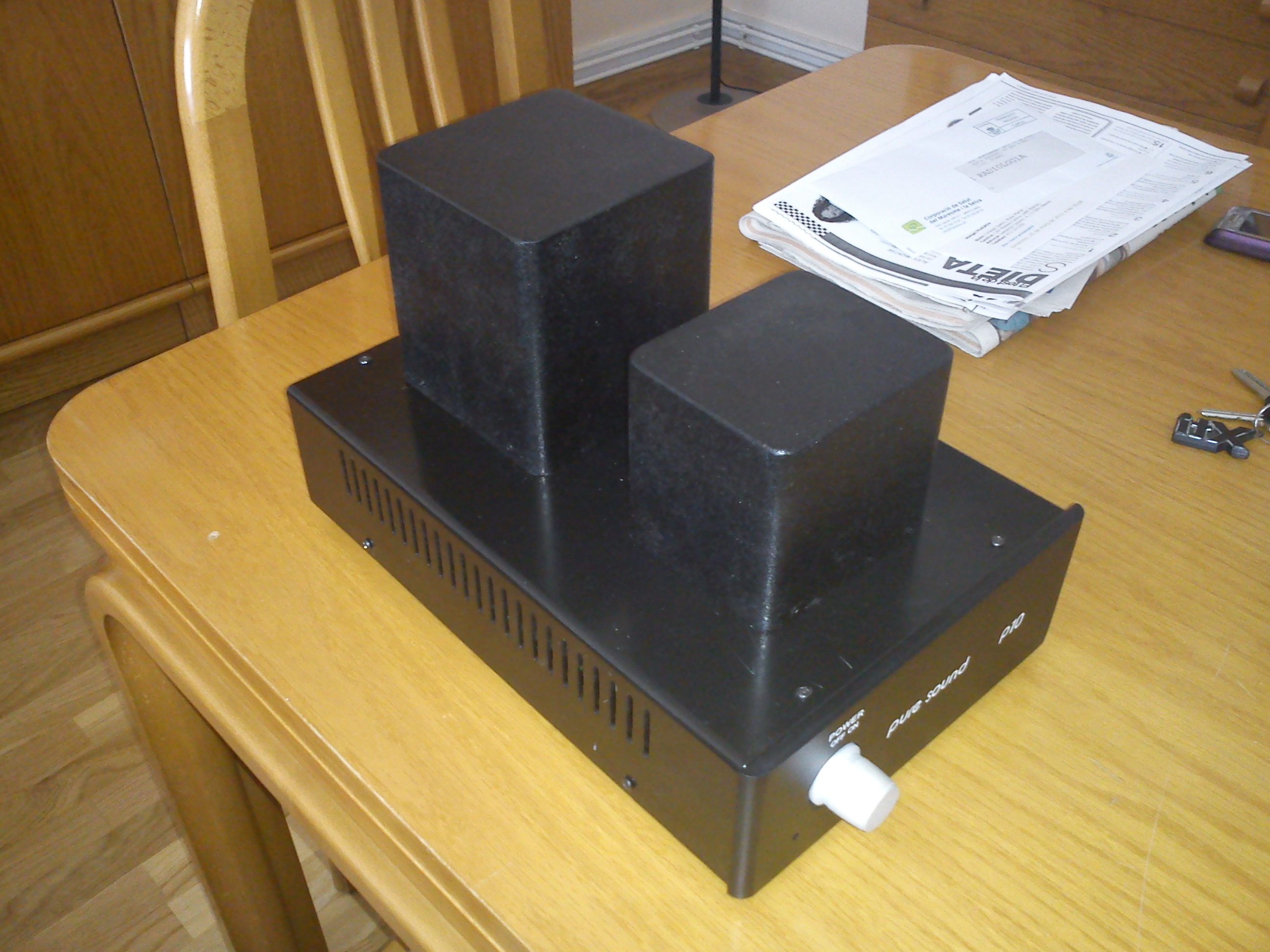

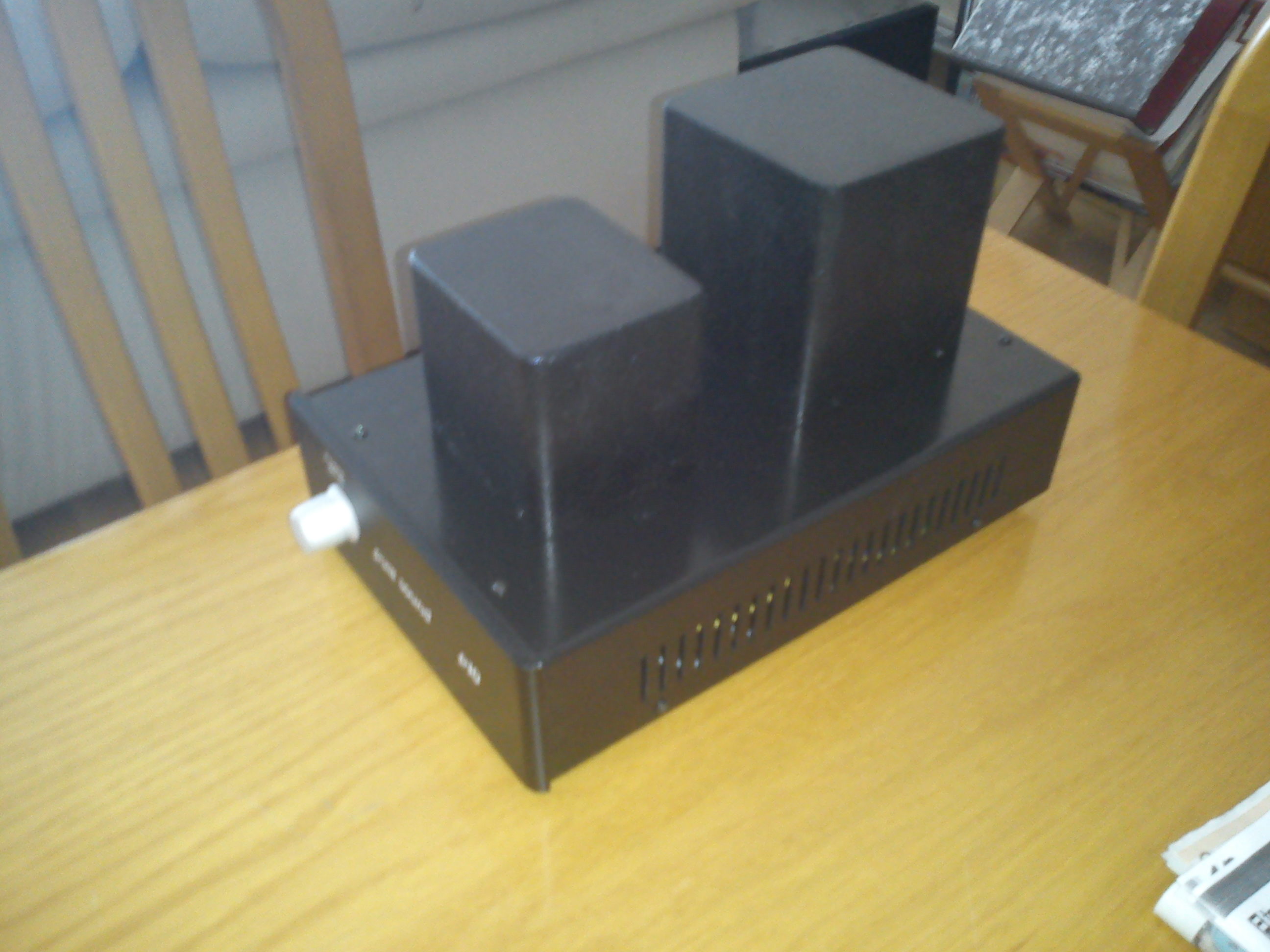

You are right, tubes needs a lot of iron & it's expensive, lately I bought for a friend a Tx 150VAC 100W CF125 & choke 10H 100mA MR8L from Giuseppe Bartolucci how knows to do impressive iron.
About football don't worry I only wait a very good match.
