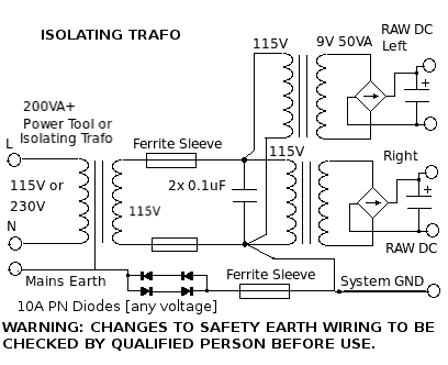

Andy, this is good advice from Thomas.
Choke input means a big reduction in the peak current into the reservoir caps. Reducing this current can improve the sound of other parts of the audio system connected to the same mains supply.
The type of mains trafo is also important. split bobbin type reduces noise transfer from the mains (compared to toroidal or overwound types), and high quality trafos with an Electrostatic screen can be even better still. My preference is to use an isolating transformer, and an HF barrier in the safety earth (Sadly, safety earth can transmit some troublesome noise): the drawing shows a suggestion for connecting it.
I fully agree with Rod on this. Using cheap power transformers is cost saving in the wrong place. Especially if the power supply changes seem to have a big impact on the sound, this could be due to a poor power trannie. I settled on power transformers with two independent screen windings. In fact the screens are not windings, but electrostatic screens made with foils. Also the core material of the power transformer has an impact.
