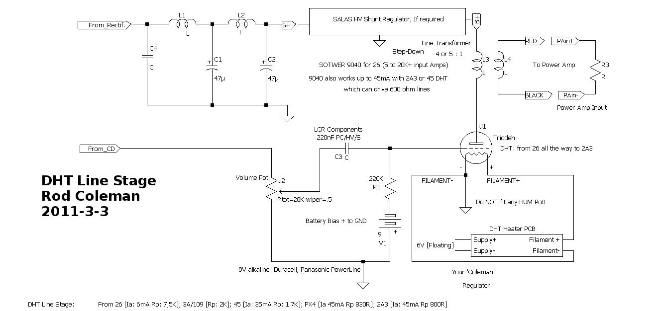

Oliver,
It is true - the Filament supply should be floating, and then ONLY connected to Ground at the tube socket.
Here's my view of the general schematic for Transformer Line Preamp - use the transformer type (Lundahl, Sowter) to suit the DHT you are using.
There's more details on connecting the Filament Supply in the PDF Manuals - sent today!

Well, I finally tried out battery bias on the grid instead of filament bias! My impression is that I prefer it to filament bias.
That's something I need to know - it'll certainly make my life easier - no need for high current resistors and large filament transformers. It's not night and day - filament bias is good when it's really clean with choke input etc. So I'll need to do a bit more comparisons to be sure.
Right now I have battery bias on my 10y preamp into a Hammond 126C transformer. My 26 preamp with LL1660/5mA still has filament bias, and that one sounds better than the 10y preamp when it had filament bias. So next need to try the 26 preamp with battery bias.
Any preferences for an input cap? I'm using a 0.1uF Russian silver mica. I also have the Russian teflon ones of various kinds I could try - thinking FT-2.
