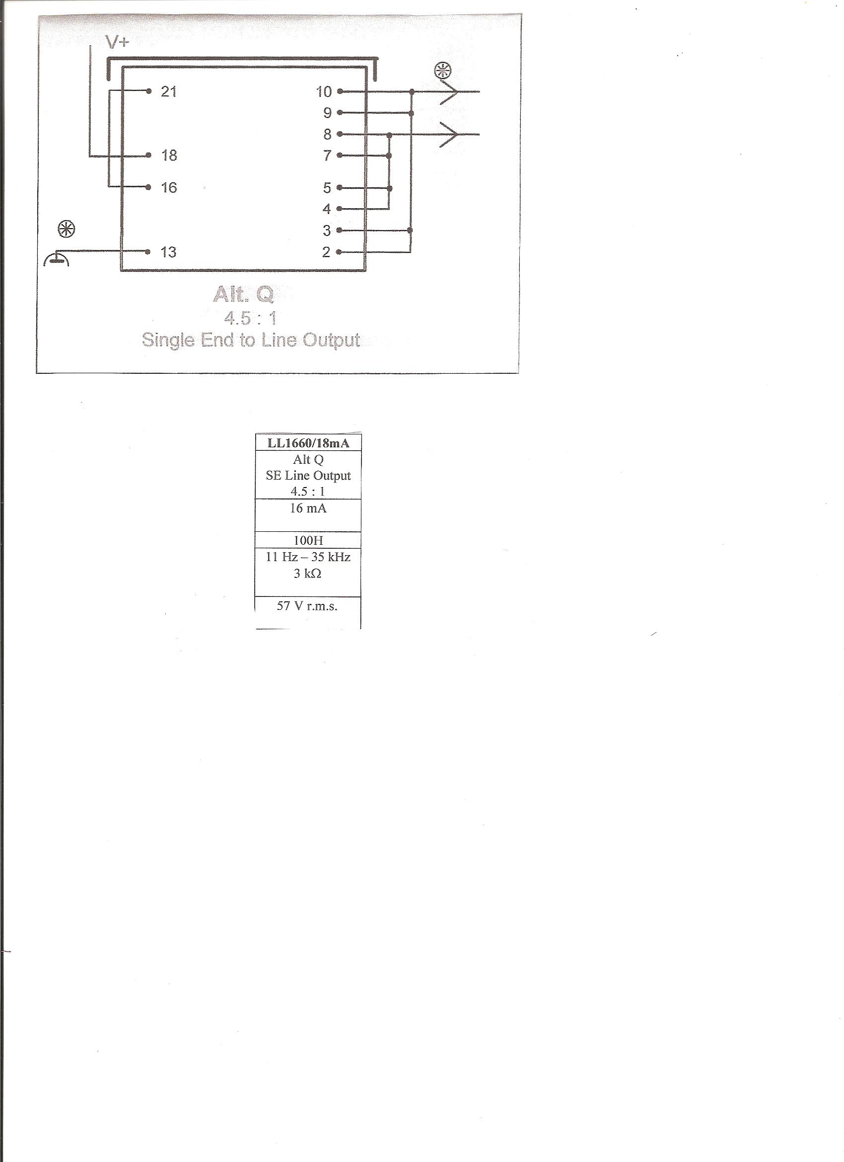

Hi!
The LL1660 is a transformer as the datasheet says. It can be used as a choke, if you connect the primary and leave the secondary floating. You can even wire primaries and secondaries in series for higher inductance but less DC current capabilities. But if you want a anode choke, better use LL1667 or LL1668 which are made for this purpose.
All wiring diagrams are given in Lundahls datasheets.

I want to use 26 preamp with my SS Erno Borbely 75WRMS class A amps & eventually for my Sennheisers HD600 as heaphone amp, can I use it or I have to forget in the applications that I want?
If I understood correctly LL1660 only for line output & LL1667 or LL1668 as anode choke & psu choke.

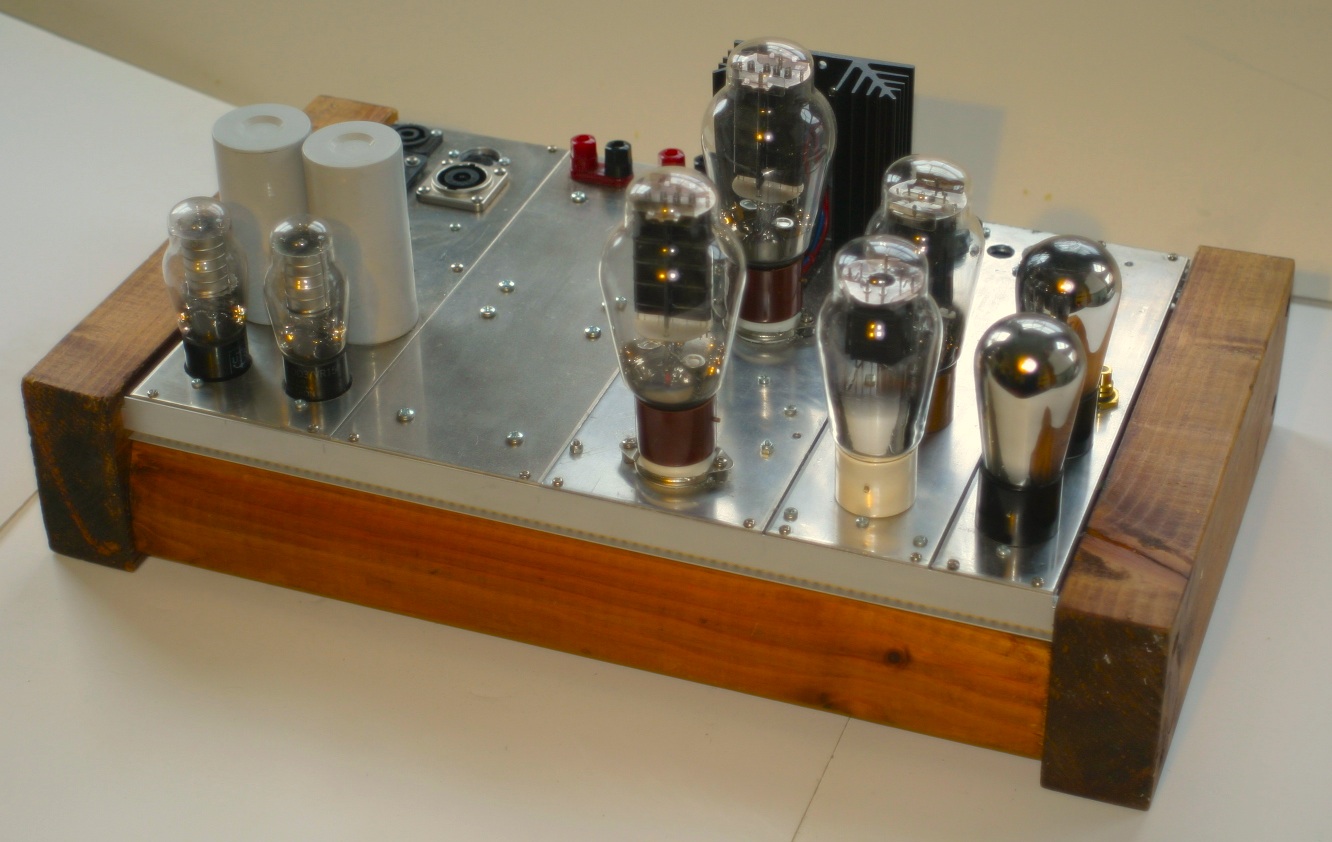

Here's mine - it has a separate power supply. Glow tubes on the left for the input tubes. I use a modular chassis with several interchangeable top plates, with rackmount parts as you can see. All my chassis are 2U and usual rack width. Lundahl transformers underneath.
Andy

Bad news, my SS Borbely amps are less 10K input impedance so can't match with the 26 preamp? can I use the 26 preamp like a headphone amp for Sennheiser HD600?
@Thomas
This only means you can't use it with a 1:1 output transformer or with LC or RC coupled output. With a Lundahl 1660 4.5:1 it will easily drive your SS amp.
