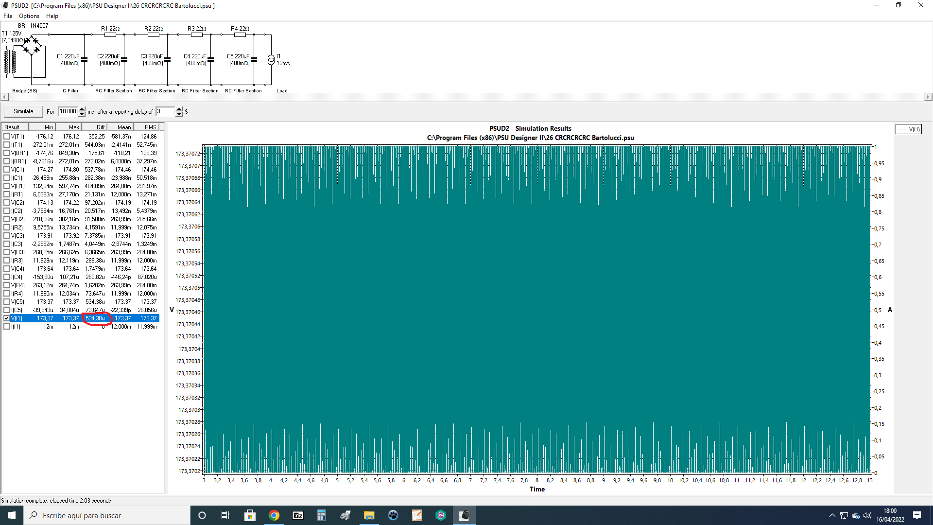

Installed several CRC PI filters to drop the AC ripple.

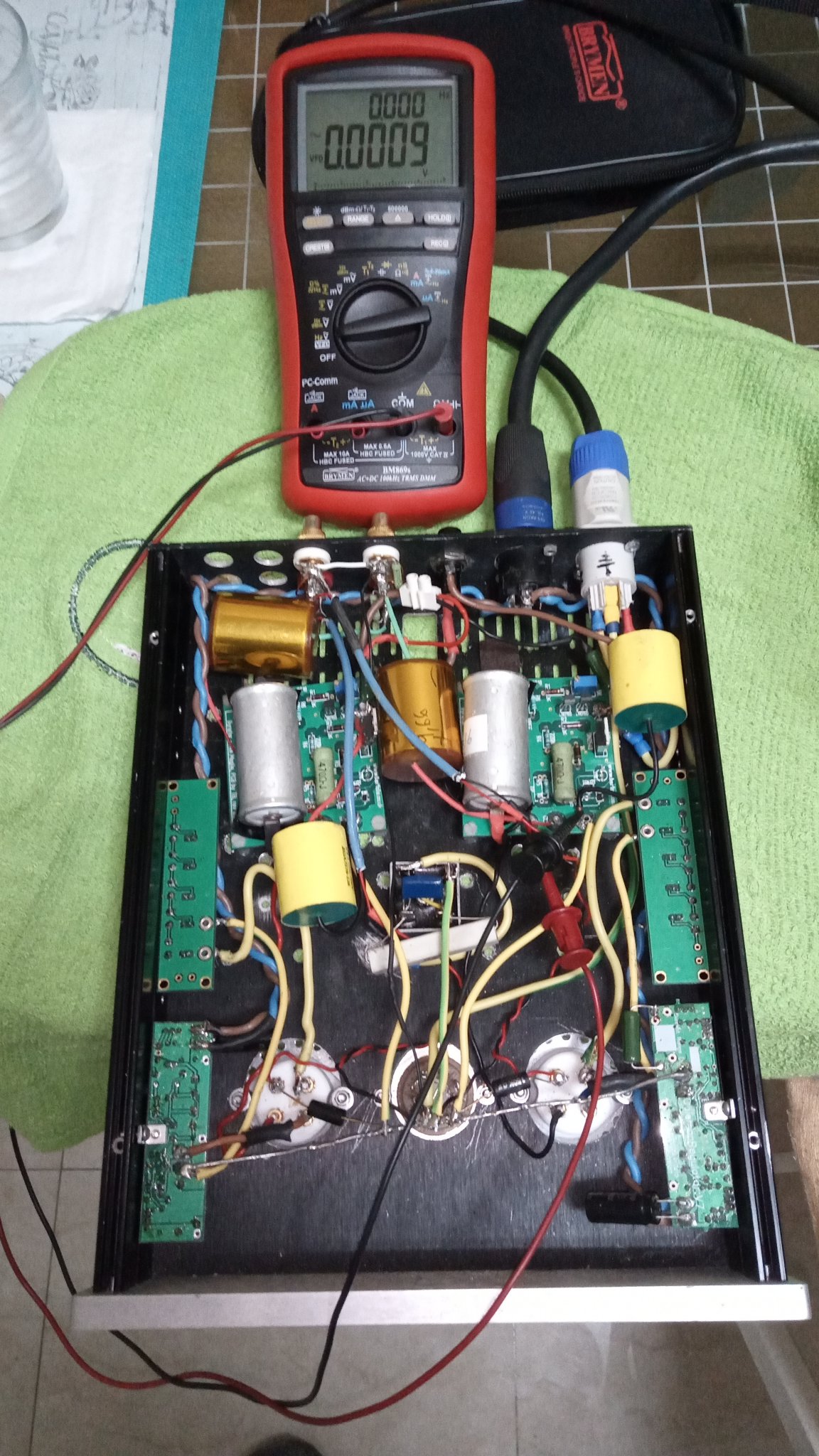

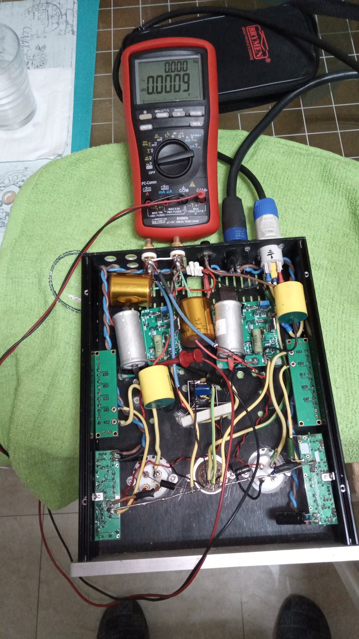

In the vid, why does the meter show frequency less than 10 Hz? If it is AC ripple, it will be a multiple of 50 Hz, right? Maybe the meter should try to measure at 50 Hz or 100 Hz.
More importantly, do you hear hum? 800 mV of ripple will be audible.
Try this using the meter: measure AC input voltage. Should be 220V or whatever is the voltage in your country (use extreme caution when doing this and read up on tube safety guides here and elsewhere). Then using the same setting on the meter, clip it to the output RCA. What do you measure? This is ultimately what goes out of the preamp. The gyrator has very good supply ripple rejection.
If you want to know what your PS is doing and compare to the sim, then clip it to the gyrator B+ input and see what it shows.

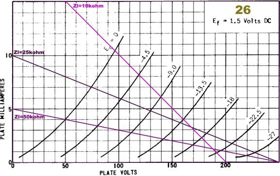

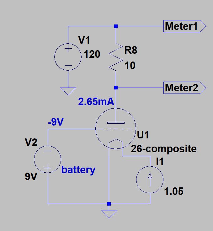

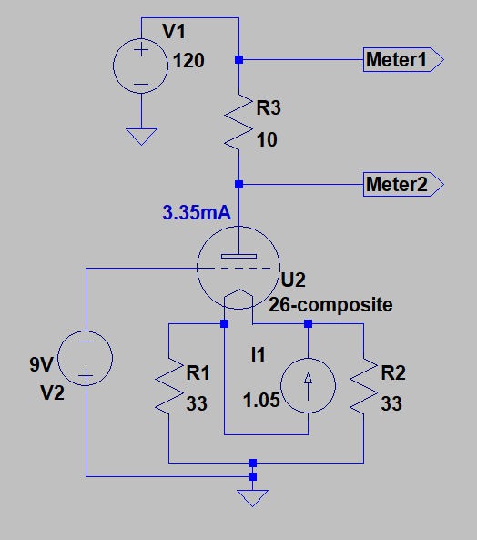

I have two valve with high difference in the anode current, one with 3mA & the other 6mA (bias set to 120V B+ and -9V), I'm using filament bias & want to know what's the best approach to match both 26?
1-The tube with anode-current high reducing the B+ to get 5mA & increase the B+ of the tube with anode-current low to 5mA.
2-Look for another tube to match same or similar anode-current.
TIA
