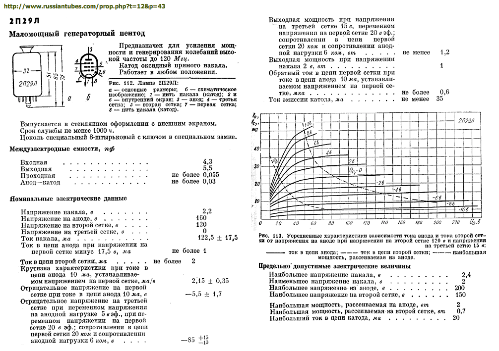

Hi Andy,
What I do not have is data on the 2P29L valve...Ra, mu, and other pertinent data (other than Ale's mu tracer plate characteristics)...can you help with that? I'm interested in building a line stage.
Best, Robert

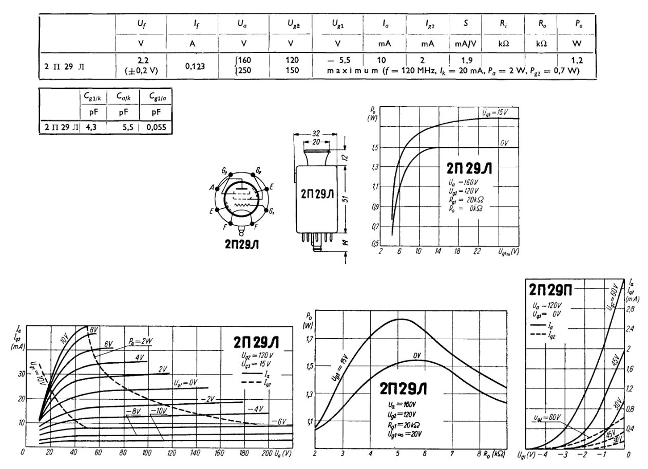

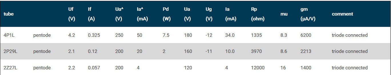

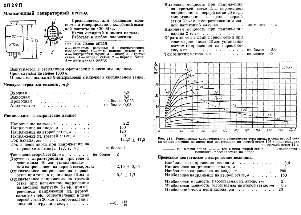

This is what I have. You should be pretty happy with it. Using a choke allows you to put some current through it, like up to 15mA. I like good chokes!
For stocktrader: How is this better than 12AX7 or 6992? You would have to listen to it with your own ears. A lot of us build with directly heated triodes or trioded pentodes because we hear a nicer sound. If you're following this thread you probably have some curiosity to try a DHT.
euro21, Andy, Grazie mille for the 2P29L attachments...mystery solved! No excuses now...I'd better get to work. Best, Robert

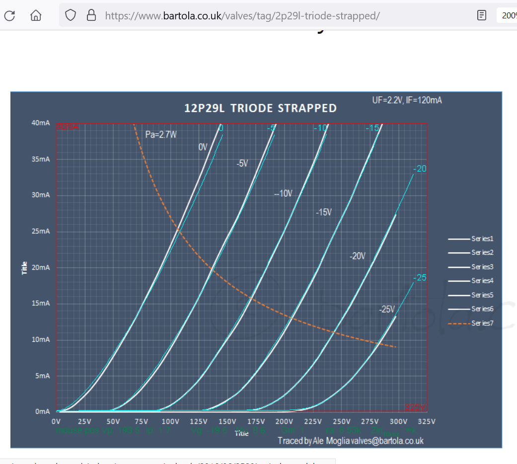

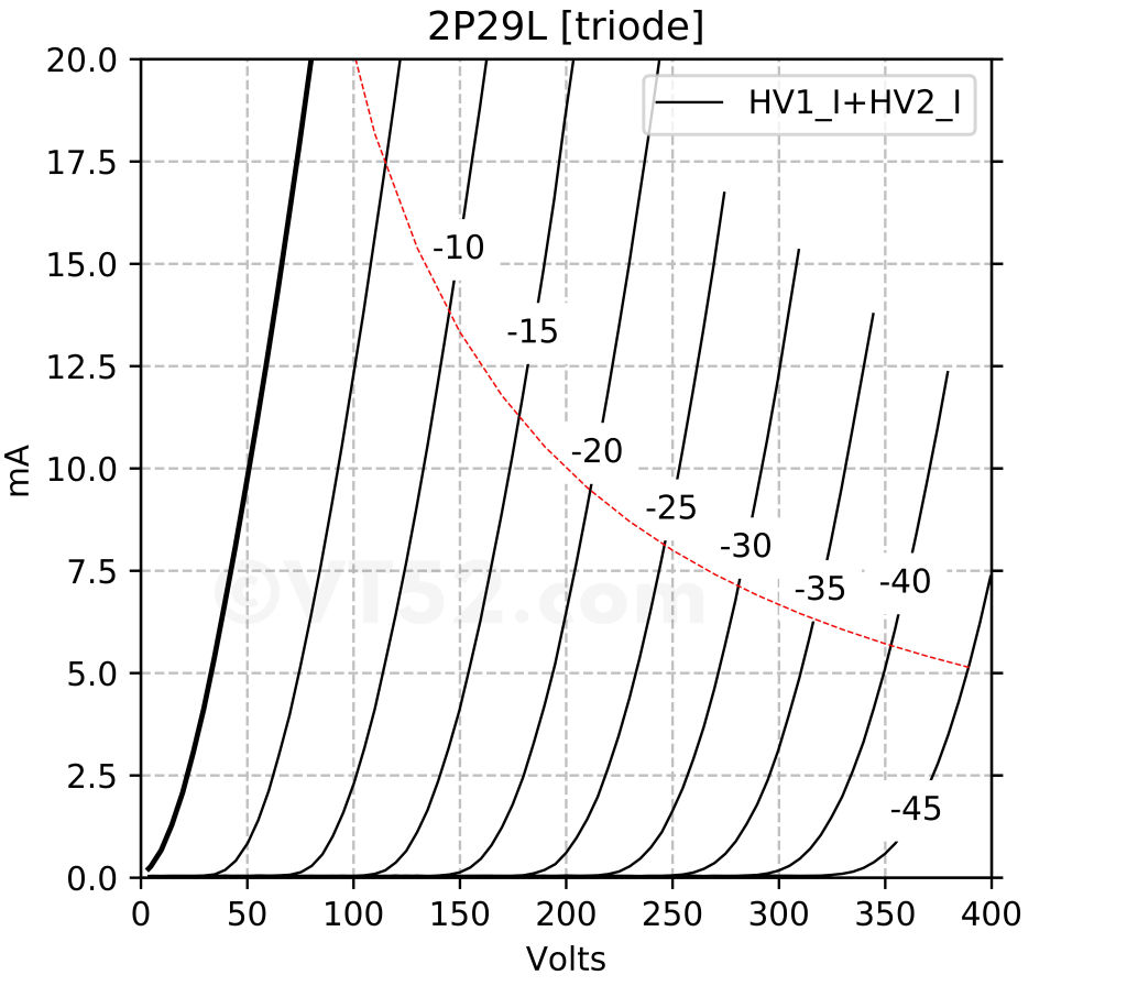

2P29L Triode Anode (or Anode + Screen?) Dissipation Limit?
Ale's muTracer anode characteristics plot (Attached) shows a power limit locus to be at 2.7W. The two attachments in euro21's post #5145 show a Pa of 2.0W. Is the difference between the two the dissipation of the screen?
Thanks for any elucidation you might provide...it does make a difference to selecting a design point. Best, Robert

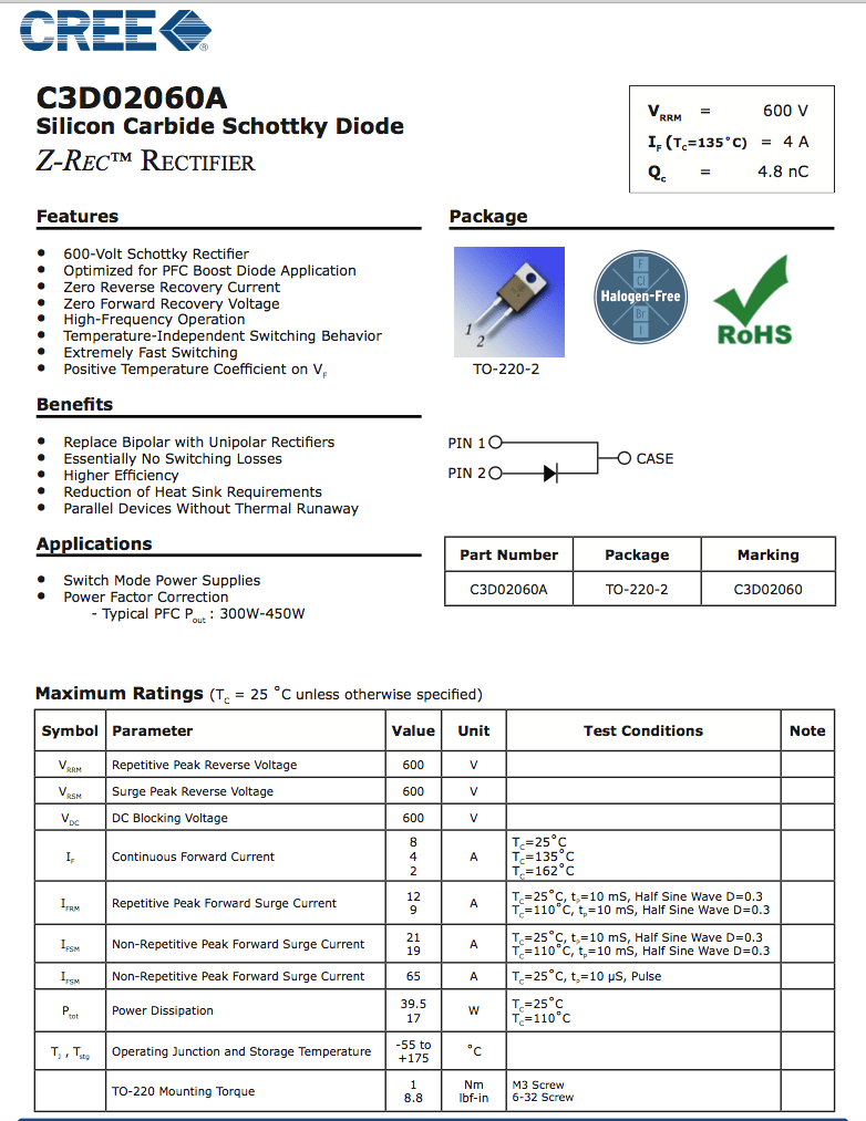

Andy what value & power rating do you used?So one of the ways of configuring the input tube is one or two SIC diodes together with a resistor. The resistor feedback takes a bit of the slight edge off the diodes alone.
TIA
Felipe
I use these diodes but there are other SIC diodes available. Voltage drop is 0.8v at these low currents like under 10mA. No need for any heatsink. I can't guarantee that SIC diodes sound good with all tubes - it's very tube dependent, some like it some don't to my ears, no idea why. I think adding a smallish resistor helps because they can sound a little aggressive - harder leading edge to sounds. They do have other virtues, though.
I use the same ones, if I remember well 5 diodes per tube to have near -6V at grid. I want to try the resistor trick to know how it sounds what don't know the resistance value nor the power rating needed or better how to calculate?
It's just a question of experimenting using Ohms law. I haven't listened closely to alternative values of resistor. As a general idea I'd try something between 50 and 100 ohms, then listen to it and see.I use the same ones, if I remember well 5 diodes per tube to have near -6V at grid. I want to try the resistor trick to know how it sounds what don't know the resistance value nor the power rating needed or better how to calculate?
If you are using filament bias you'd get a very different value resistor from standard cathode bias. You probably don't need to use a diode in filament bias, but you could try it.

I'd stay at more like 7mA and 180v. I've run it there for a while. But why run an old valve like this at more than a comfortable level which would prolong its life?I wouldn't go past 10 mA and 180V.

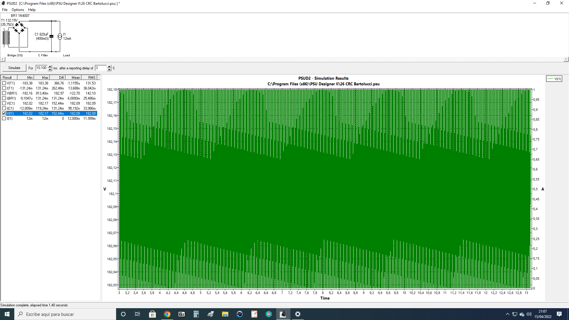

I'm measuring with my new toy DVM Brymen 869S the B+ AC ripple, but the voltage jumps to 900mV & drops to 700mV always and don't be stabilized with time also measure some weird frequency not 0Hz, the PSU it's a simple bridge rectifier 1000V 25A with a capacitor 820uF 550VDC. Of course no AC ripple when load isn't connected. I expected an AC ripple like the PSUD2 attached simulation. TIA for help & support.
