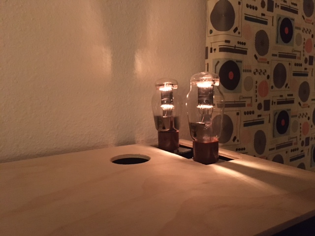

Been using PSUD2 to sim some rectifiers. There are many options. Is there a suitable one where there is not so much loss of voltage? The type 83 was attractive because, apart from the glow, it did not lose a lot of voltage. Would be nice if it compliments the look of the vintage globe tubes (26/01a/801a).
Meanwhile, here is a pair of 10y tubes in operation using the same basic circuit as the 26/01a. They produce some truly astonishing sounds. The very air seems to be charged with the atmosphere of the recording.

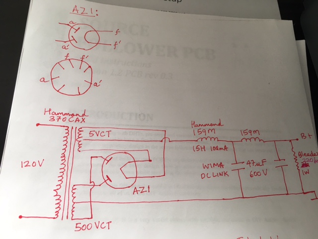

Another diyer had asked for my PS diagram over PM. Attached. I'm hardly an expert, so please feel free to suggest improvements. It is based on the supply that Amandarae showed in earlier posts (around page 500).
You won't get anything better than 10Ys with an AZ1/AZ11 mesh rectifier, or if there is anything better I haven't found it in 12 years of building with DHTs. Arguably 46, 47 or 49 but the 10Y can be used in filament bias so no cathode bypass cap. A nice big choke input filament supply and Rod's regs and you're good to go.

AZ1 is roughly equivalent to the AZ11 and RGN1064, slightly different C1 specification but about the same current capability.
If you want to replace a bridge with 4x AZ1 you also need 4 different 4V windings.
But once you use the sallas shunt you go from high impedance to a low impedance supply. In which case the rectifier tubes are nothing but glorified lightbulbs that rectify.
V4LVE
AZ1 is roughly equivalent to the AZ11 and RGN1064, slightly different C1 specification but about the same current capability. If you want to replace a bridge with 4x AZ1 you also need 4 different 4V windings. But once you use the Salas shunt you go from high impedance to a low impedance supply. In which case the rectifier tubes are nothing but glorified lightbulbs that rectify. Cheers, V4LVE
I use 2 x AZ11 in parallel. So just one 4v supply. And a hybrid or Graetz bridge with UF4007s for the negative side.
You're right - I should build a Salas reg. Everyone raves about them.
