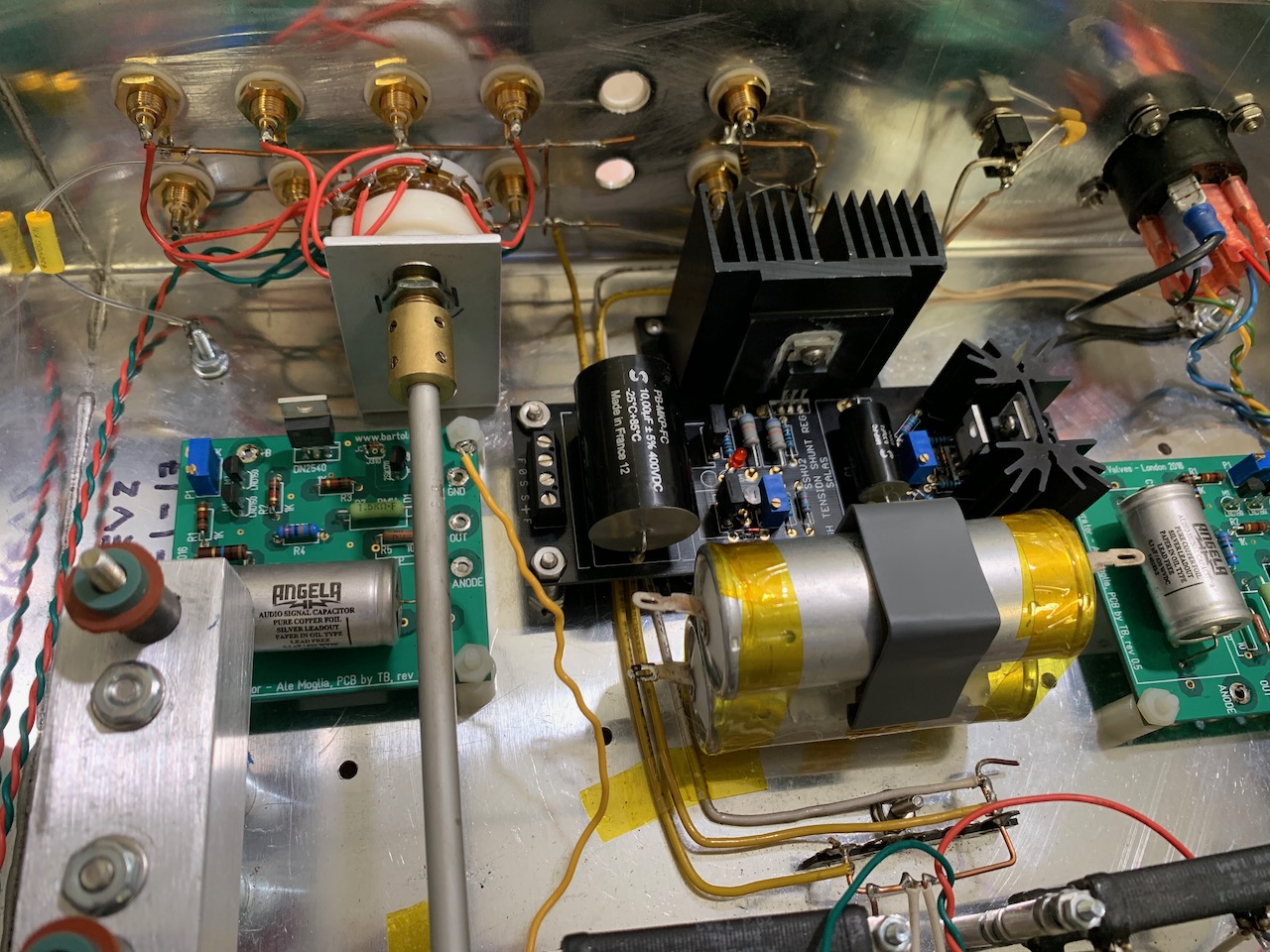

Just for your info, I will use Salas SSVH2 to regulate B+.
Appreciate your hints.
Mutuano
I am using the Salas HV shunt board with great results!

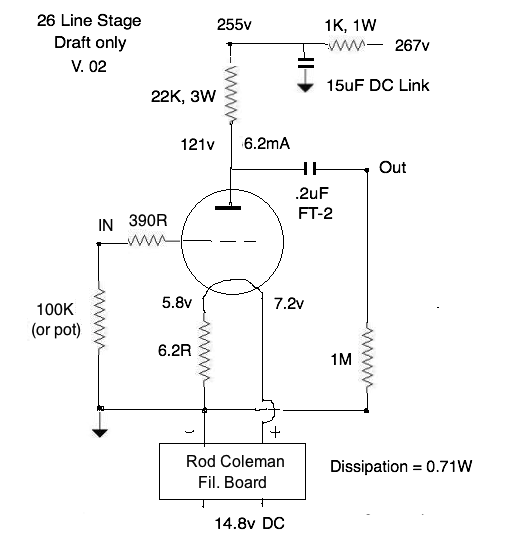

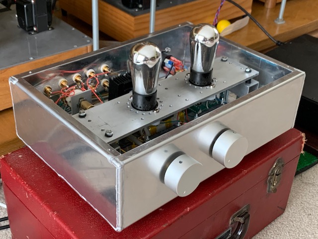

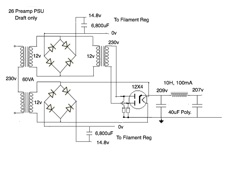

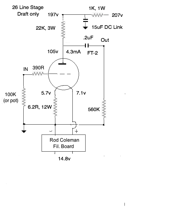

Here's a simple 26 preamp I built not expecting too much, but it sounds very nice, nicer than I expected. I used back to back transformers in the PSU because I had some. Values are mostly correct, but I've done some tweaking since writing down the circuit.

Hi Andy,
I used a 22k resistor on the anode of my 26 pre for quite a few months. I can’t say for certain that it wasn’t my favorite iteration so far. Simple, cheap and it works wonderfully as long as one has an amp with a fairly high input impedance.
Has your 6R2 cathode resistor stayed the same? Or was that changed in the tweaks?
John

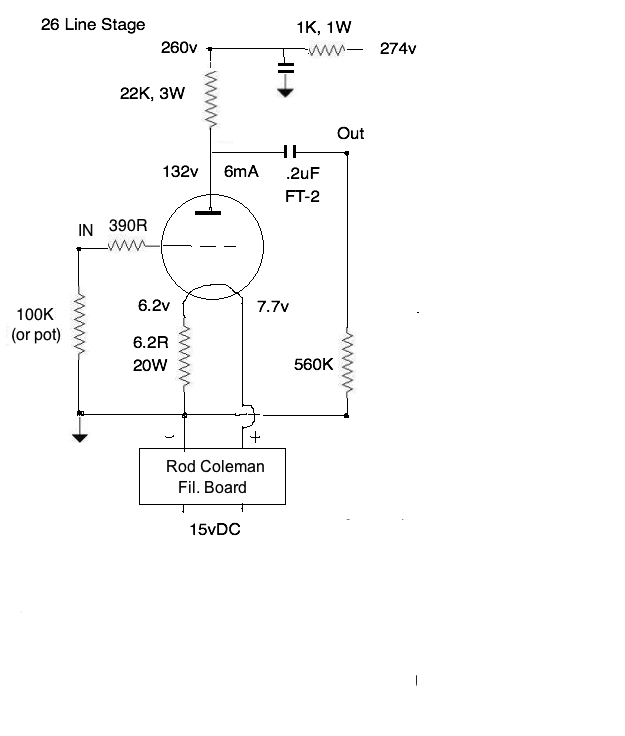

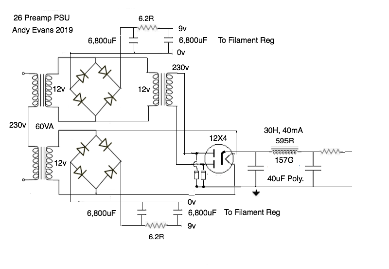

Here's the actual circuit and voltages. The HT is lower than I'd like and needs to be looked at. Alternatively a plate choke could be used with the HT as it is. With the resistor the current is 4.3mA and it would be better to raise this to 6mA. However, it does actually sound pretty nice as it is.

Hi Andy, ingenious use of junk-box transformers! But I think it will sound best if the filament supply winding is completely separate. The might be some noise coupling, if the raw DC has any iron in common with the anode supply.
Hello Rod. It is indeed my ingenious junk-box build, not that transformers are cheap! What I've used, however, is easily available at good prices from CPC, Farnell, RS, Rapid etc. Doesn't need special transformers for tube gear, just the common items.
Can you estimate the extent of the noise coupling? Are you suggesting something audible?
Hi Andy, So, this is the preamp du jour. How does it compare to your 10Y/VT25 preamp du jour of 21 November 2017 in message #4508? And this one has no plate choke(s), how come? Did I miss any between then and now? Best, Robert
Hello Robert. First thing to say is I never use a preamp. I only use a 2 stage amp. So these "preamps" are vapourware, they don't exist except as transient builds. I do build 26 preamps for others in a very limited way. For my own use a 26 or 10Y stage would only be useful for driving a high gain final like EL38 or EL12. I flirted with that combination last year but this year I'm using and very much enjoying 6C4C/6B4G finals. The driver stage needs a mu of 30 at least, so no place for a 26. So my stocks of 26, 01A, 46 and 10Y are basically part of my pension fund. I never use them.
Yes, I prefer plate chokes, even a humble Hammond 157G. But a resistor load can sound good in a basic design. I'll always prefer a 10Y or a 46 to a 26, but once you're using a good DHT the sound will be there.

Another Improvement to These Schematics would be...

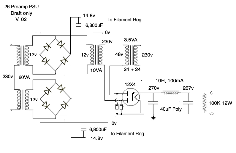

Here's an improved schematic. I added a 24+24v transformer to boost the HT. The voltages and operating point are now closer to what was intended.
Andy, You've posted PSU schematics in messages 5122, 5124 and 5128 and in none of them can I figure where the connexions are located. How about some *black dots* where there are connexions? Otherwise...vapour.
Cheero,
RC
Andy, You've posted PSU schematics in messages 5122, 5124 and 5128 and in none of them can I figure where the connexions are located. How about some *black dots* where there are connexions? Otherwise...vapour. Cheero, RC
I should not really have posted my power supplies - I was just using up parts I had. Since most builds will use a "normal' small mains transformer with the right HT, I leave it up to builders to work out their power supplies in a more conventional fashion.
