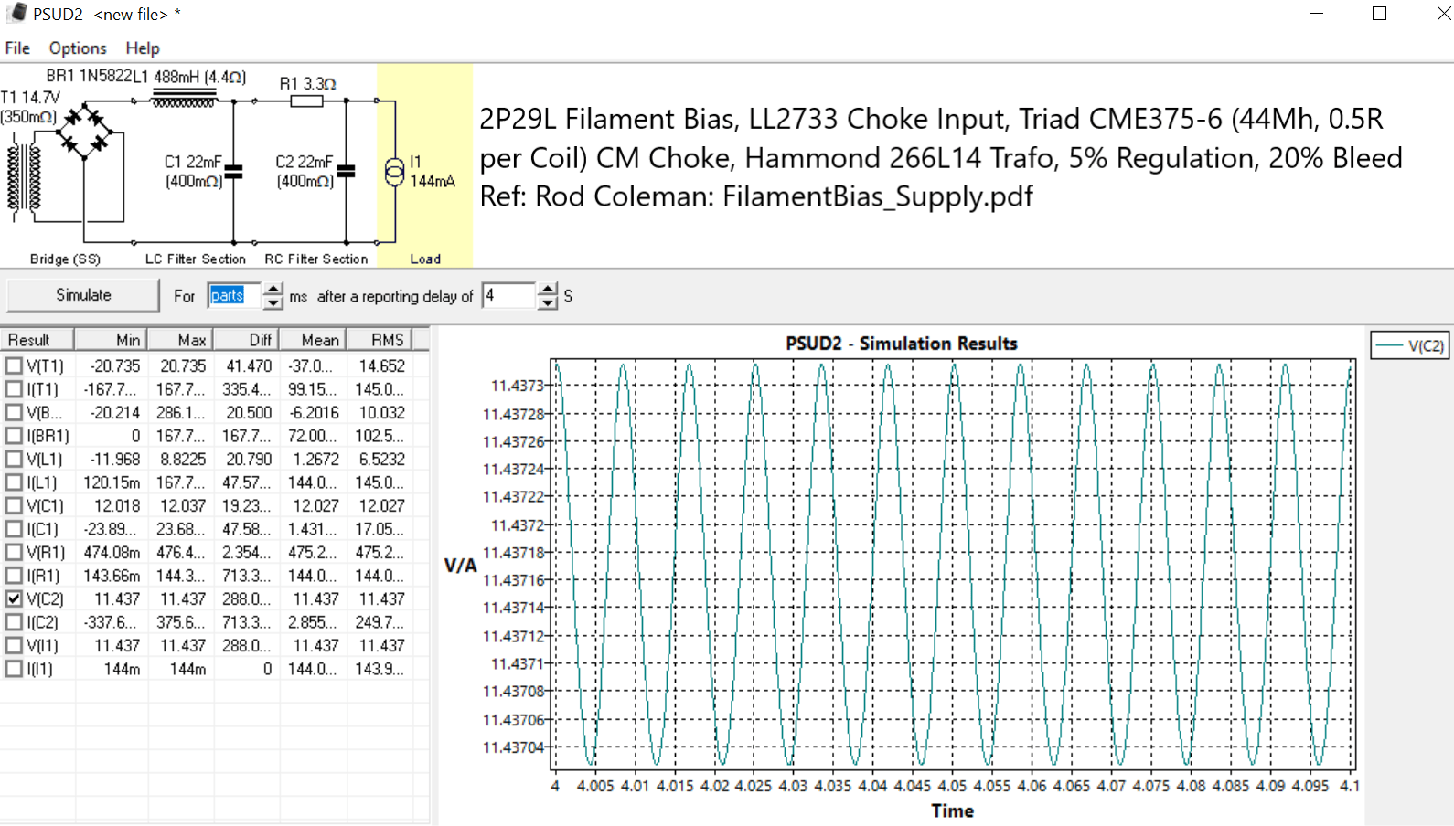

I did not include a bleed current/resistor in the previous post...should be there. I'd say ~20% of current would give a resistor of 560-600R.
RC
Updating myself...I have added 20% of the previous current in the PSUD2 case. I have also checked and found that the common mode chokes for the raw supply are 44H per coil, so have updated the inductance entry...assuming that the resistance per coil is ~0.5 ohm. If everything is as it was when I did the last determination of the bleeder, it should be 470R.
I still have to check my assumption of 5% regulation for the Hammond trafo, 266L14...I have these to hand and will try to see how it powers up unloaded to get the real regulation %.
Best ! RC

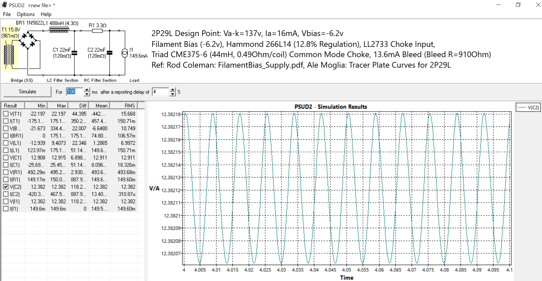

Here's my PSUD2 for the 2P29L with updated Hammond 266-L14 regulation. I found that I could not get to 9v bias, but that I could get 6.2v bias. Rod, if you're watching this, could you please comment? This seems to be consistent with your private comment to me about the biasing the 2P29L:

Best, Robert

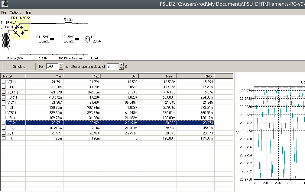

Robert, Please remove the choke, to get the desired performance. At 120mA load, there is little benefit from choke-input supplies anyway, so long as the PT→Diodes→Capacitor wiring is made according to the RC-V9 regulator's manual.
If you do that, you can get as much as 21V DC from your 266L14.
If you are targeting 9V bias and the 2.2V of the filament voltage, set the DC input to around 16-18V (extra headroom for very low-current filament bias allows wider adjustment range, and the low current does not burn high power in the regulator's power transistor).
To reduce the voltage from 21V, you can simply increase the value of the dropper R (R1 in PSUD2; R2 + R3 in the Raw DC board).

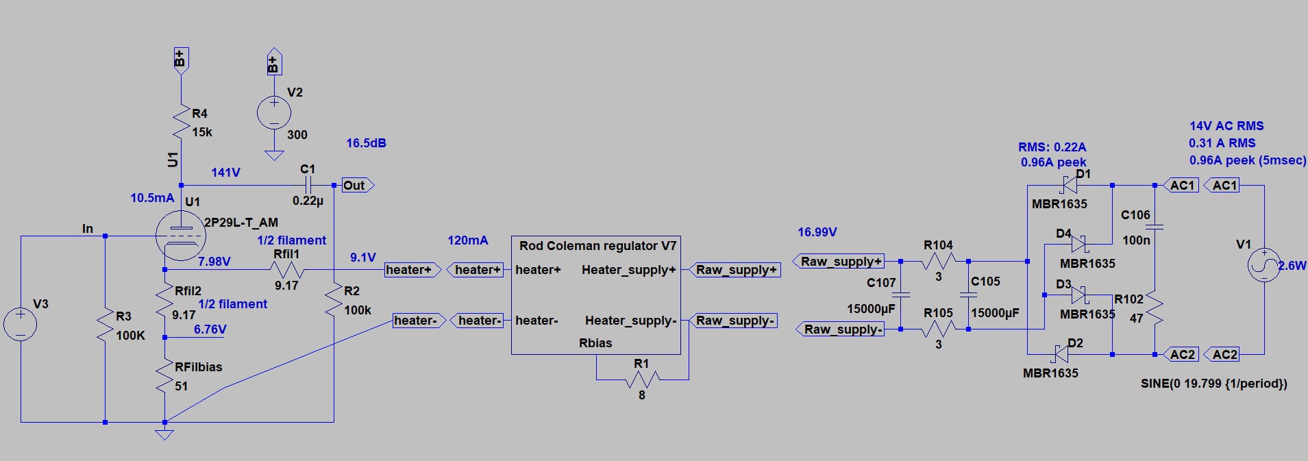

12.38V raw DC voltage is inadequate for R.C regulator (4-6V depends of version) + 5V filament + any voltage on filament bias resistor.
Hi euro 21, Rod,
Thank you both for your thoughts on this.
I was using 4V headroom, V8 boards and the 2P29L Triode filament is 2.2V, 120mA, not 5V filament. 12.4V - (4V+2.2V) = 6.2V bias. Ia + 120mA = 136mA through the filament bias resistor; Rfb=45.6 Ohm. No? Am I missing something?
Best, Robert
Voltage on filament bias resistor:
45.6Ohm*136mA= 6.2V
6.2V + 2.2V + 4V (R.C. headroom) = 12.4V
If R. C. V8 board working well at 4V headroom (I like greater values), it's OK.

Estimated bias voltage is about:
6.2V + 9.17Ohm (half of filament) *0.136A = 7.45V
BTW I afraid that 16mA (trioded) current and -7.45V operating point is over the dissipation limit.
If you raise the filament bias resistor to 50-51 Ohm, the current would be decreasing, and dissipation too (10-12mA anode current).
The choice of the operating point depends a lot on type of anode loading and required anode voltage swing.

Hi euro21,
Are you saying that the mid-point of the filament should be the "bias voltage" reference point? I have to admit that I am a bit confused on this, so any elucidation would be appreciated., there's a + end and a - end...where is the real bias?

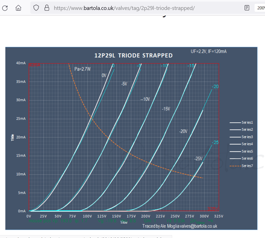

As regarding the anode+screen dissipation limit, my knowledge of this is that the limit is 2.7 Watt per Ale's traced plate characteristics, see attached. I do not see that "16mA (trioded) current and -7.45V operating point is over the dissipation limit".
In the case of filament biased DH tube the "cathode" (grid is more negative compared to the cathode) is indefinite. The best approach as "cathode" is the mid point of filament.

ISO plate choke is good at series connection (160H, 1160R DCR, 20mA) with 160V B+.
LL1660 is only 100H in Alt Q (4.5:1) configuration, so it's 12k57 impedance at 20Hz. For -about- 3k anode impedance tube it's -just enough, not too much.
