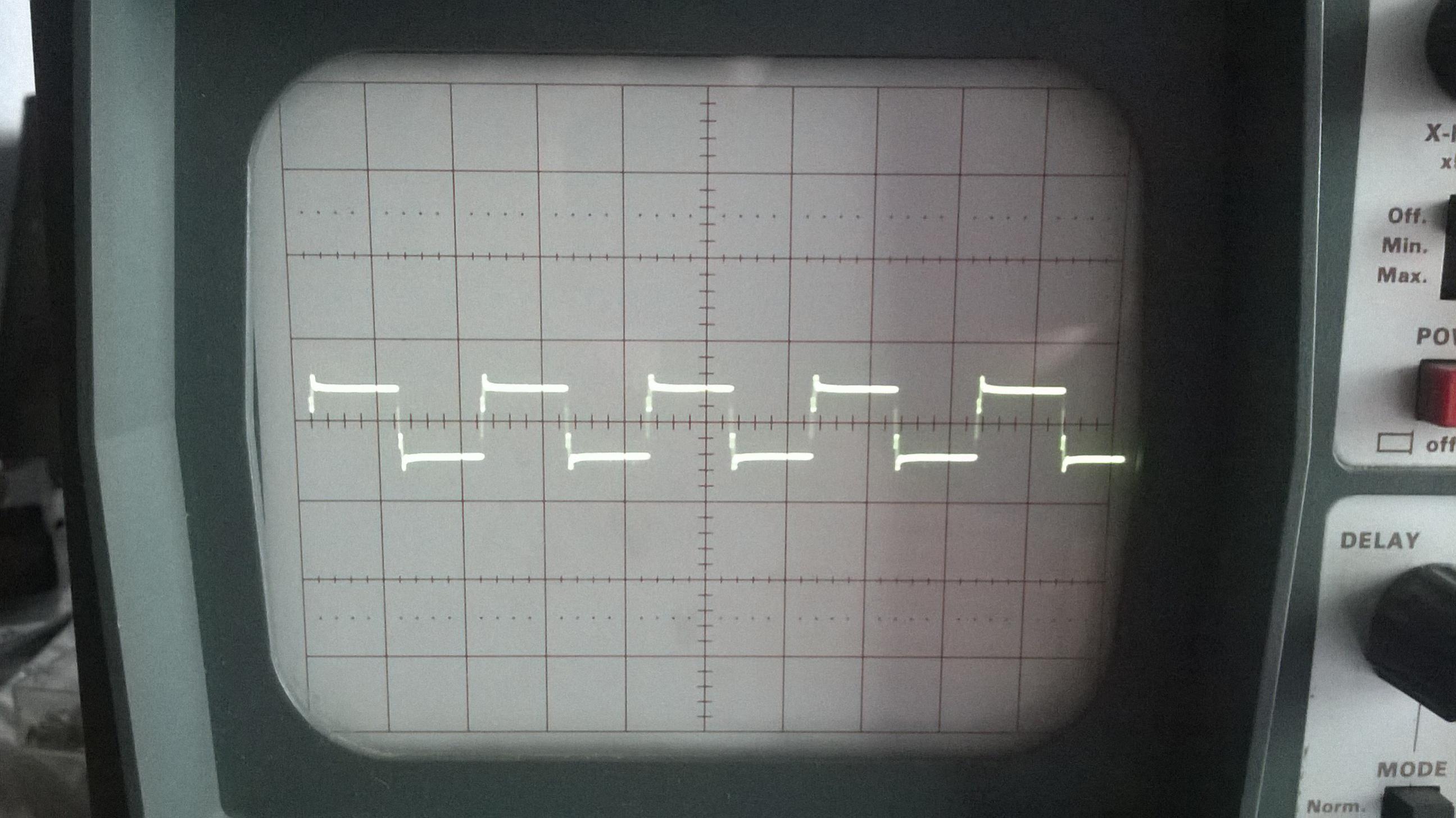

I may have stated that badly. I meant they were all "dirty". Not experienced with this, unfortunately. I expect someone with experience could tell quite a lot from these traces, but I can't!
This is 100Hz.
1kHz.
20kHz.
I don't think you will ever get nice square waves when you measure as high as 10-20 KHz. Output transformers simply do not like that. However I'm more interested in sin waves. How is the frequency response? Do you have anything left at 20 Hz relative to 1Khz?
I'll try to get to it today. When I had a quick look the other day and saw these traces, the sine waves looked OK. I will run it through the whole frequency range, and beyond, sine and square, before and after the output transformer, to get a bit more understanding. Should I try different loads on the output? How low could I go? My Parasound A21 has 33k, but a couple of valve power amps have the usual 100k inputs.I don't think you will ever get nice square waves when you measure as high as 10-20 KHz. Output transformers simply do not like that. However I'm more interested in sin waves. How is the frequency response? Do you have anything left at 20 Hz relative to 1Khz?

Usually secondary loading for a line output is 1k - 10k with heavier loading (lower resistance value) gives lower bottom end and less loading provides less damping. You should try different values, measure and listen since different setup needs different loading and the Ra of the 26 varies quite a bit depending on tube condition. Looking at the very strong +- 80kHz ringing that you have on the 20kHz square wave output, I would suspect a low 1k - 2k2 loading is more appropriate, but you need to try several values. You could even find that less than 1k loading is the best for your setup.... prompts me to ask how to implement the secondary loading.

Don't expect a perfect 20kHz square wave from a transformer. The ringing can be dampened by loading and/or with zobel networks. In my experience this often results in better square wave response but not necessarily better sound. Try and use what you like best

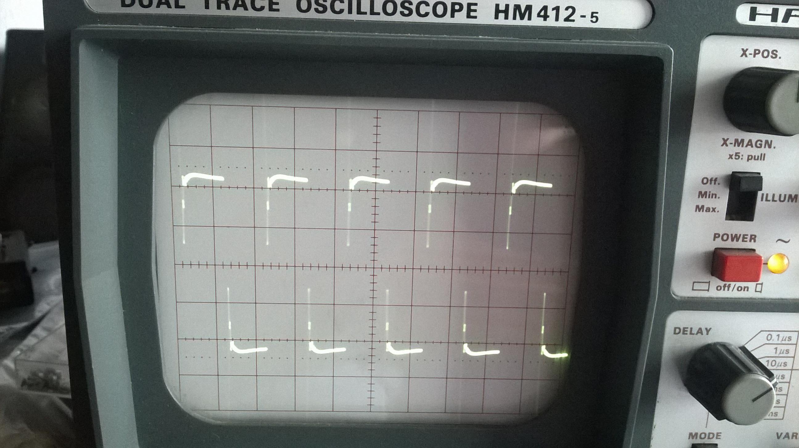

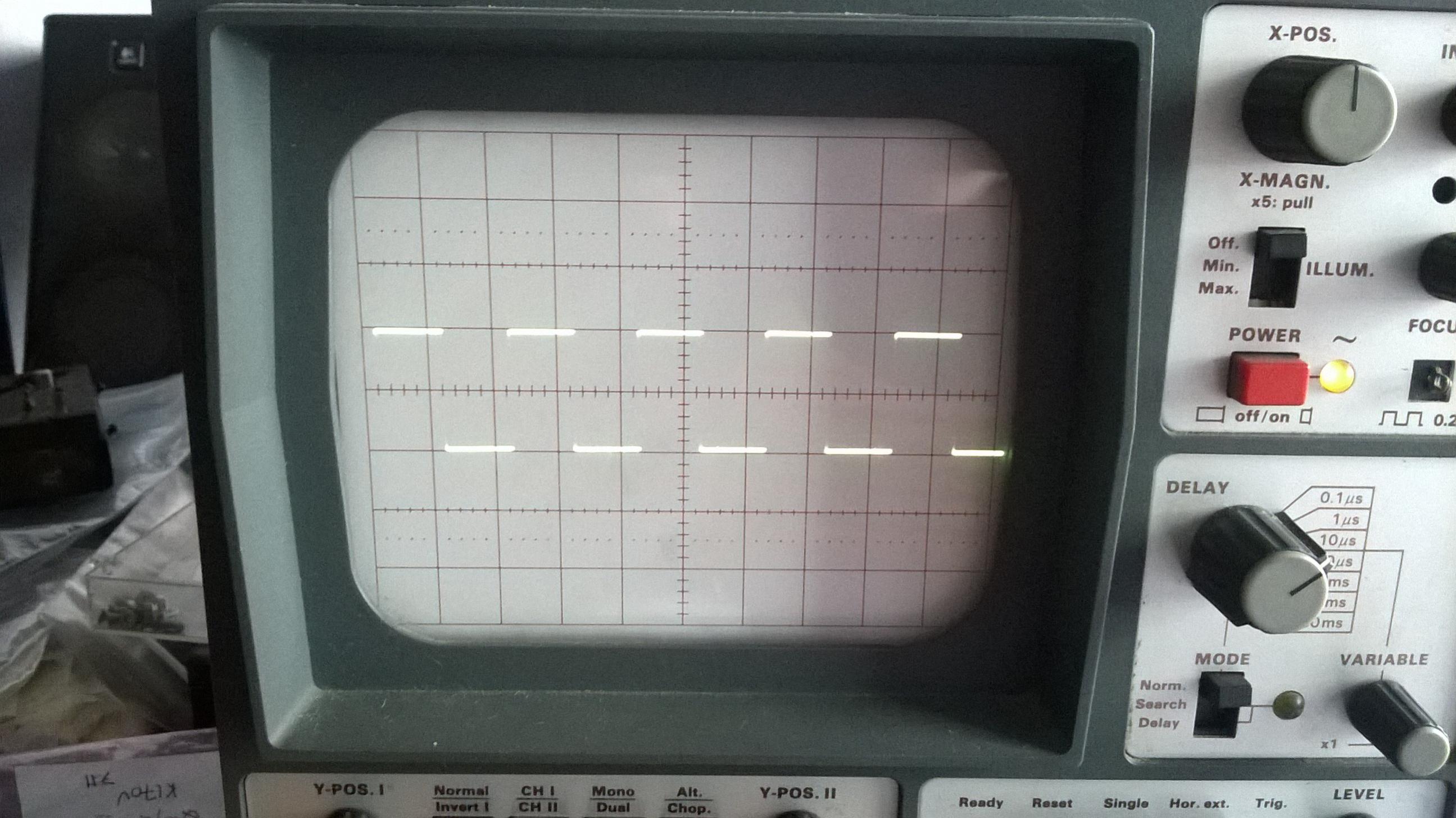

Attached pics 1kHz square wave, one direct the audio generator the other direct to hte 26 tube & the other after the LL1660 configured Alt S 4 : 4.5 SE to SE interstage, as you can see the LL1160 pic reduces the gain😕
You better use sine waves instead of square waves to measure gain.
Your representation of the screen shots is not clear: what is what??
Left direct output 26
Center direct signal generator
Right LL1660 output feed with 681R
