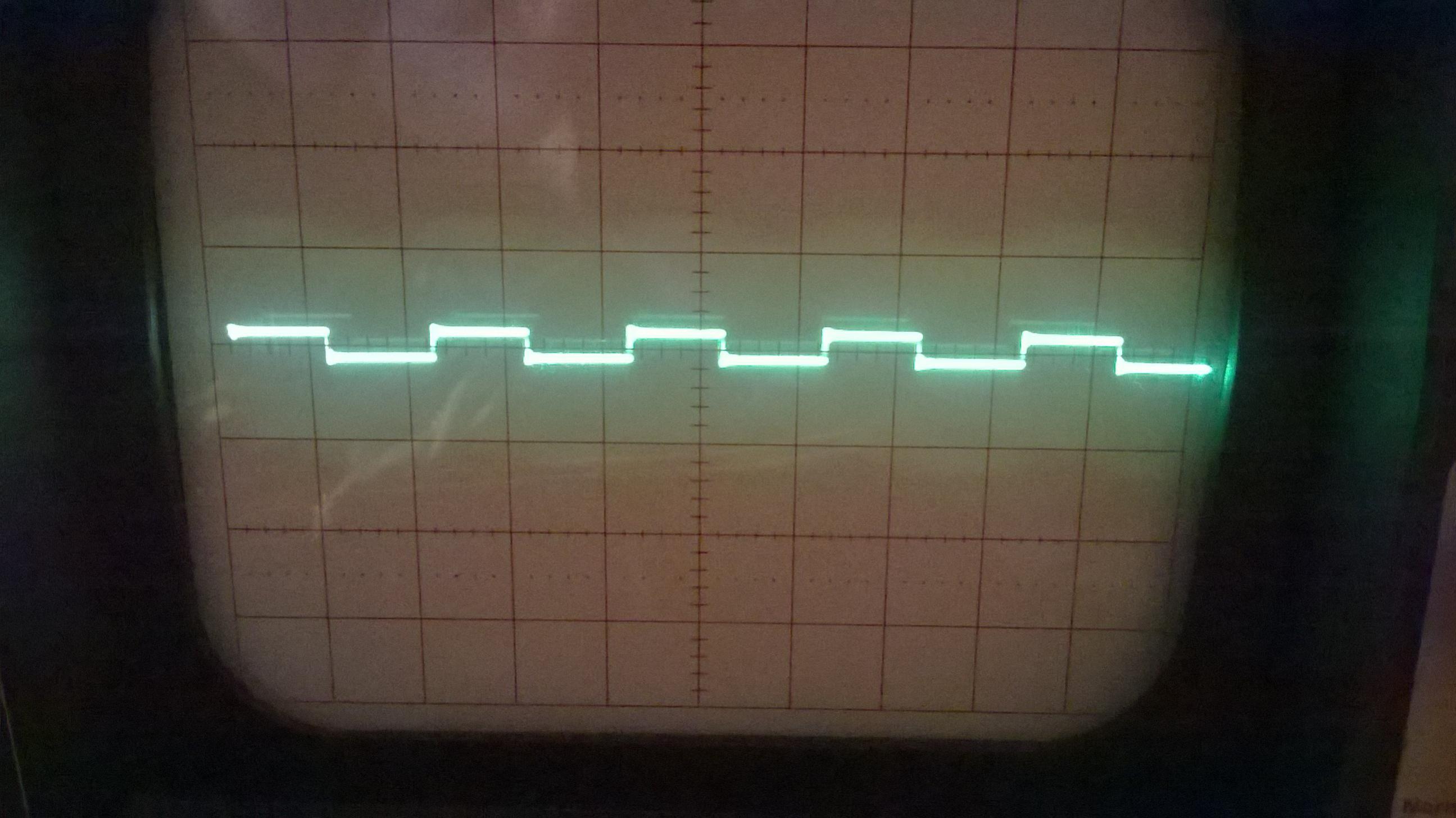

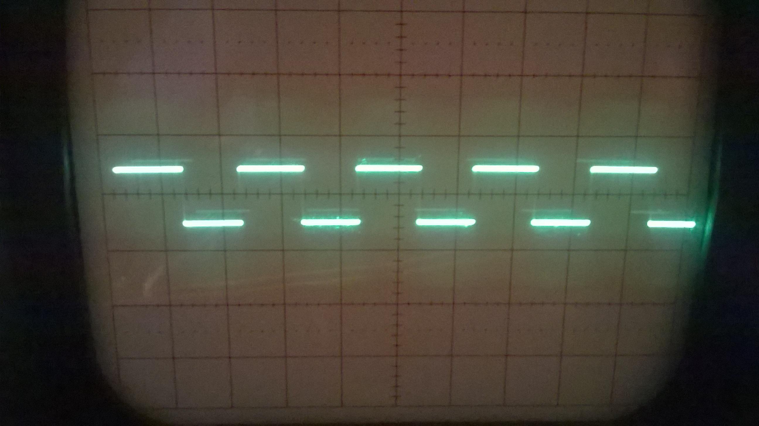

Now here's a thing. I built my 26, by copying the layout of Rui Lourenco's pre-amp, and with a lot of advice. Everything measured OK, 156V HT, 875mA on the filaments, and it sounded clear. But I had a problem with sibilance, no matter what I tried with my speakers, various power amps and cables. When I took the 26 up to the workshop to check voltages with different 26s, I put a TVC in its place. A softer sound, sure, but no sibilance!
I have just bought a 'scope (which I don't really know how to use very well, but can measure waves), and using a cheap Chinese sig gen (sine, triangle and square), I put various levels of waves through the 26, particularly square. The output of the sig gen looks clean enough, but the output from the 26 is horrendous!
10kHz from sig gen.
Same after passing through the 26. 2V output, volume pot wide open.
From 100Hz to 20kHz is similar. I tried loading the output with 33k ohms (same as my power amp); no difference. Admittedly the leads I used are a mixture of BNC to crocs, or RCA, but surely that wouldn't do this?
How do I start hunting down whatever I have done wrong? Using a scope with a sig gen is new to me, so any advice would be welcomed.

Strange looking waves you got there Richard. Sorry for not having a clue of what's going on. Keep us posted on your progress. It should not be possible for the square waves to look similar from 100Hz to 20 kHz....
I may have stated that badly. I meant they were all "dirty". Not experienced with this, unfortunately. I expect someone with experience could tell quite a lot from these traces, but I can't!Strange looking waves you got there Richard. Sorry for not having a clue of what's going on. Keep us posted on your progress. It should not be possible for the square waves to look similar from 100Hz to 20 kHz....

Could you check frequency bandwidth with the sinus generator?
The 100 Hz square wave shows that there is quite some low frequency loss.
The 20 kHz square wave shows resonance; check 20 kHz and higher (up to 100 Khz to see where these resonances are, and how severe).
By the way: don't expect great results anyway with a high Rp tube (Rp of 26 is some 8 k) in combination with a step down transformer.

Looks like transformer resonance peaks.
Looking at the LL2745 specification
http://www.lundahl.se/wp-content/uploads/datasheets/2745.pdf
It expects to be driven by a 3500Ω anode, the 26 is somewhat more than that.
You may be able to tame the (frequency) peaks with a network on the secondary, e.g. a R-C series (zobel), or by an even heavier load.
I would send your scopeshot and circuit to Lundahl, and ask. This should be the way to get the most accurate advice.

Seems like there is modulation in the output signal. Trying connecting a cap of about 0.22uF at the plate of the #26 tube and see if the waveform is the same
Thanks for all the replies. I will try all those suggestions; I only looked at this last night and haven't gone any further without some advice.
I bought the Lundahls from Thomas Mayer; they should be the 8mA version, I believe. I can only assume they are correct. They are connected for minimum output impedance, Alt R, as I don't need the gain.
vt4c; would that be in series, between the plate and the transformer?
One terminal of the cap connects to the plate of the #26, the other terminal output to the oscilloscope probe. This way, it will show if the modulation is due to the output transformer
