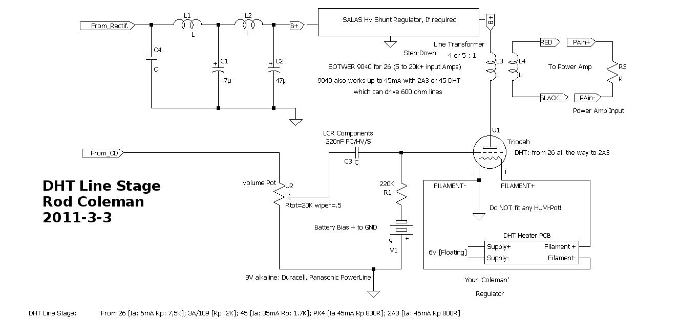

Rod Coleman Regs with filament bias using 10ohm Ohmite brown devil resistor.

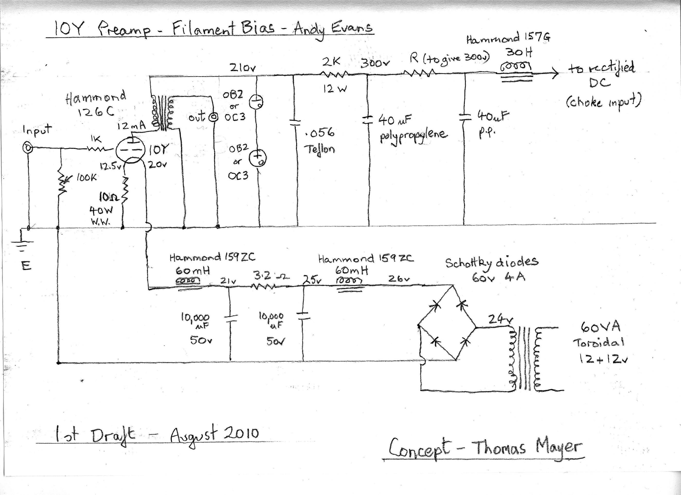

Same question with filament PSU - what value would you suggest for last resistor and capacitor in the CLCRC chain? At the beginning I had 0.1R with 10uf cap, but once more the current flow looks bad in Duncan PSU comparing to 1R with 47uf.

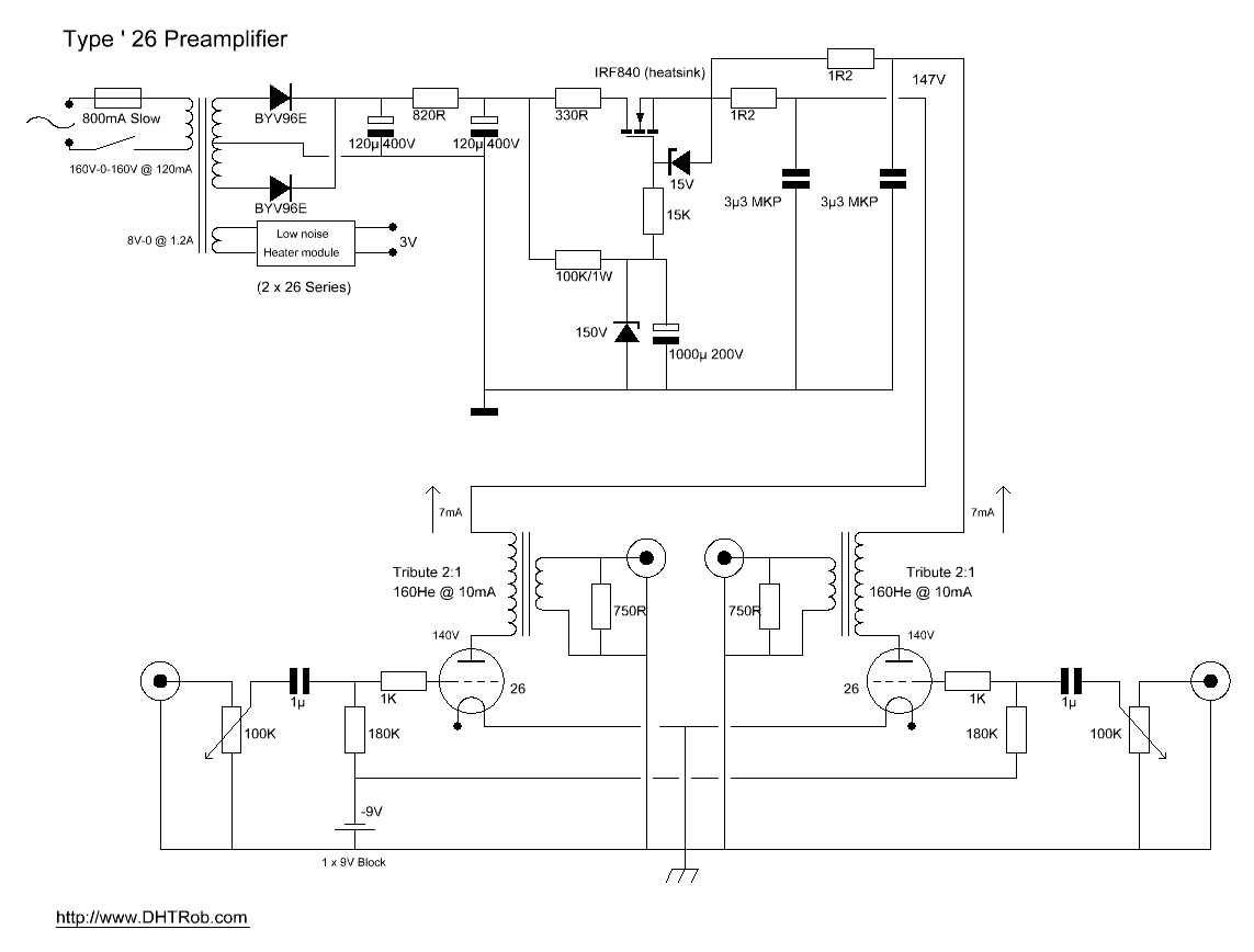

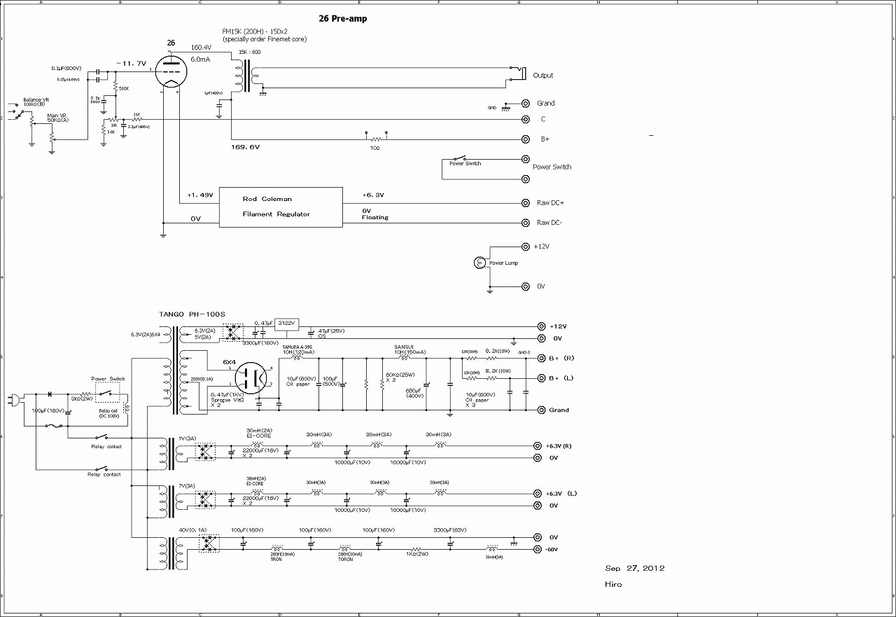

Hiro attached schematic connect to output ground RCA & to chassis?
