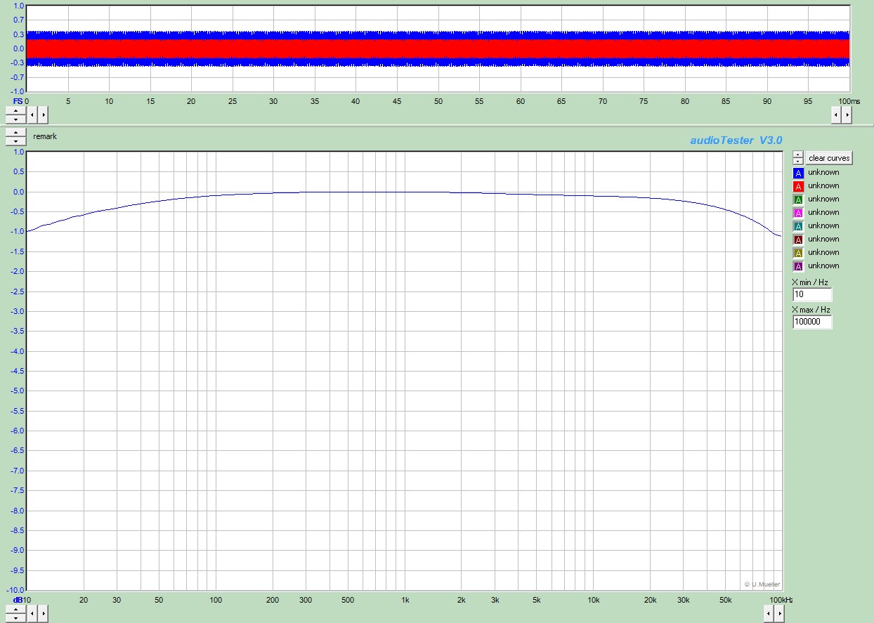

The first picture is my -Ale's gyrator loaded- 801 preamp curve: -1dB 10Hz..85kHz.
(21mA compensated...).

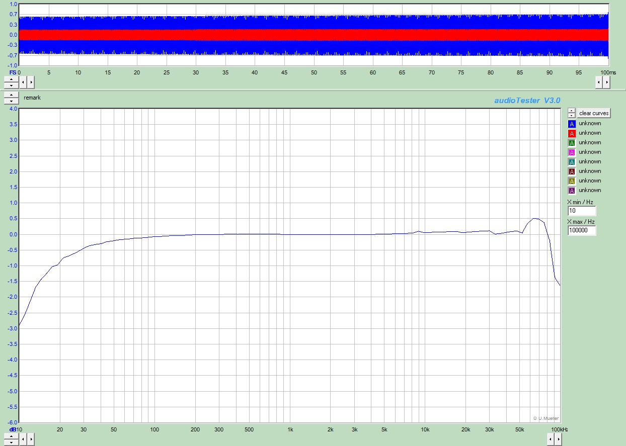

The second picture is my daily used (CCS loaded, C coupled) #26 preamp measuring.The 65kHz "bump" is due to my -parafeed coupled- 400H S&B TVC.
