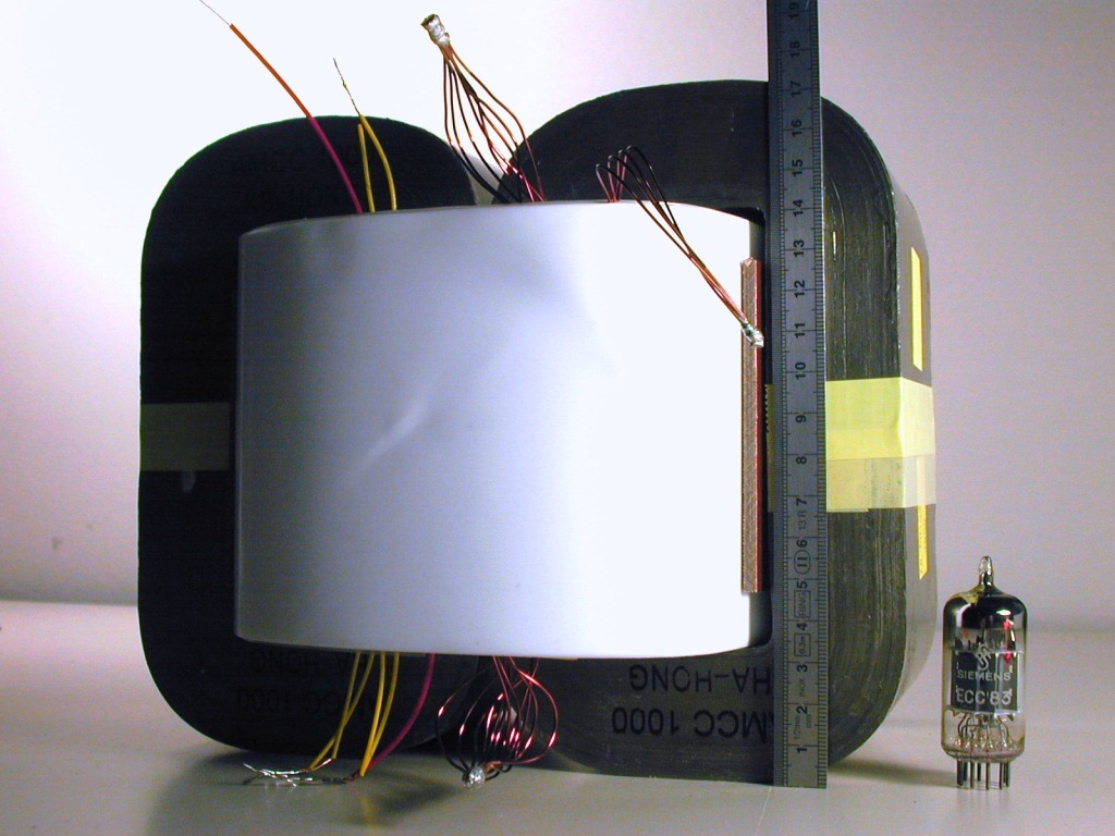

P.S. Who am I to object, I'm paying $5k for OPTs!

That transformer is massive!
