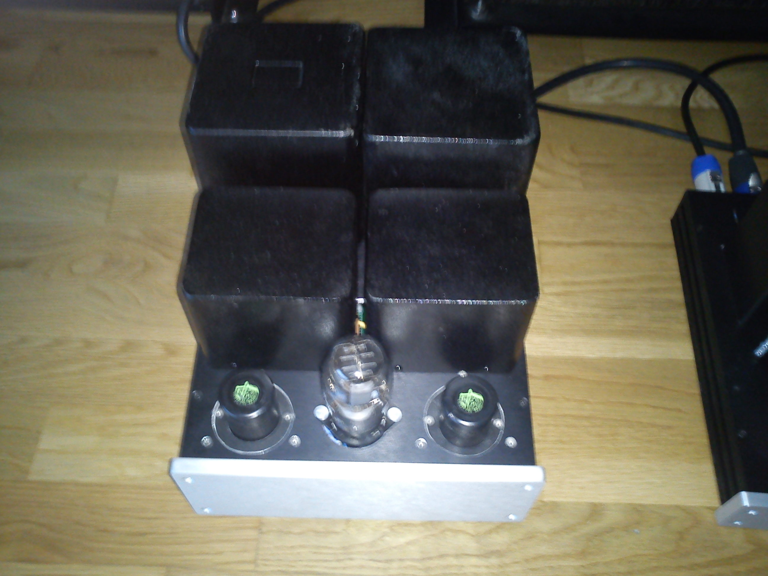

Due to lack of mid-bass & bass using two 40uF ASC MKP in oil as AC mains filter I changed to BG, I use with ASC & BG L-C-L-C each C with BG is 200uF each L is 10H 100mA, improved but I guees still can be improved more, the question is: I use AZ1 but the after the AZ1 isn't direct to a cap so can I use 200uF as first cap after the choke? or I have to change to C-L-C-L-C and first cap FT3 0,1 or 0,47uF? can be that 26 need more capacitance to filter AC mains?
TIA
Felipe
Just for fun attached pic with BG
TIA
Felipe
Hi Filipe, if it can be of any use, I use AZ11, with C-L-C-2xL-2xC, where first C is ASC premium (blue cover) 8uF, first L is lundahl 1638 10H, second C is ASC 40uF then splits in two lines with Hashimoto 30H chokes, into two last ASC 40uF capacitors. These lines then feeds 2 Salas HV2 shunts, one by chanel.
Sound is great and DEAD quite!
Hope I could help, good luck for your building.
Cheers.
Thanks for let me know what are you using, AZ1 specs says 1st cap max 60uF I guess isn't my case because 1st component is a 10H choke.
My 26 is also dead quite can be that I have to look for in other directions like the Legato is only giving 1.5VRMS in place of 2VRMS & 26 only have a gain of 6 dBs but when used the two ASC 40uF I didn't have the sensation of weak of power, the sensation was weak of mid-bass & bass so a sound extremely analytic, clean, fast and direct.
The bad sound was the ST tubes, now I use globe tubes and sounds right🙂
