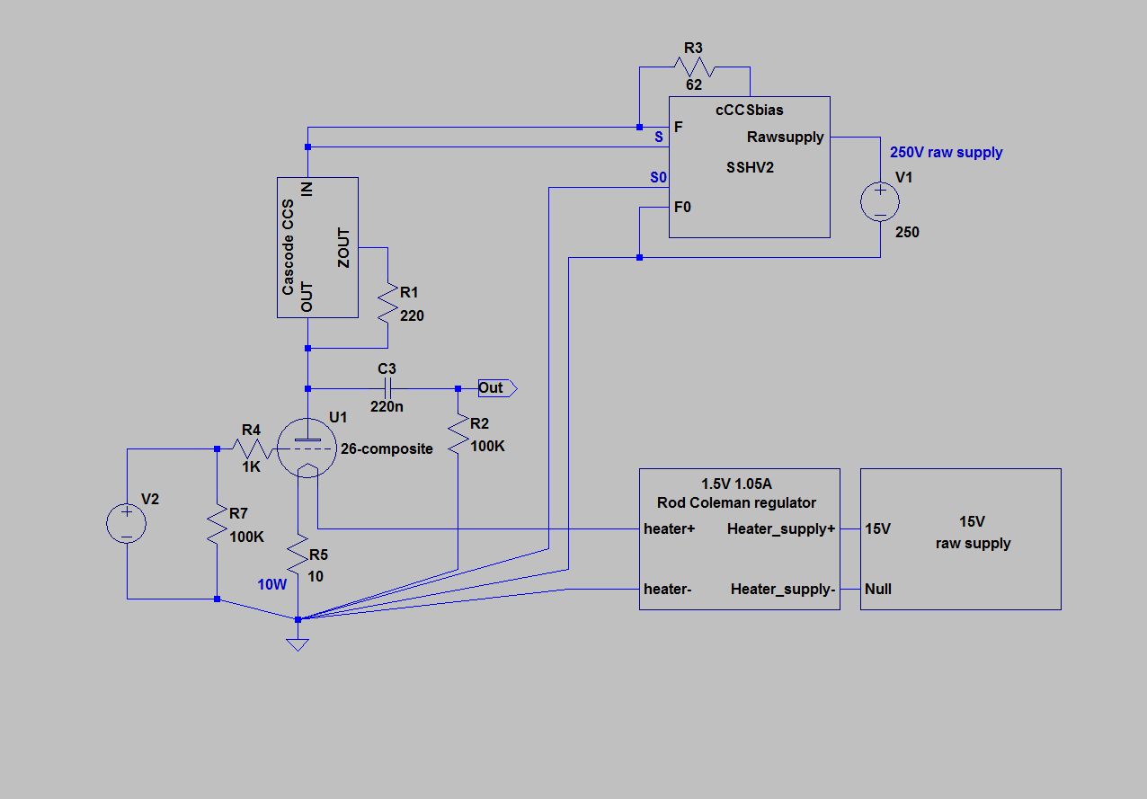

Ok. I will need to draw it...
But 1meter away I can hear nothing...
I will need to looks for magnetic coupling from other devices,
I have all my components open and testing, so It can be only that...
Will keep you posted...
On sound the 26 is really something special, so sweeet...

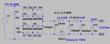

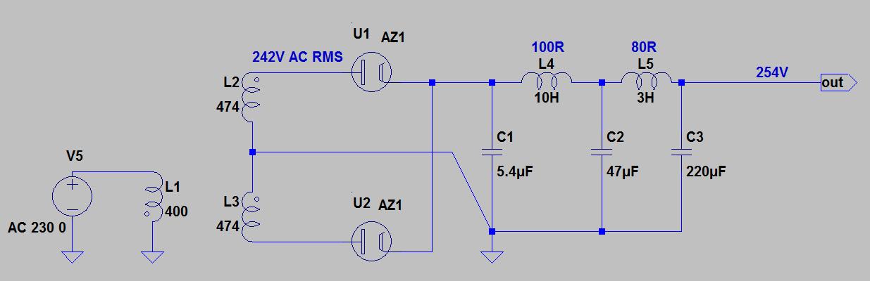

This is my #26 pre wiring scheme.
Two box layout (1m distance). The PSU box contains 250V (CLCLC) raw supply, the two SSHV2 (220V), and two 15V DC heater raw supply.

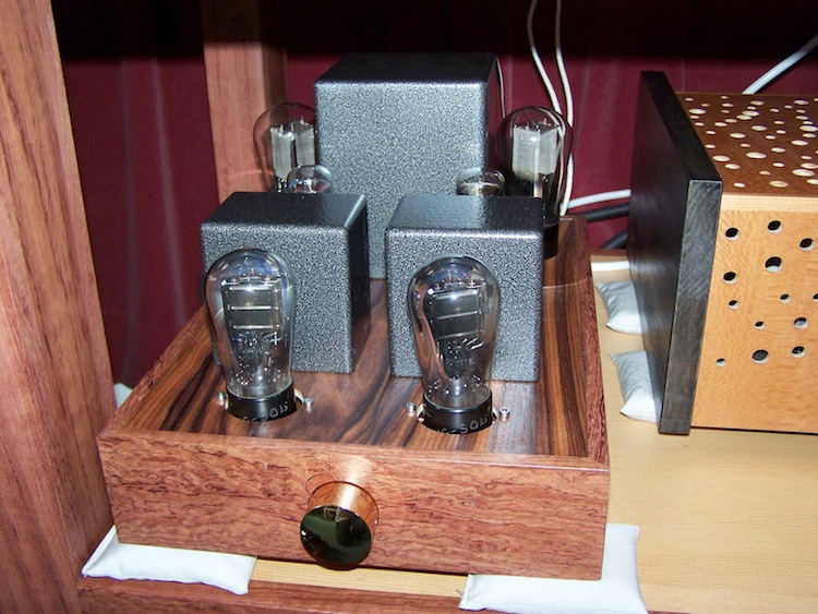

Some thougths on the use of cathode bias..
Intro:
I just (re)built a '26 preamplifier. It is choke-loaded and C-out. PSU is simple but elegant: RGN1064 (X2, used a half wave), 4.7uF, 10He, 60uF, 560R, 120uF and then per channel apart stabilized using a VR-tube.
Cathodes of both '26 share the same filament psu, in series, so one on +1.5Volt and the other on -1.5Volt, centered at ground. The '26's are battery biased on the grid.
My thoughts:
When using cathode bias, imho the use of ONE filament supply would be no problem (not puristic, I know). since the '26 is biased using the voltage drop on a resistor at 1 amp, this nearly is identically to a battery bias since operating the tube at several mA will not affect the cathode bias..
Ergo, using one filament supply for filaments in parallel increases amperage thus allows for lower filament voltage..
Anybody?
Reason for asking is > just curious < ;-)
..Oh, and a picture of the pre..

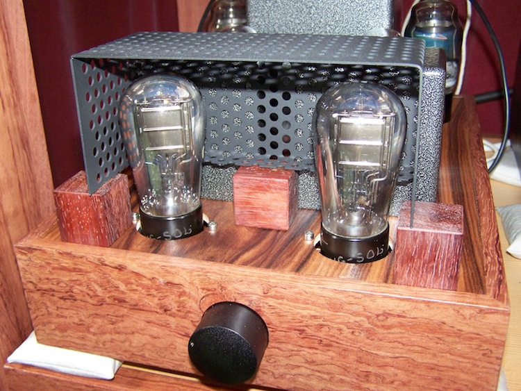

I decresed the hum...changed the tube and put an volume cotrol in front,
now the hum is almost not present, only if I turn the volume pot to max...
So I guess its normal in this levels to have a little hum.
In some cases it is worthwhile trying to "shield" the '26's. A simple aluminum cage behind and over the '26 will take care of any residual hum caused by stray-fields.. See picture.. Cage must be connected to ground, but will have effect without.
Sometimes it helps as well to cut a piece out of a tin can and wrap it around the valve-base only..
