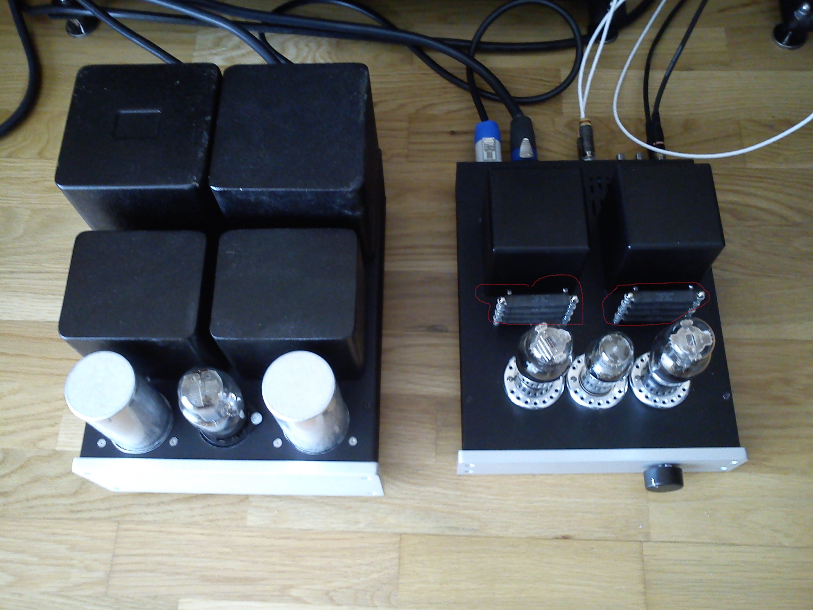

PSU very near 26 still no noise😀
What are those IC? diy?
Do you refer to those red marked? if yes are the filament resistors.😉

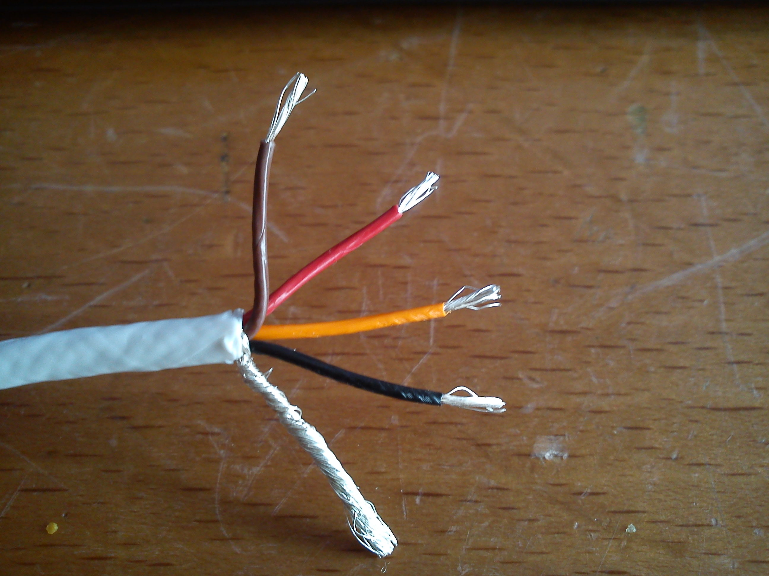

Sorry, didn't explained well.
I mean IC (interconnects), these withe.
Thanks.
These white are 4 x 24AWG all teflon copper silver plated, screen is also copper silver plated, inside and outside dielectric is always PTFE🙂
Looks nice, do you strand the 4 wires?
It is the same cable that Erno Borbely uses in his house.🙂

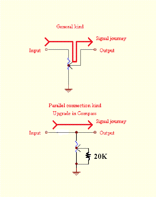

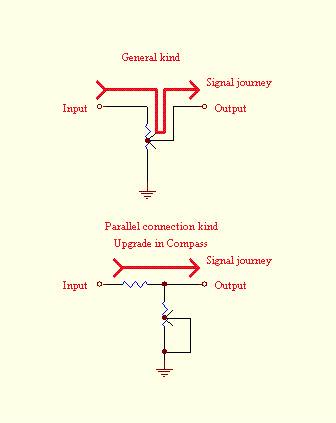

Is it the shunt mod you are thinking of?
Shunt Pot Volume Control for Better Sound and/or Gain Reduction - World-Designs-Forum

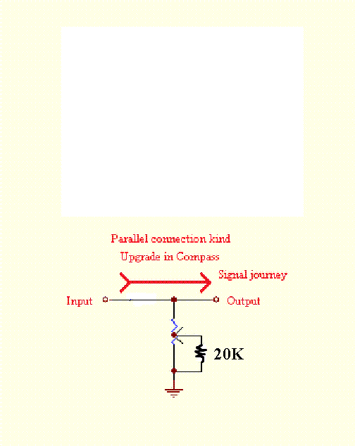

Now I'm trying like attached pic, not exactly shunt but sounds very good, I use two 18k Shinkoh resistor and the improvement is big.🙂
What do you think about the resistor value for shunt type also 18-20K?
TIA
Felipe
