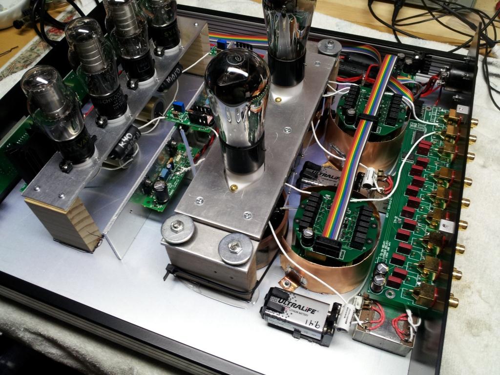

I'm happy enough with the bias battery under the input transformer that I've permanently changed the preamp, removing the input capacitors and grid bias resistors, and relocating the batteries to where the input caps were previously.
It sounds much better this way, and the signal path is a little bit neater as well. Pic below.

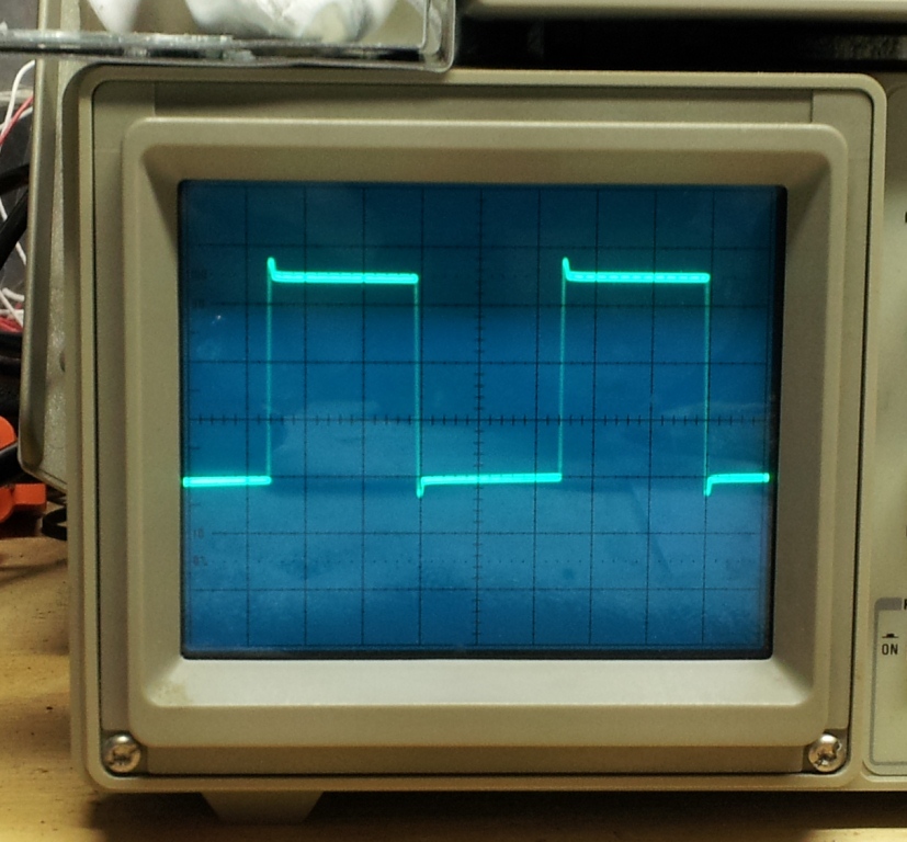

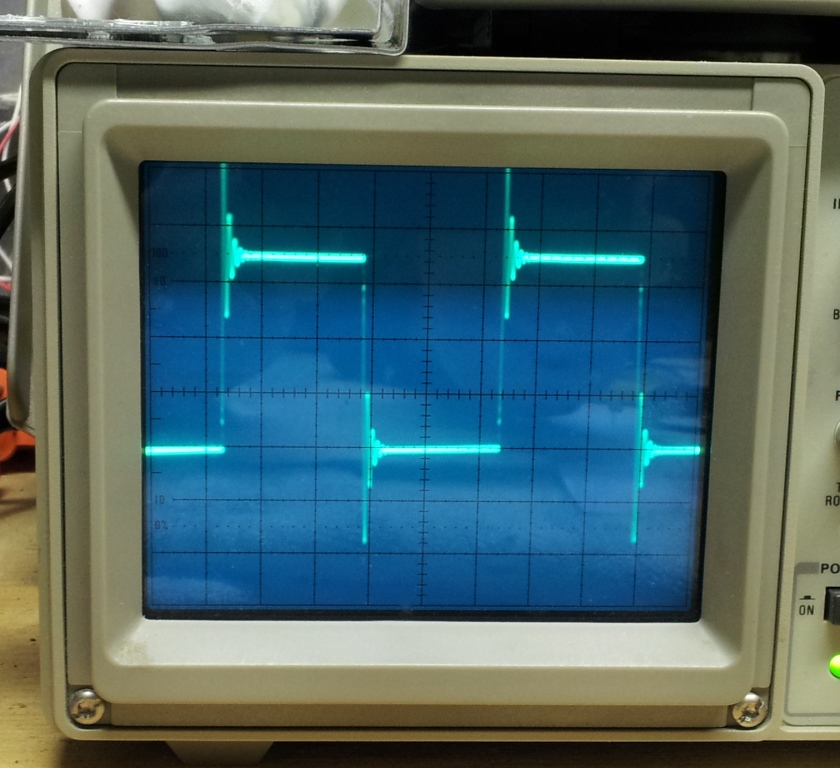

Vbenonisen,
I had some time this morning, so I wired up the LL1676 in 1:1 as 1+1:2||2. The RC network that worked well was 2nF and 2Kohm.
2K square wave scope shots below: first is the LL1676 with no RC, second is with 2nF+2Kohm.

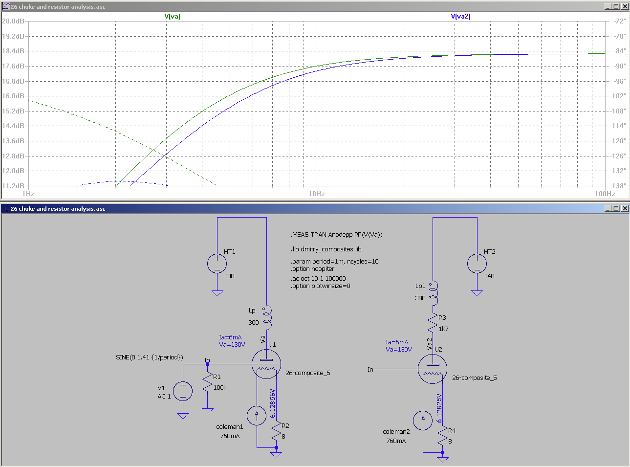

Hello again. I'd like to raise the issue of the anode load for the 26. I've been using 2x Hammond 156C chokes in series, but this is prone to hum. As an alternative I'm going to try and optimise a Lundahl LL1667/10mA. In it's raw state this doesn't sound as good as the Hammond combination, but it should have less hum. I tried adding a 4.7k resistor between the Lundahl and the anode and this seemed to clean up the sound. The Lundahl datasheet lists 270H inductance for the 15mA version, so I'm thinking the 10mA version should be over 300H. That's the same as the Hammond combination. Nevertheless, adding a resistor seemed to help.
Can anyone comment on this? Am I correct in adding the resistor between anode choke and anode, not anode choke and B+? Any comments about the size of the resistor? Has anybody played around with choke+resistor combinations?

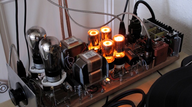

Hello Ale! I see you are in Saturday Morning Hi-Fi mode..... thanks for coming in here.
I think we can't rule out the physical construction of the choke as a source of hum - the Hammonds seem to pick up hum more than the Lundahls. Maybe there is more than one factor in play here? Have you tried a choke+resistor combination any time?
I'm certainly working this morning. I've been building DHT power supplies for the last three days (4-65a and 46 in filament bias) 😀
I haven't tried that combination am afraid. The LL2745 I'm currently using in the 26 preamp are very quiet. They are not shielded in my case as I'm still running with the breadboard (see picture attached). Of course if you place your hand very close to the OT you will notice the induced hum. Otherwise is not noticeable. If you want to use the chokes then I will suggest to place them inside their own little metal boxes?
From a sound point of view, would be interesting to hear your feedback as to whether the addition of the resistor will improve sound rather than reducing hum (and therefore also impacting the bass response of the pre-amp)...
Ale
Hi!
putting a resistor in series with the choke will not impact the frequency response. In fact it would even improve it. A few kOhms should not make a big difference though. I have found placement of anode chokes to be critical. Also be careful how you orient the two chokes of each channel. They can interact with each other and produce warps in the frequency response.
Thomas

Thomas,
Technically, I think it does. Albeit it will only be a minor impact and as you say it may be unnoticed or perhaps add some good results. If we don't take into account the load, then the pole is impacted as you have the inductor in series with the added resistance. I did a quick simulation to show this.
Ale
