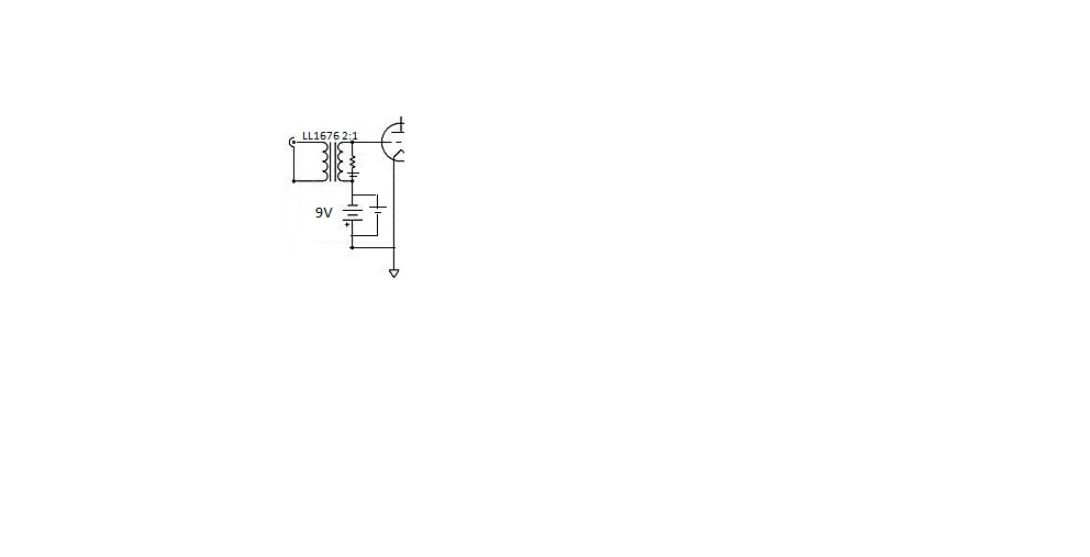

Made an improvement to my battery grid biasing today. Initially I was injecting the -9V through a grid bias resistor, and using a 0.22uF cap before that to block DC. Since I also have an LL1676 transformer at the input I decided to remove the 0.22uF cap and the grid bias resistor and put the battery at the bottom of the input transformer secondary instead, between the transformer and ground. This gives the advantages of no cap in the signal path, and much lower resistance to ground for the grid (more stable bias).
The bass improved considerably, and the entire presentation became clearer and more balanced. The battery is bypassed with a 10nF Multicap RTX polystyrene. The transformer secondary is loaded with an RC network of 2nF+850ohms, and the transformer is run in a 2:1 stepdown with primaries and secondaries in parallel.
I highly recommend this bias arrangement; the preamp loves it and so do I!
Attached is a schematic of the new input and biasing arrangement. It sounds far, far better to my ears than the standard arrangement with cap and resistor.

Hi Magz,
Thank you for posting your results and schematic. I was thinking about doing the same thing, but I was a bit worried about damaging the transformer if it is spec'd for 0 current with the 26 drawing a very little grid current.
Does anyone have any thoughts of limiting any potential damage to an input transformer in this setup?
Rich
Those Lundahls I'm using are amorphous Cobalt core with no air gap, so they'd be very susceptible to core saturation, but I haven't seen it. The DC grid current is very tiny, unless the tubes are very gassy.
I asked Kevin Carter of K&K Audio (Lundahl dealer) about it before I did it, and he said that normal tubes without high leakage will work fine. My results have convinced me that's true.
In any case, the transformer wouldn't be damaged by the DC, the core would saturate, which can be remedied by passing an AC signal at the saturation level...demagnetizing, in other words.

In terms of core saturation, how would one know that a core had been saturated and needed demagnetising?
Your bass response would drop off noticeably.
I've been back and forth with Kevin C. and Per Lundahl about this several times over the last few years in reference to a couple different projects. It seems the LL1674 and LL1676 are susceptible to developing some core magnetization if they are subject to too much DC current, which will cause the bass response to drop off. Per has implied that simply measuring the DCR with a multimeter is enough to do this.
The cure according to Kevin is: "High level (just below saturation) low frequency sine waves do the job the quickest. You can do that in circuit if you have a source of sine waves and a 'scope to take the primary up to saturation and back it down a bit."
Saturation is said to be ~16VAC rms or so at 20Hz on these. The datasheet shows 22VAC rms at the secondary at 30Hz giving 1% distortion.
All that said, I have now put about 20 hours or so on the LL1676 input transformers with the battery below the secondary, and the bass response is still thunderous. Magnetization from grid current doesn't seem to be an issue, at least with the 26 globes I'm using.
