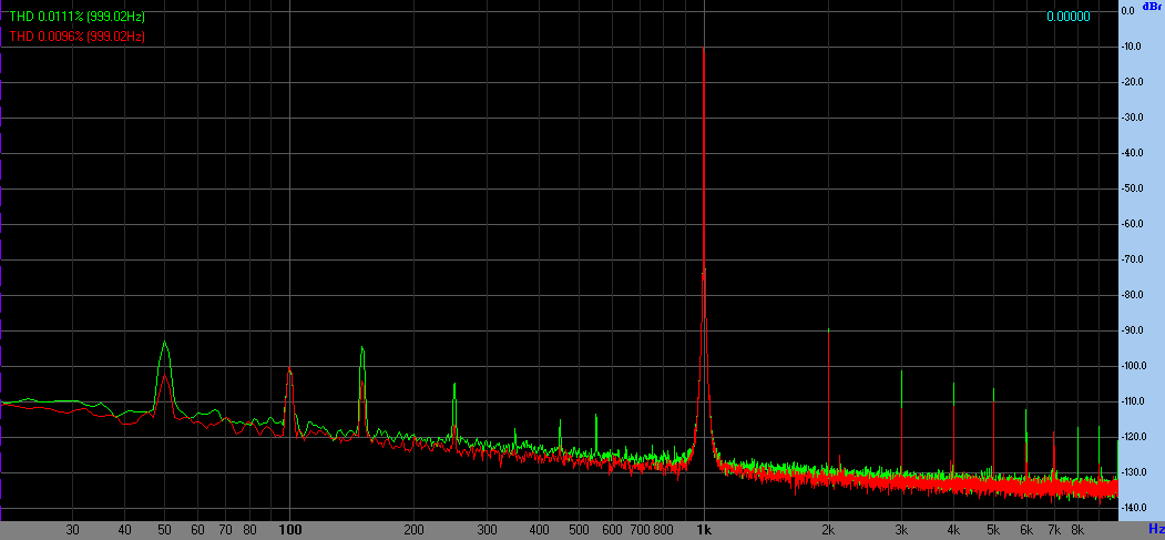

My measuring.
Two box (chassis) design.
Power supply box: HT transformer, AZ1 mesh, CLCLC raw supply and two SSHV2, LT transformer, dual LT raw supply -diode bridge, C-CMC-C-L-C), 19 pin military connector.
Preamp box: (dual mono in one box) 19 pin military connector, F.A.D.A #26 tube, DN2540 cascode CCS, heater bias -10R 50W- Rod's regulator, 350nF (220nF FT3 teflon+130nF SSG-3 silver mica) coupler, S&B TX-102 TVC.
Between power supply and preamp box interconnect:
- Right LT supply non twisted 14awg
- Right SSHV2 F+ F0 twisted, S+ S0 twisted 19awg
- Left LT supply non twisted
- Left SSHV2 F+ F0 twisted, S+ S0 twisted
Right channel: B+ 400uV noise, bias resistor: 300uV -average- noise
Left channel: B+ 200uV noise, bias resistor: 500uV -average-noise
No shielding!
Spectrum at 6V RMS output.

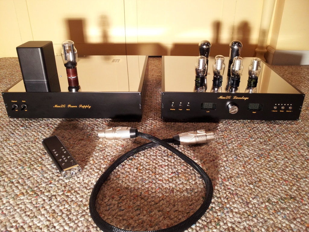

I made an umbilical using Belden 16 gauge stranded silver plated copper in teflon for the + leads and Cardas 15.5ga copper litz for the returns. All twisted pairs. Filaments, B+ and control power (9V) all in same cable, each pair shielded with copper braid, the braids brought together at each end to one connector pin, and that pin is grounded to the chassis at both ends.
Dead quiet (<-100dB background noise, 200uV or so, although Í'm at the limit of my sound card).
Connectors are 8-pole Neutrik Speakons.

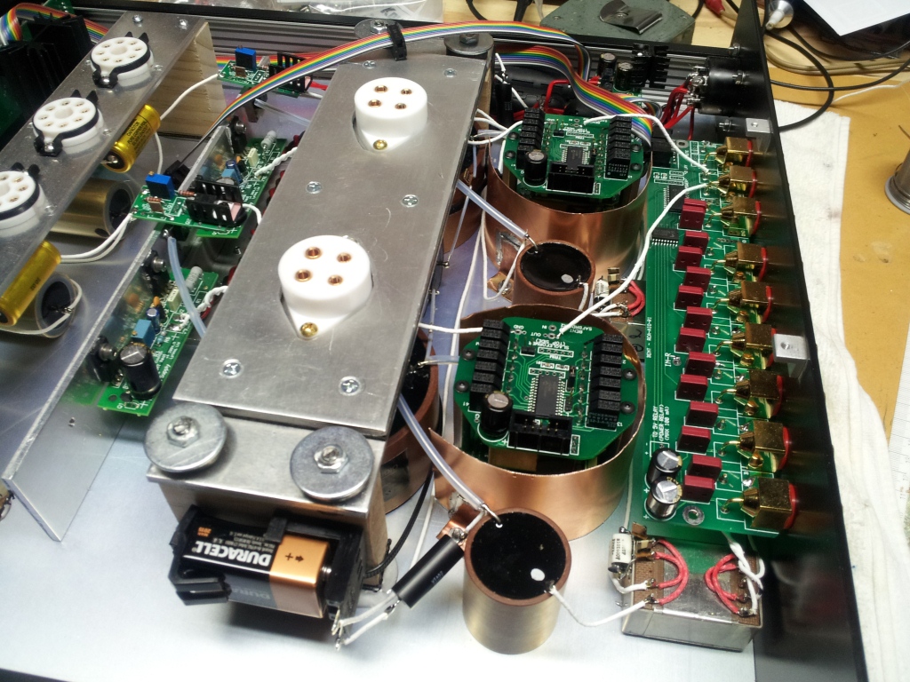

Hey, I did some more fiddling today.
I was worried that in my zeal to get the shortest possible signal path I may have run the inputs a bit too close to the outputs, so I built shields to go around the output autoformers, out of TI-Shield, which is permalloy with copper plating on each side, so it handles both magnetic and electrostatic fields. The shields are bolted to the chassis bottom, which is chromated for good conductivity.
After I buttoned it all up I gave it a listen - WOW. The background was a little blacker than before, and instrument separation and detail was noticeable improved! I guess I was getting a little cross contamination before.
Attached is a picture of the shield implementation Well worth the effort!

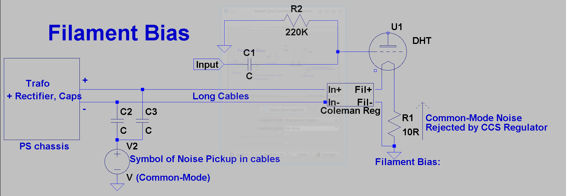

Yes, the effect of screening is not very large. But it will be variable, depending on the sources of EM noise nearby.
My personal choice would be to fit the screened cable, simply because it is so easy to do, and when you are trying to achieve the best possible sound, even the smallest things can have a pleasant influence.
If you use filament bias with my regulators, there is a strong rejection of cable noise anyway.
The digram shows the influences. Provided the cables run parallel, ambient noise is picked up as common-mode.
The regulator rejects common-mode noise (=grid-to-cathode noise) because Fil- is directly at ground. The regulator rejects differential noise by means of the current regulator-action.
With cathode bias, common mode noise appears across the cathode resistor, and so produces a current that runs through the cathode capacitor. This may well add to problems presented to electrolytic capacitors, with their high parasitic inductance, and effective resistance. But I imagine that no-one here is using cathode bias with a capacitor now, anyway.

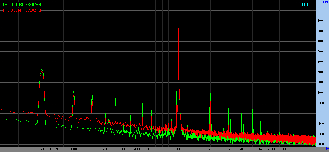

Replaced the HT filtering stage with a salas SSHV2 regulator (185V output) and then the CCS with the glow tubes (150V and 15mA each channel).
When the salas board was under test hanging with a couple of test leads and not fitted in the preamp (probably at 15 cm with some test leads) the output noise was very low (-85dBV). Happy with the results, fitted the Salas SSHV2 board into the preamp really close to the glow tubes, soldered final cables and when tested again surprisingly the noise went up again to -70dBV....
Are the glow tubes responsible for this due to being so close to the salas PCB or shall I look to the noise source anywhere else?
Ale

I said it before. The VR tubes generate their own noise, higher than the noise of the Salas shunt reg. I think it completely defeats the purpose of the shunt regulator to put the VR tube last. The CCS has no effect. I too like the look of the VR tubes.
As for the higher noise after you installed the shunt reg in the box; where did you measure the noise before and after, on the tube anode?
Iko,
found the issue! It was a ground loop introducing noise. The problem was that I omitted grounding the output as I'm not using the differential connection now so return was through amplifier's earth. I grounded with a pair of test clips the return of the output cables and noise is completely gone!
Will do proper measures again to reflect this, am a happy man at last.
