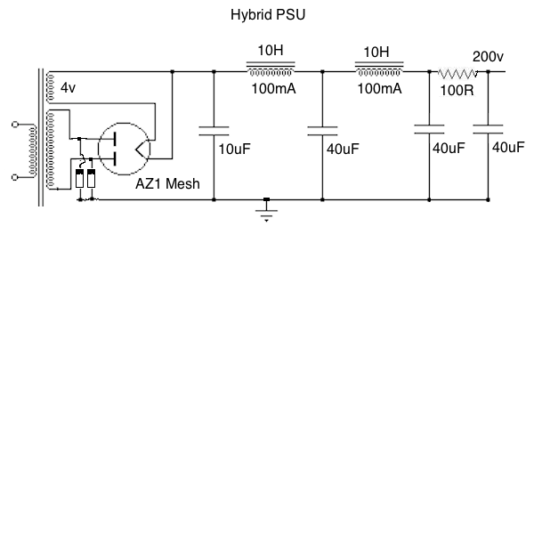

On a whim I decided to upgrade the PSU for my preamp. What a difference! Better detail and tone. I used a large EI 240-200v transformer I had on the shelf. This whole PSU feeds a VR150 voltage reg. Moral of the story - don't neglect the PSU. I should know this. All the caps are polypropylene motor runs. The diodes are UF4007. I suppose I could find something more sophisticated for those, but that was what I had in stock.

... What a difference! Better detail and tone...
Just curious -as your new setup is quite elementary*- with what are you comparing?
You're stabilising the HT with a gas tube. One of the advantages of an electronic regulator is in the strong reduction of the influence the PS has on stages with low PSRR. It's not sacred because every power supply (even the battery) has internal resistance and impedance, interacting with the audiosignal imposed on the HT. The amount of the interaction however differs, freeing the bandwith of interest from phase behaviour.
* To reduce the ripple voltage it's more effective to first use a RC filter and next a LC filter. See if you can improve with that in PSUD.

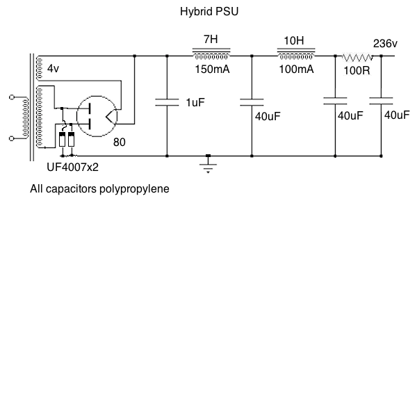

I attach the old PSU - it's actually pretty similar. I can only think that the AZ1 mesh is making some sort of difference - smoother treble and a bit more refined sounding. I heard that on previous occasions when I made the switch. On the other hand, the 80 is no slouch.

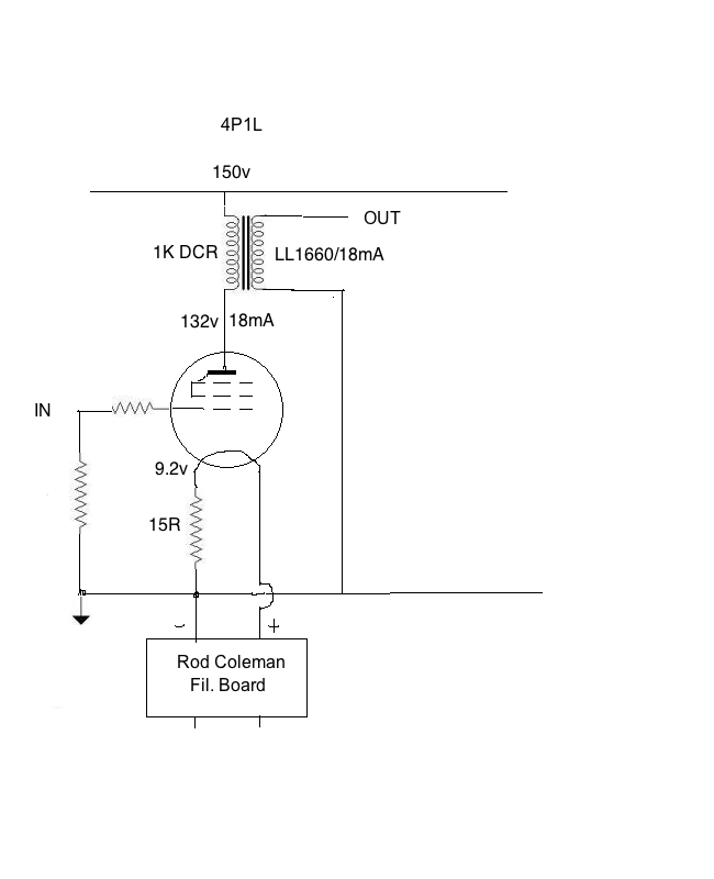

Up to now the PSU has been driving a VR150 which feeds the circuit. Actually the preamp now uses 4P1L not 26, but it's in filament bias as well.
Next I inserted a DN2540 before the VR150 in place of the dropper resistor for the VR150. I did this in the 80 PSU, and this PSU now has even more detail than the AZ1 PSU without a DN2540. However, I'm not convinced about the tone in the mids and treble.
It's starting to sound like an active load again - tried that with IXYS and found it a bit bright and tiring. Yes - bass is better, detail is better. I heard that before. But I'm hearing something else - is it possible that the DN2540 is compressing the sound somehow? How could that happen?

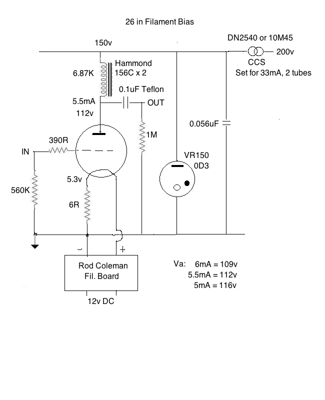

After comparative listening I decided I preferred the VR150 with a DN2540 or IXYS 10M45 CCS, and with a mesh AZ1.
I went back and used this arrangement with my original 26 preamp, which has the two Hammond 156C plate chokes and teflon FT-2 output caps. It's still good, but I miss the treble sparkle of the 4P1L into LL1660/18mA. This may be the capacitor coupling. The mids and bass are fine.
But I have the hummmmm back again with the Hammond chokes. Has anyone using these managed to get them free of hum, and if so how? I'd really like to know!!

I've no experience with Hammond 156C but on another circuit I experimented with series connecting two identical chokes. What I recall is high tones lost detail. Theoretically two caps in series represent a smaller cap, but we're forgetting the choke copper resistance here, presenting a LPF.
I try to get the exact workings of that CCS+VR supply in post 2200 but perhaps it's time to check theory for me again? :)
Here the 26 is represented by the R1, R2 combination and the gastube by R3. As I see it, they influence each other in a way that if the 26 starts pulling more current and the current source keeps current stable, the gas tube has to supply current. Is that 150 volt stable over operation?
Imho totally true Jaap!
When the 26 demands more current, it will come from the VR-tube, probably resulting in less stable regulation (and vice-versa).
I experimented with VR-tubes and found out that regulation gets better when more current flows through them.. So maybe increasing the current throught te CCS to 30mA will give "better" results? (at least, more stable regarding the VR-tube?)
Any ideas someone?
Rob
Consider that V-sign the 26 tube and R1 the choke. So, the 26 is loaded by the compound of three devices: A) the choke B) the FET CCS and C) the VR-tube which is bypassed for HF.

Andy, if you leave out one 156C you'd probably not mis low. How's high turning out?
Alrighty, with the output four to count ;)
For a VR to change current it has to change its impedance.
It's a complex load.
Ale, did you compare 26 reproduction against the SSHVSR and a sole resistive load ?
( added to the load presented by the output ).
Andy, mind the distortion product of that penthode which has a different spectrum than the 26.
Ale has probably data on that. It might turn out you're listening for a small amount of uneven harmonics, beafing up highs. Just guessing here.
