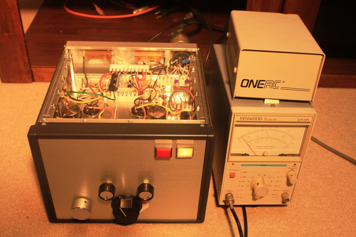

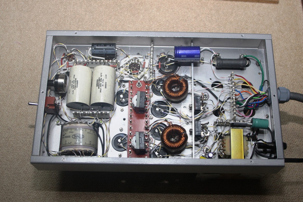

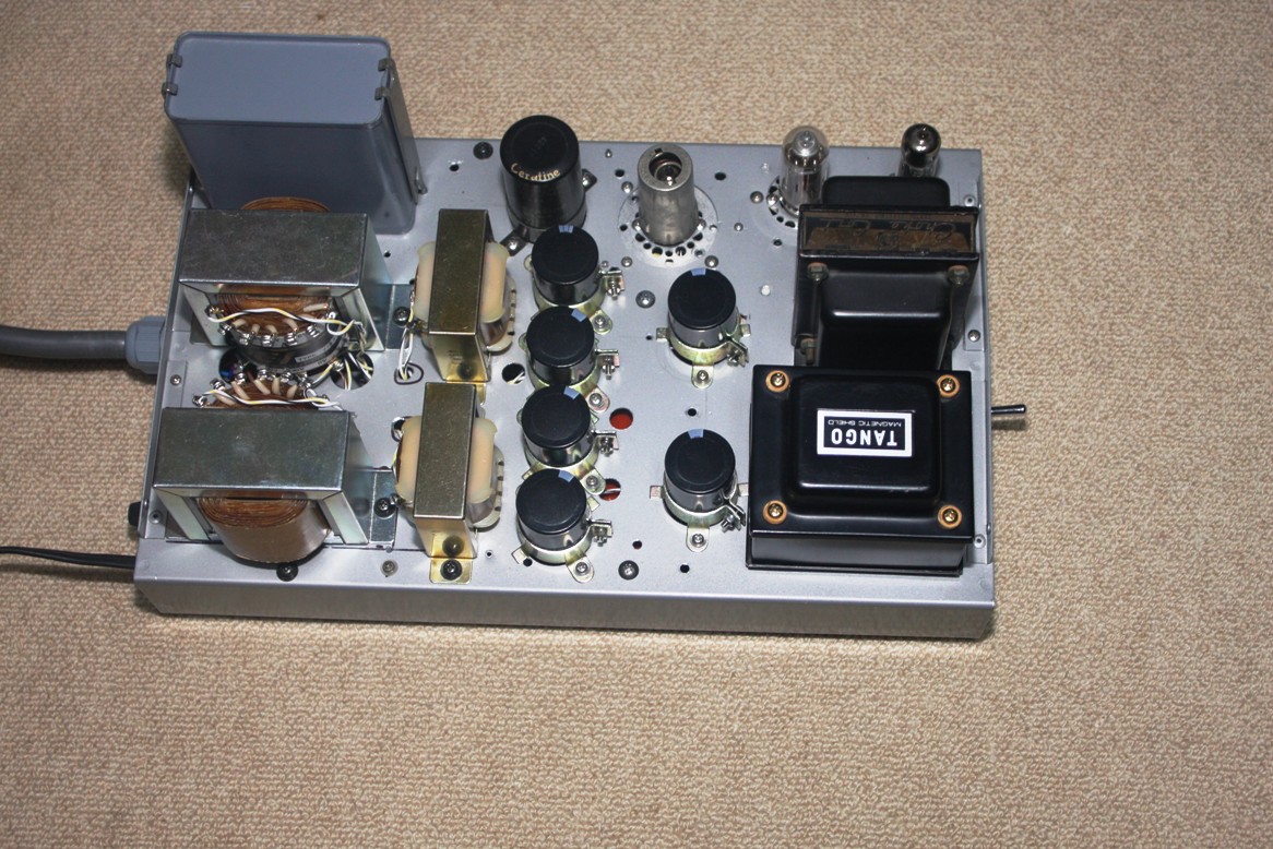

Rod, I am sorry, afore-mentioned residual noise level 0.31mV was incorrect!
It was 0.031mV.
Result of your check list:
1) 0.5mV~8mV(at the peak)
2) 0.5mV~5mV(peak)
3) 0.12mV Filament to Firament:0.03mV
4) Capacitance from primary to secondary:?
Filament transformer constraction:E-I core
Install an isolating transformer
4) Fitted 2200 mF
5) Not yet fitted
After installed 2200 mF and isolating transformer, the residual noise is improved to 0.025mV.

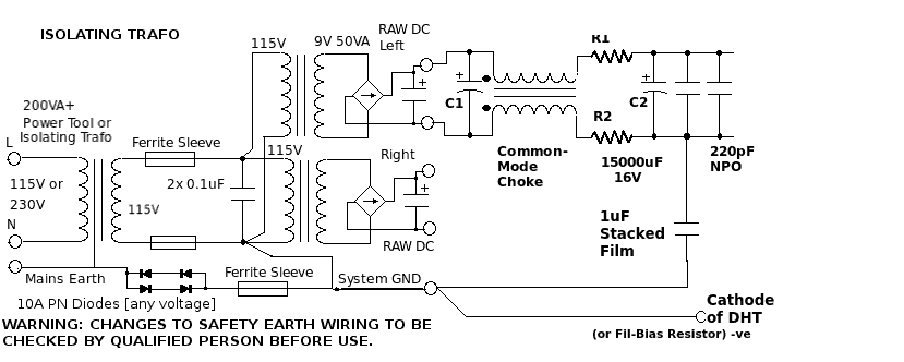

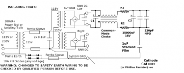

Hiro, The measurements look very good to me.
Possibly, the common-mode noise voltage can be reduced a little more. It is difficult to improve on 25uV - but maybe this voltage is caused by some leakage current from primary to secondary of the filament transformer. The isolating transformer is very helpful, but perhaps a common-mode filter can be considered.
The drawing shows some ideas for common-mode filtering. You already have the isolating transformer, and excellent differential-mode filtering, so the common-mode choke (Murata) + capacitor is another option.

Rod,
Thank you for your advice.
I tried fitted comon-mode choke in my stock , but the result was getting worse.
It is difficult to reduce the noise from this level.
As you mentioned, the isolating transformer is quite effective.

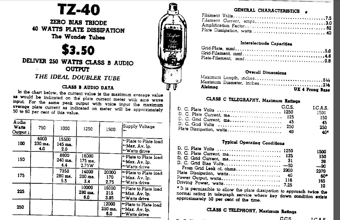

I wonder if anyone tried for preamp or driver duty anything excessive like a zero bias transmitting tube. I got a couple of NOS TZ40 that are looking for a good project. 7.5V at 3A heaters, amplification factor 62... Have no idea how linear they'd be at a few mA operating point.
