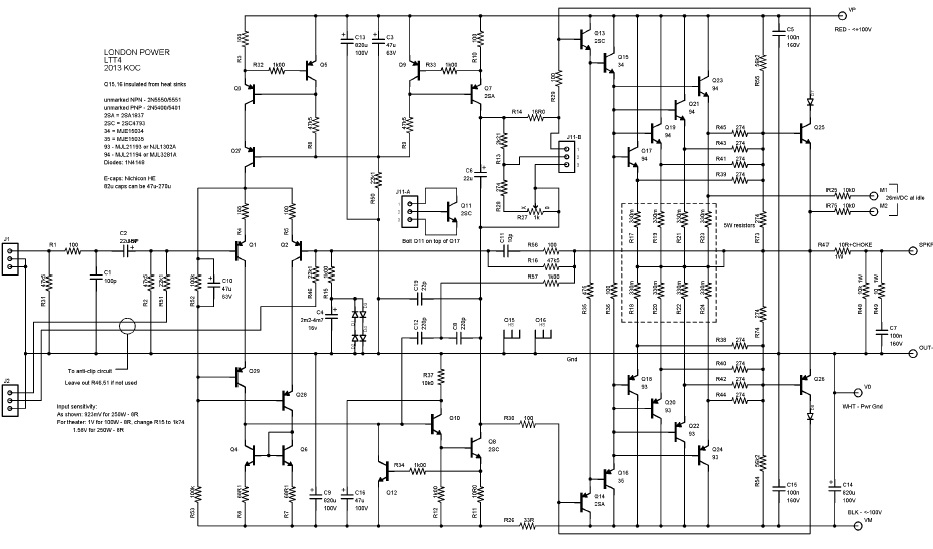

I am attaching a schematic showing the parts I removed and the jumpers. Can someone look at this and tell me what other, if any, parts need to be also removed?
I also added 2R2 SMD base stop resistors. I am just doing this on one of the three boards I have populated so I can test it.
Thanks, Terry

Terry, if you remove the pre-drivers as indicated in your schematic, then you are running it as an EF2, and in that case you might get away without the base stoppers on the OP transistors. I would remove and jumper the pre-drivers first, test, and then install the base stoppers only if you still have stability problems.
EDIT: your IPS is not right. If you remove IP cascodes you also need to remove R52, R53 and C10. Do not replace with jumpers. You need to jumper the emitter-collector pads where Q28 and Q29 previously occupied, as you have correctly indicated on your schematic.
Too late, I already cut the traces and install the base stoppers. I am getting oscillation especially with a load attached. I only removed the items shown on the schematic. Basically what I listed above, D3, D4, Q28. Q29, Q13 & Q14. I didn't remove any resistors yet. Kevin said I should remove related parts but I don't know which ones are solely related to the transistors I removed.

The related parts are R52, R53 and C10. But please wait for a second opinion as I'm no expert.

R52,53 and C10 are related to the cascode - remove them and leave their spots open if you are taking out the cascode.
Your base-stops are okay; other links/cuts okay.

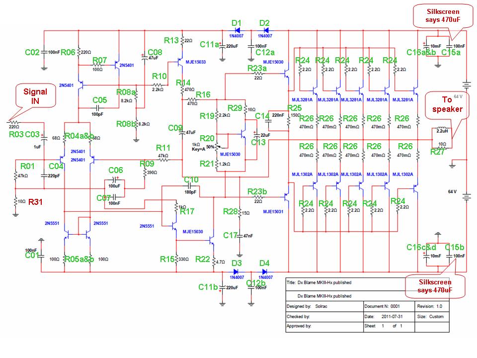

I am actually in the process of building an EF2 version of Kevin's design on a spare DX blame mkiii board I had lying around. Carlos' design doesn't have all the cascades but apart from that the two topologies are remarkably similar - the main difference being that Carlos has put his stamp on the Linn design by playing with the C and R values.
The mkiii boards are just a bit more spacious and easier to rework.

I'm sitting here looking at Kevin's schematic and the MKIII and I don't see how you are going to build Kevin's design on that PCB. Carlos has 6 transistors in the front end and Kevin has 9. Carlos has 4 transistors in the VAS and Kevin has 6. The output section is fairly close except Carlos included base stoppers and Kevin has additional R38-45, Q25&26 and D7&8. Looks like the VBE is wired differently too. I don't know how closely you followed the last MKIII thread but we discovered that the lifted ground scheme is wrong on the board. You need to cut some traces and add a couple jumpers to fix it. I am learning, which is what I want to do. Maybe when and if you get yours working correctly you can post a schematic with some voltages and maybe some Vbe measurements. I don't really want to pull any more parts until I know I need to.

I'm waiting on some more parts for my LTT4 board and it will be a week before they arrive, and then I'll be preoccupied with house renos and family stuff. So it will be a few weeks before I can report further. That's why I moved to the MkIII boards - because I can make progress with parts I have on hand.
The topologies are fundamentally the same. The extra small signal transistors you see in the LTT4 schematic are all cascodes.
