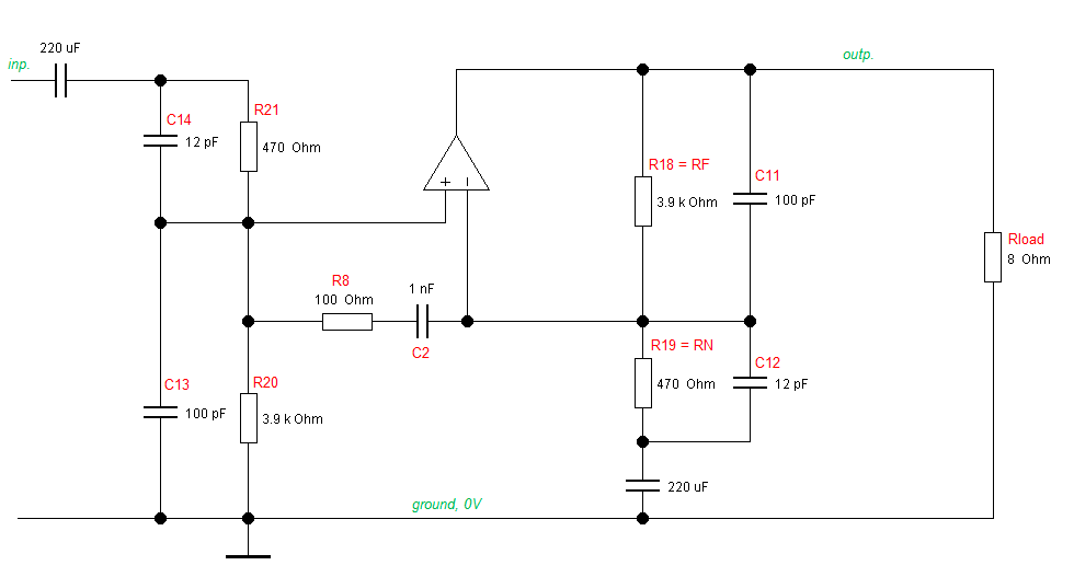

You should swap C11,C12

Let's play dumb and ask: what is a steam engine? - "Da stellen wir uns doch einmal ganz dumm und fragen: was ist eine Dampfmaschine?" [die Feuerzangenbowle]
Why? I think you, dear Bucks Bunny, should also explain the why to the dear readers of this forum, i.e. explain the effect of your proposal in a comprehensive and understandable way.
Although normally I do not reply to postings with that pompous attitude, I will give my explanation.
I suppose you want a frequency compensated voltage divider.
This works in the same manner as frequency compensated 1:10 dividers inside scope probes.
The principle boils down to the impedance ratio of R1:R2 equals the impedance ratio of paralled C1:C2
With Zcap = 1 / 2 * pi * f * cap the imoedance is INVERSE proportional to the cap value.
Thus the cap with the smaller cap is paralleled to the resistor with the bigger impedance.
Agreed?
This was the original intention, as I recently wrote here.
Absolutely correct!
And what next?
No contradiction!

The actual topic is about fulfilling a stability criterion. And also the question of how engineers usually solve this, not the tinkering DIY, you are an engineer with a German university degree "(oder Dipl. -Ing. (FH)") !?

given:
T1 = R20 * C13 = 3900 [V/A] * 100*10^-12 [As/V]
T2 = R21 * C14 = 470Ohm * 12pF
wanted:
T1 = T2
looking for C14 ---> T1 / R21 ---> 830pF, would be the correct value of the second capacitor, now the complex voltage divider would be a so-called frequency-compensated one.
R20 / R21 = C14 / C13
= 8.3!
Due to the circumstances at the time, I divided instead of multiplying correctly. All I had to do was press the wrong button on the classic calculator (next to each other).
This is the unvarnished solution to the problem, which is not a problem at all. Let us rather look at the mode of action of the complete, existing network with regard to the well-known stability criterion of feedback systems.
The (unreflected) recommendation leads to what? That was my question. It also leads to the same time constants, i.e. to a frequency-compensated divider,
3900Ohm * 12pf = 46.8n sec
470Ohm * 100pF = 47n sec
but, the desired time constant was greater than 390n sec!

The side banter is all very well, but I would like to get back to the relentless analysis of the circuit in question.
For example, we could ask ourselves what ft the “reviled” Darlingtons must have as a minimum, so that we no longer criticize this (or similar) point!
HBt.
