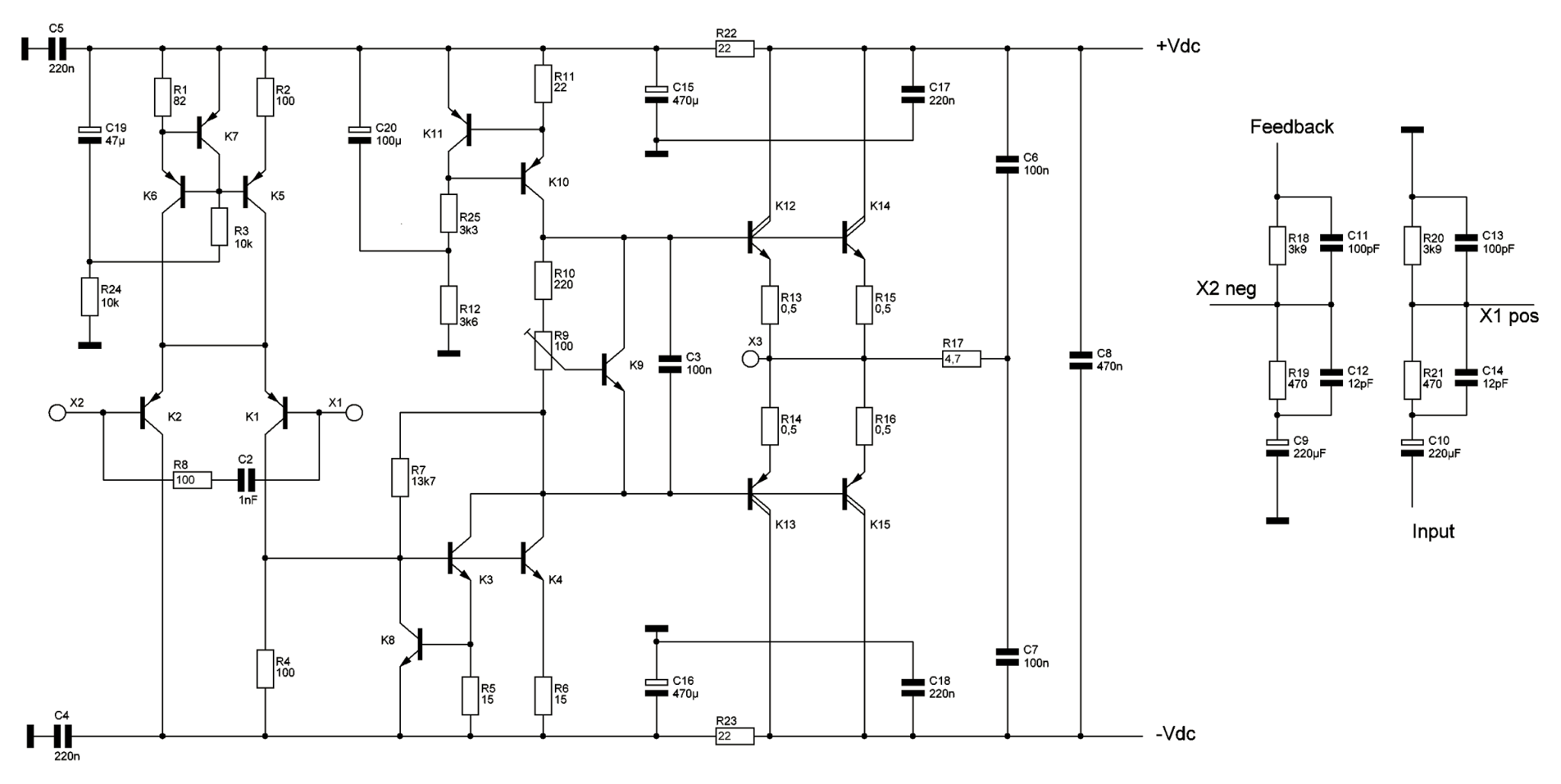

20WPA Version 1.1
HBt.

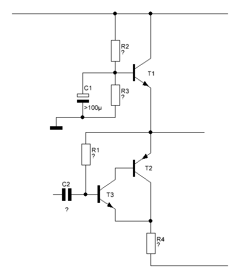

We could certainly try that out, maybe switchable to /between GND or to/ the base electrode.Your version has higher loop gain (45dB).
The solution is to get rid of R7. Instead, load the voltage amplifier with a resistor to ground.

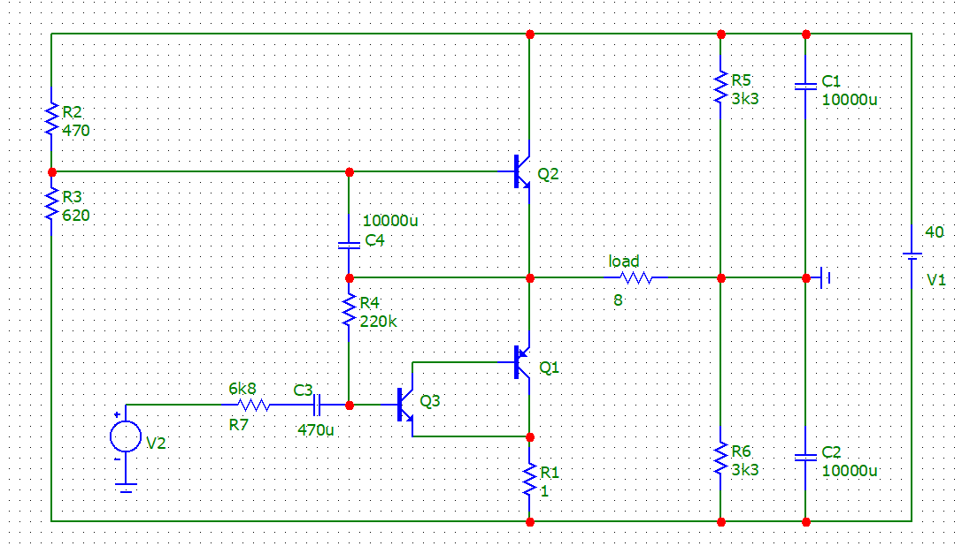

You're right - and thank you for the reminder about the coupling possibilities of interference. A point that is probably often forgotten or simply neglected.There s no mistake, here a transient simulation with 1V pk 100Hz injected in each rail,
this amount to -31.4dB,
exactly what is displayed at 100Hz in the frequency domain simulation.
They surely used a regulated PSU for the tests, otherwise they couldnt even have measured the amp noise,
I have offered the following simulation results for the negative rail in question:
PSRR-neg/
-37dB without R23 and C16 or other filtering
(up to -93.3dB with R23 and C16, at higher components)
-46.7dB without R7 (the same with R7 as load to GND)
(up to -102.95dB with R3 and C16, at higher components)
Obviously, the design should always mitigate the evil power supply side by feeding the entire preamplifier with a regulated power supply, here the negative rail and in the AB100 (from Nelson P.) the positive rail. Or take Douglas Self's well-known (but regularly forgotten!) solution suggestion to heart; an additional winding or an auxiliary voltage, another mains transformer ..!
In terms of R7, I can imagine that -10 extra dB might make a difference if an amplifier is humming annoyingly on the power supply side - but here they don't really make an elementary difference.
With 2 * 2 * 15mF charging capacity, and a sporadic peak load of 40W, i.e. a rather short-time discharge, with a peak-current of 2.2A -> there will be no disturbing ripple voltage on the rails (for a noticeable time).
But,
thx for the reminder - it is basicly a important case, mostly overlooked.
regards,
HBt.
HBt.

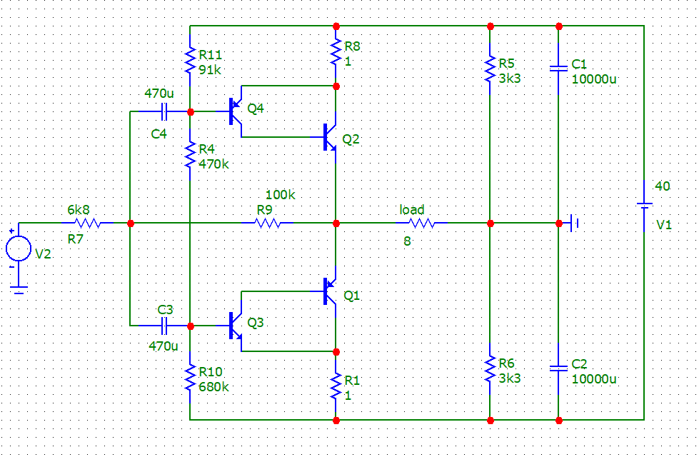

This schematic unfortunately change nothing to the whole picture, THD and IMD will still be very high because the VAS
is extremely non linear and a high IPS current is of no help.
Guess that the designer believed that the VAS input current being negligible in respect of the IPS standing current would reduce
the global non linearity but it just dont work like this, actualy increasing the VAS input Z would not only yield the same result
in respect of IPS current loading but it would also increase the VAS gain and hence linearity once the loop is closed.
Anyway those Otala inspired designs rarely, if ever, produced convincing results, one of the few was the symmetrical
differential from SGS and still, with a classic miller compensation and some components values being changed
it was performing much better.

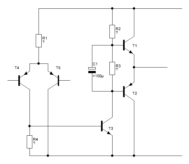

Special requests:
Do you have the version 1.1? Then rebuild to version 1, step by step, and listen to every step, and tell
a) if difference,
b) describe the difference,
c) grade the difference (subjectiv, no problem)
Then:
C3 > 100 uF
remove K14 and K15
replace K10, K11 and K3, K4, K8 per resistor
replace K9 (BD139) per BD441;-)
replace the remaining K12, K13, Darlingtnos, per transistors - do not forget to adjust;-)
If you have gotten to enjoy audio engineering and gaining audio experience, we could continue;-)
And always listen carefully after each step, and always do the steps:
a) difference audible?
b) difference describeable (and describing)? And, if you like,
c) graduate the difference.

"übrig bleibt" After your slimming diet remains:
if I have understood you correctly?

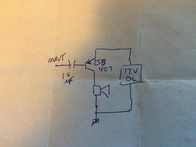

But you do get sound, and it is “clear”. Clear as in not all “staticky”. That itself is often considered “success”. This was the first amp I ever “built” that met the above criteria. Two parts, plus a battery and a speaker. I had literally no understanding how or why it worked. The only reason it DID was imperfections in the germanium transistor - excessive ICBO.

This specimen of my mean soul works in the simulator right away. Completely useless components such as the BD139, 140 & TIP3055, 2955 are used. 0.8Adc is quickly reached as the initial quiescent current ..!
At full scale the THD remains at about 1%. If we were to spin this flower pot further, we would end up with the well-known throw of Mr. Hiraga ---> this is no coincidence!
