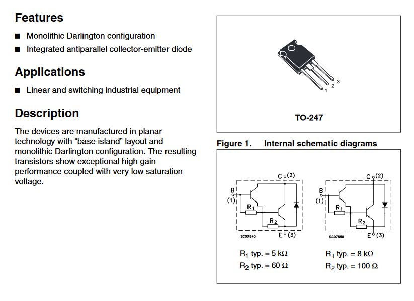

Harder to find darlingtons , they go obsolete quickly - replaced by 21'st century low Rds class D FET's.Biggest problem with these darlingtons is the fact that you’re stuck with a 3 MHz driver transistor.
PS - darlingtons are tubelike , only sought by a small market of audiophiles.

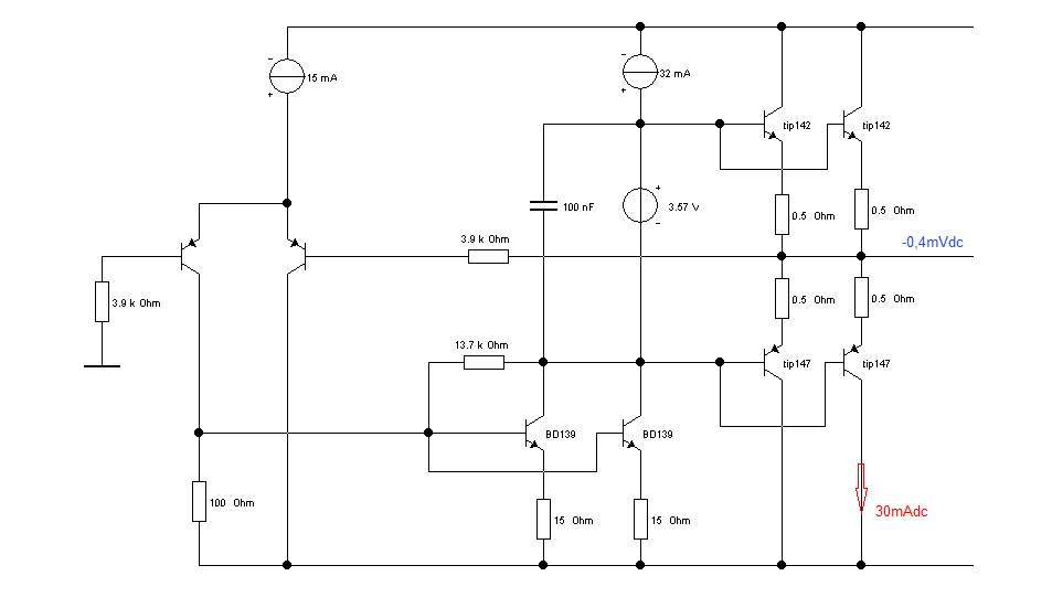

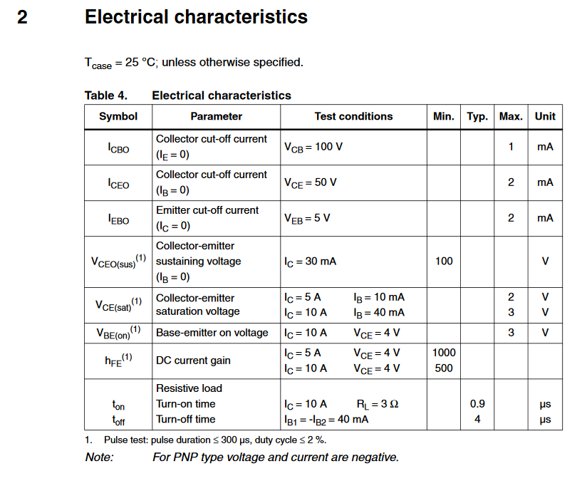

The following Darlingtons were used in the first original:
BDV65B & BDV64B.
60W into 8Ohm,
that's just under 4A_peak, let's just take a decent beta_drop as a given, so the 32mAdc for the VAS could be explained quite easily.

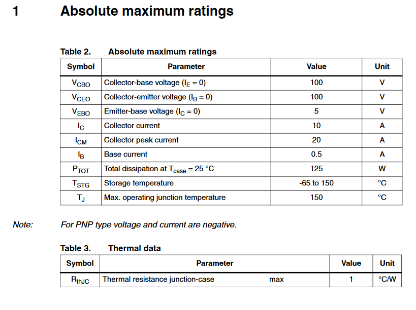

ft of the BD139 is estimated to be around 50MHz, I can't find any information on the TIP14x at the moment ..!
BDV65B & BDV64B.
60W into 8Ohm,
BDV65B & BDV64B.
60W into 8Ohm,
BD139 Ft vary with the manufacturer, 50MHz for Siemens and likely most manufacturers, faster seems to be Phillips with 190MHz.
TIP140-147 serie is the same as BDV64/65 set apart for the internal resistances wich are lower for the latter.
No simulation yet? Is this ancient design so uninteresting today? Did I already say that the end product (my little monos) is really convincing? Driven by a preamplifier with low output resistance (<<< 100Ohm) !
So I like this crazy thing - "the 20WPA", simply put together.
Look also in the attached file (the second original version) ... my reduction /scaling is slightly different.

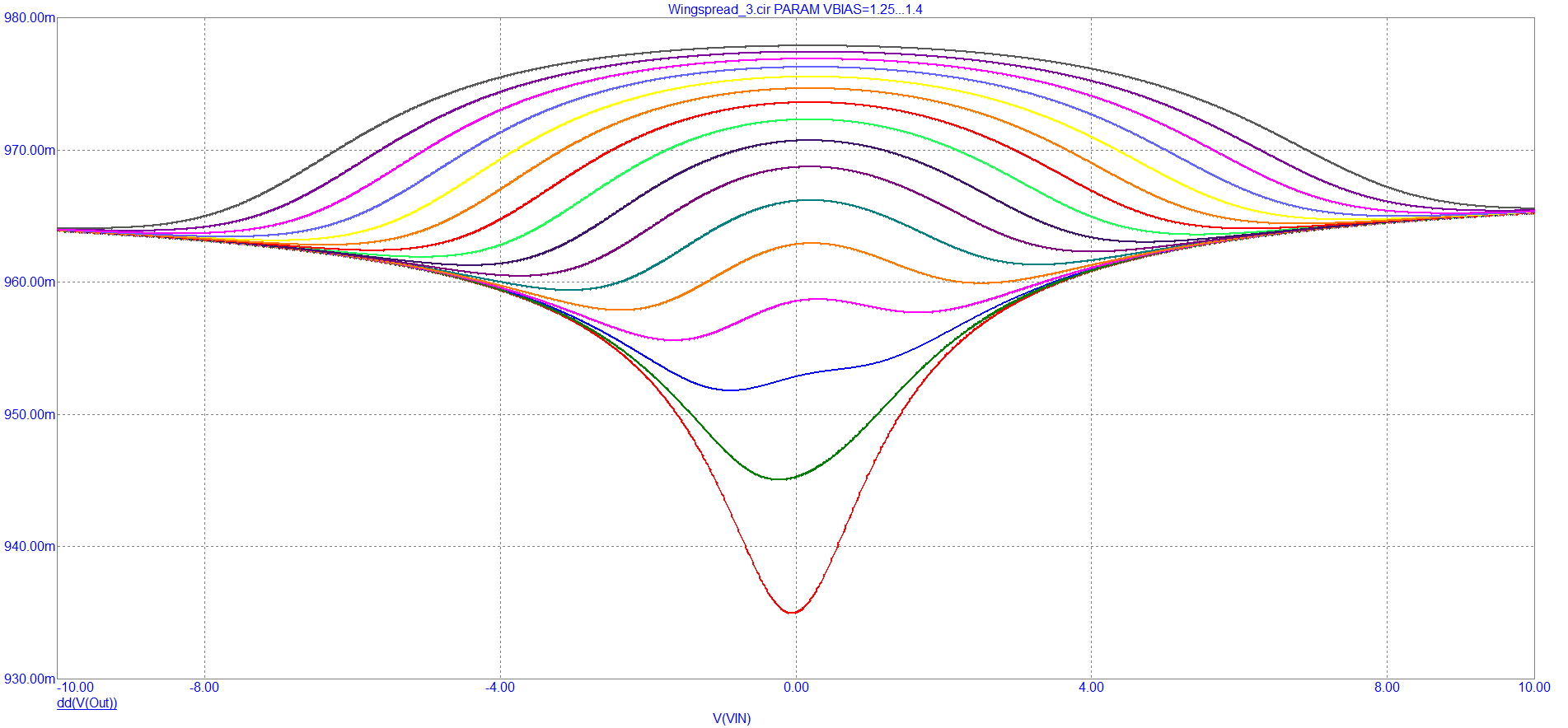

Can we generate a wingspread diagram of the output stage of the 20WPA? That would be interesting, especially as the complementary pair is often not really complementary to each other.
The amplifier is interesting in the same way that news coverage of disasters is interesting. 😉
The 0.47uF shunt capacitor (C3) is huge. The reactance is only 17 ohms at 20KHz. The dominant pole is at 4KHz. The pre-amp had better be able to drive low impedance. This is the first time I have seen a tantalum capacitor used for frequency compensation (!).
You did a better job by reducing the value. 🙂
Your amplifier also has much better thermal stability due to increasing the emitter resistors from 0.2 to 0.5 ohms.
I am critiquing the amplifier by modern standards. The amplifier does work and its faults are likely below audibility.

The value of R7/C4, 82R + 220uF, is also a nice "feature", a 220uF impedance at 20Hz is 36R.
I really had to read the article several times and look at the schematic a few times - “the design has a few special features”. To put it kindly.The value of R7/C4, 82R + 220uF is also a nice "feature", a 220uF impedance at 20Hz is 36R.
With something so slightly crazy in my hand, I no longer worry about abstruse ideas like the AB-BA gm-doubling compensation ..! I also immediately stumbled across all the points mentioned in this thread - but what the hell?!
The amp is a joy to use (and the measured values are not "so" bad). Let's see what @ostripper
's simulation will produce, I hope he's still simulating the 20WPA.
IMO, darlingtons are a non-starter if one wants a more linear output stage. The driver transistors need to carry at least 20mA at all times.
Ed
Ed
@EdGr, Actualy they are enough with 6-7mA, i once used these BDV to replace the quasi of a Roland Jazz Chorus 2 x 40W guitar amplifier that has way lower VAS current, this ETI has a 32maA VAS current, wich is overkill but not
as much as the LTP wich is at 15-16mA and dissipate 0.5W, wich is also the TDP of its CCS, that s 0.25W/transistor.

.SUBCKT TIP142_FC 1 2 3
Q1 1 2 4 Q1model
Q2 1 4 3 Q2model 5.888
D1 3 1 Dmodel

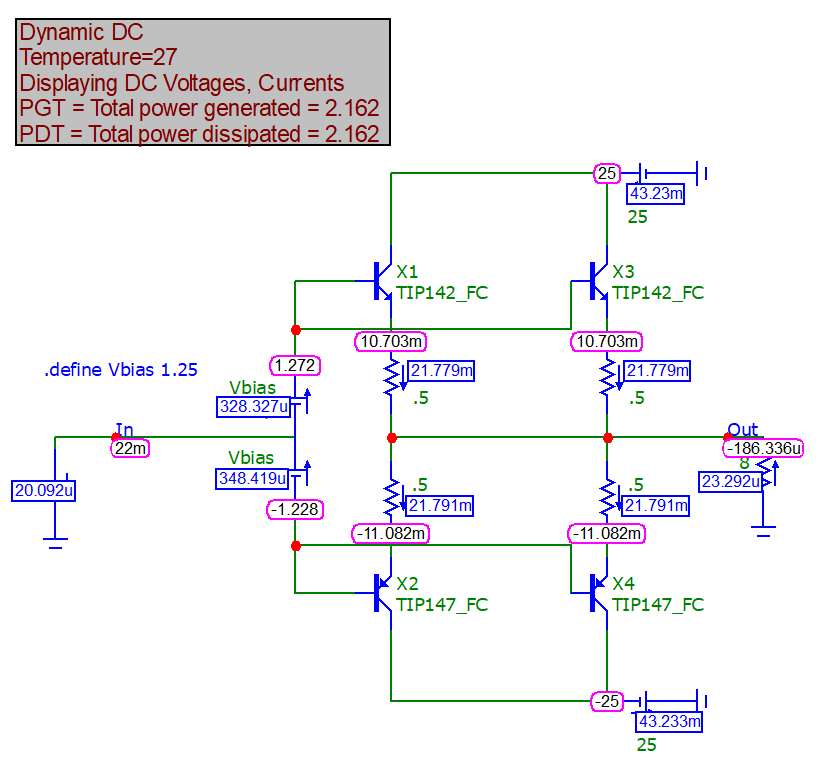

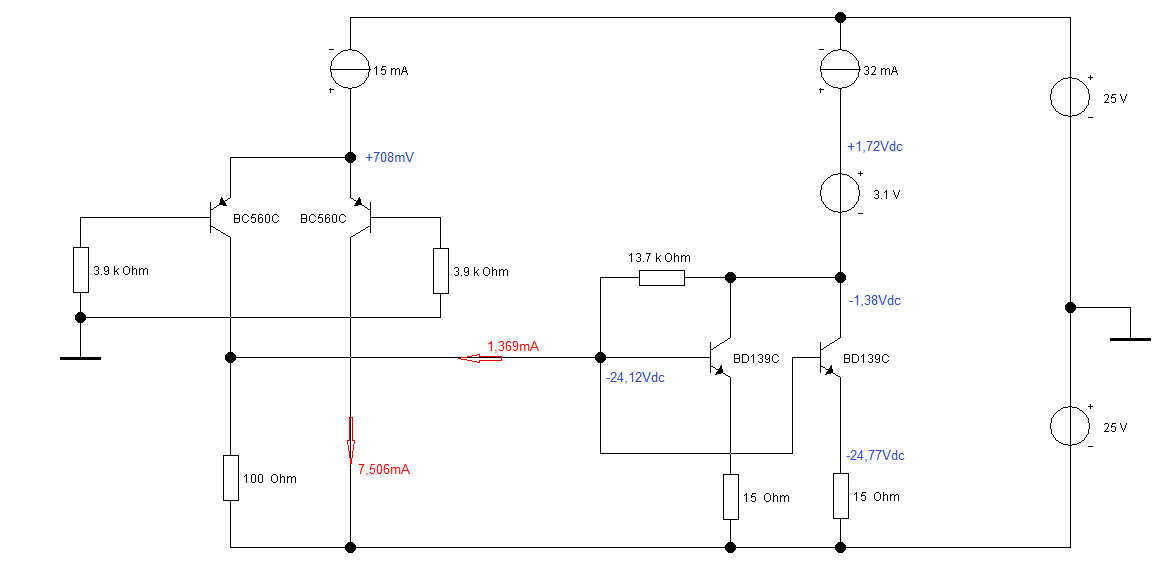

Let's get slowly to the bottom of the sound mystery:
IP & VAS
static view
Cordell's Models in use.
IP & VAS
static view
- 20WPA
