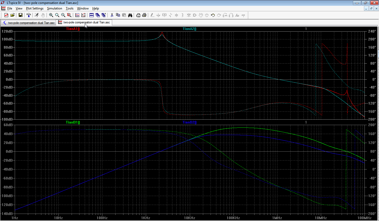

So, can system with good phase margin and gain margin oscillate, because instability of the inner loop?

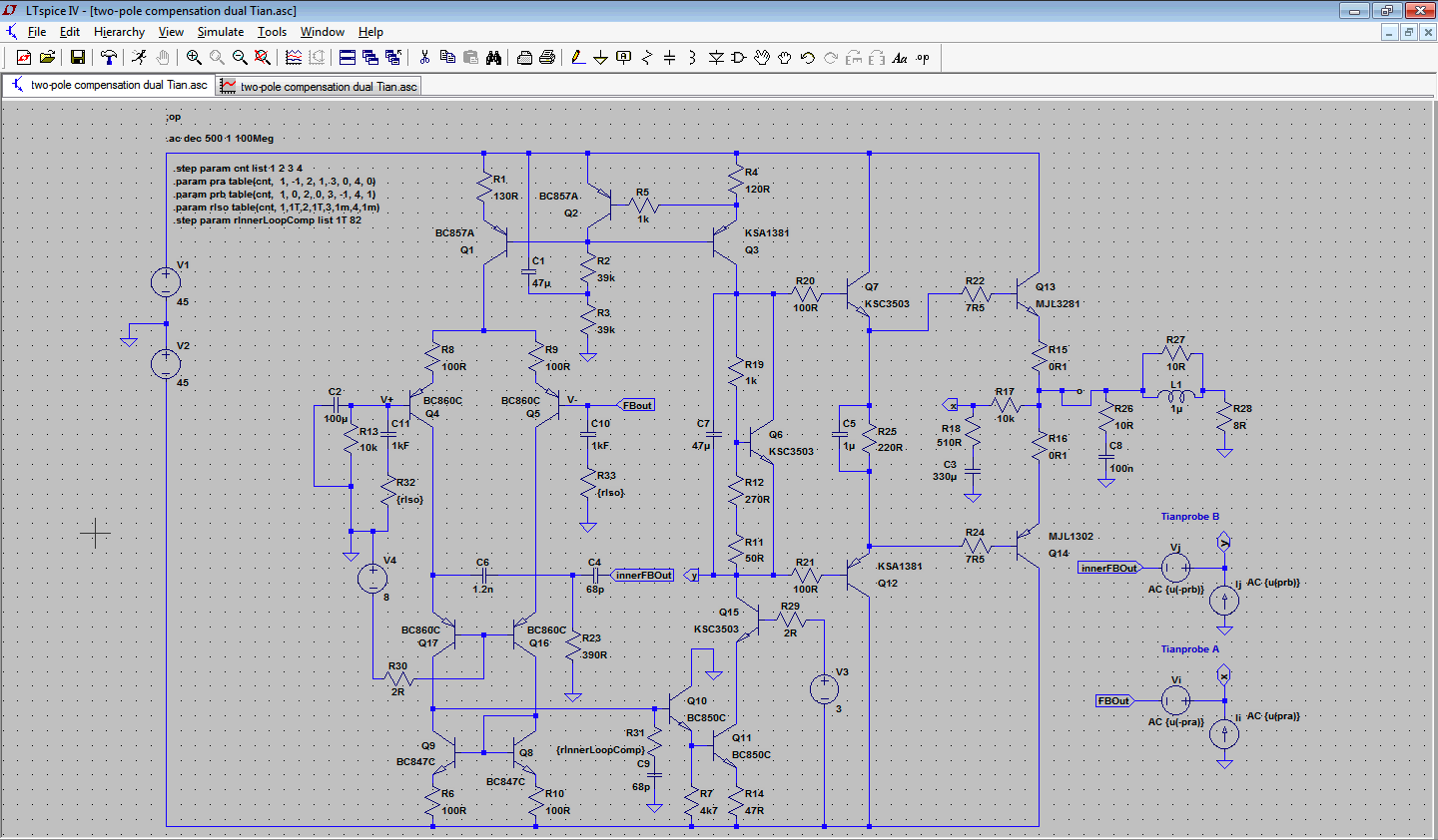

Could you post the ASC of this with the 'judiciously place RC' clearly marked so we can see for ourselves?It’s fairly easy to make a two-pole compensated amp where the outer loop looks fine but the inner loop is unstable (put cascodes in the input stage and VAS/TIS, beta-enhance the VAS/TIS, connect feedback caps so both casodes are included in the loop).
This is an issue that was brought to my attention when I published my two-pole compensation paper. Some people were unimpressed that I had suggested adding cascodes and including them in the inner loop (to improved PSRR), without addressing the stability of that loop. It was true that I hadn’t thought to check this, and sure enough, although the global loop was well stable with ample gain and phase margins, the inner loop was not stable! A judiciously placed series RC to ground in the inner loop can usually solve this problem.
How did you see the instability? Looking at Loop Gains (Return Ratios)? Or did you use .TRANS?
The usual place works - at the VAS/TIS collector. You can also place it at the base of the VAS/TIS - this is not a “standard” location but I have not been able to detect (in simulation) any adverse consequences of placing it there, the benefit of this location being that it has no impact on the amplifier’s slew rate. Never had the time to test in real life.
Bode plot of inner loop loop gain
HarryDymond said:It's fairly easy to make a two-pole compensated amp where...
I was about to ask the same as Ric so please add my request to his.
Could you post or link to exactly the ASC that shows this behaviour?
I have some suspicion that your inner loop isolation method requires modifications to the circuit and this may have mislead you.
I would be reassured to see a TRANS of the unmodified amp that confirms the instability.
Ric's question leads me to think he is on the same track.
So it would be useful if we all had precisely the same circuit to compare.
Best wishes
David

Unfortunately this is not true.In my opinion all the inner loops instability should be seen in the global (outer) loop
Oops!
Apologies to Dadod and others - I had misremembered my simulations from before. You can indeed “see” the effects of inner loop instability in a bode plot of the outer loop loop gain - the main loop is stable, but has an unpleasant-looking peak exactly at the unstable frequency of the inner loop. See attached images showing comparison of when the inner loop is compensated vs not (A1/B1 plots = inner loop not compensated, A2/B2 plots = inner loop compensated, A plots = outer loop loop gain, B plots = inner loop loop gain).
Enjoy!
Harry.
So, here’s a question for debate:
Given how much inner loop loop-gain gain has to be thrown away to compensate it (which presumably will result in higher distortion), is it actually necessary to compensate it, given that the effects (of inner loop instability) on outer loop loop gain are well above audible frequency range and don’t actually make the amplifier unstable?
Thank you Harry, that was exactly my thinking.
I looked at this somewhere in the tpc-vs-tmc-vs-pure-cherry thread.Given how much inner loop loop-gain gain has to be thrown away to compensate it (which presumably will result in higher distortion), is it actually necessary to compensate it, given that the effects (of inner loop instability) on outer loop loop gain are well above audible frequency range and don’t actually make the amplifier unstable?
As the Cherry cap is made larger, the '"main loop" becomes more stable but the "Cherry loop's" PM & GM deteriorate as the bigger cap applies more feedback around the inner loop. But the 'Cherry loop' never actually becomes unstable with bigger caps.
If you go the other way and make the Cherry cap smaller, the PM & GM of the "Cherry loop" get better but then get worse again and both 'Cherry' & 'main' loops become unstable simultaneously.
That's is with the 'main loop' always closed so shows the 'Return Ratio' of the Cherry Loop as recommended by Guru Zan rather than with the 'main loop' disabled as you show.
Haven't checked if this happens with lesser compensation schemes 😀
IMHO, this 'Return Ratio' with 'main loop' closed is the correct view.

Harry, can you show the Closed Loop responses for your two cases please.

I still suspect your inner loop technique misleads you, when you add enormous capacitors to try to disable the outer loop this different load means the inner loop result is inaccurate.
Did you see the screen shots posted in #711 above?
When the outer loop is simulated, this is “exact” in that nothing has been added or removed from any loop, save the Tian probe itself. This shows significant peaking at the frequency that the inner loop appears to be unstable according to the “disable outer loop” simulation method. If this inner loop simulation method were inaccurate, surely outer loop and inner loop simulations would show some discrepancy?
Thanks for the considered response, very fair points.
I wrote that I only "suspect" the technique.
It looks similar to techniques to plot outer loop gain that are now usually deprecated in favour of the Tian probe.
The broad principle seems reasonable, that it alters the impedances so potentially could alter the loop gains/return ratio.
But I don't have any analysis of when, or if, there would be a difference, so I wanted to raise my concern for discussion.
I will think a little more, any further comments appreciated.
Best wishes
David

Harry, can you post CLOSED LOOP responses of your #711 examples?
... If this inner loop simulation method were inaccurate, surely outer loop and inner loop simulations would show some discrepancy?
Hi Harry
I have had a serious think about this, run a few simulations and I still find the enormous capacitor technique is inaccurate.
When you disable the outer loop then you have removed a factor that does influence the inner RR when the amp is in normal operation.
However, the peak in the inner loop that you show occurs at a frequency where the outer loop gain has dropped to practically zero, so there is no discernable discrepancy there.
So it may not make much difference to stability predictions for a typical circuit.
But I think the more accurate technique shows results that make it easier to understand the amplifiers behaviour.
The work I have done to clarify this issue in my own mind has certainly help me understand better.
Thank you once more.
Best wishes
David
