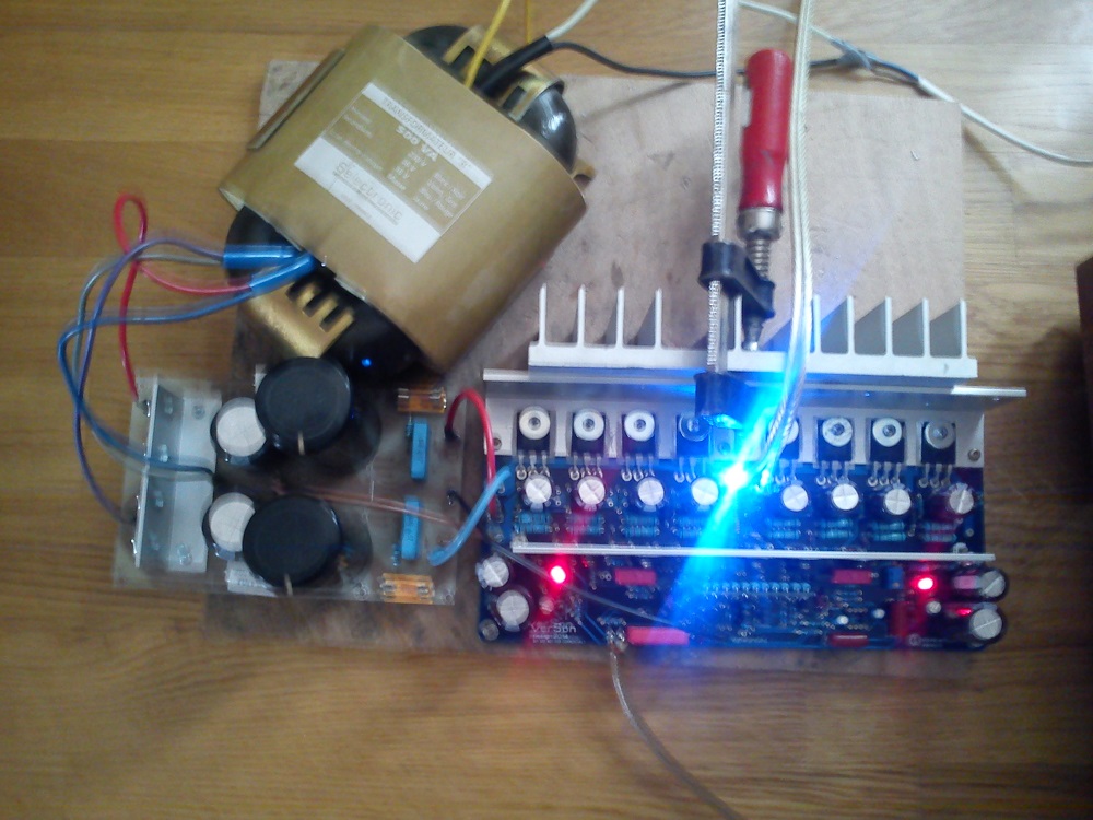

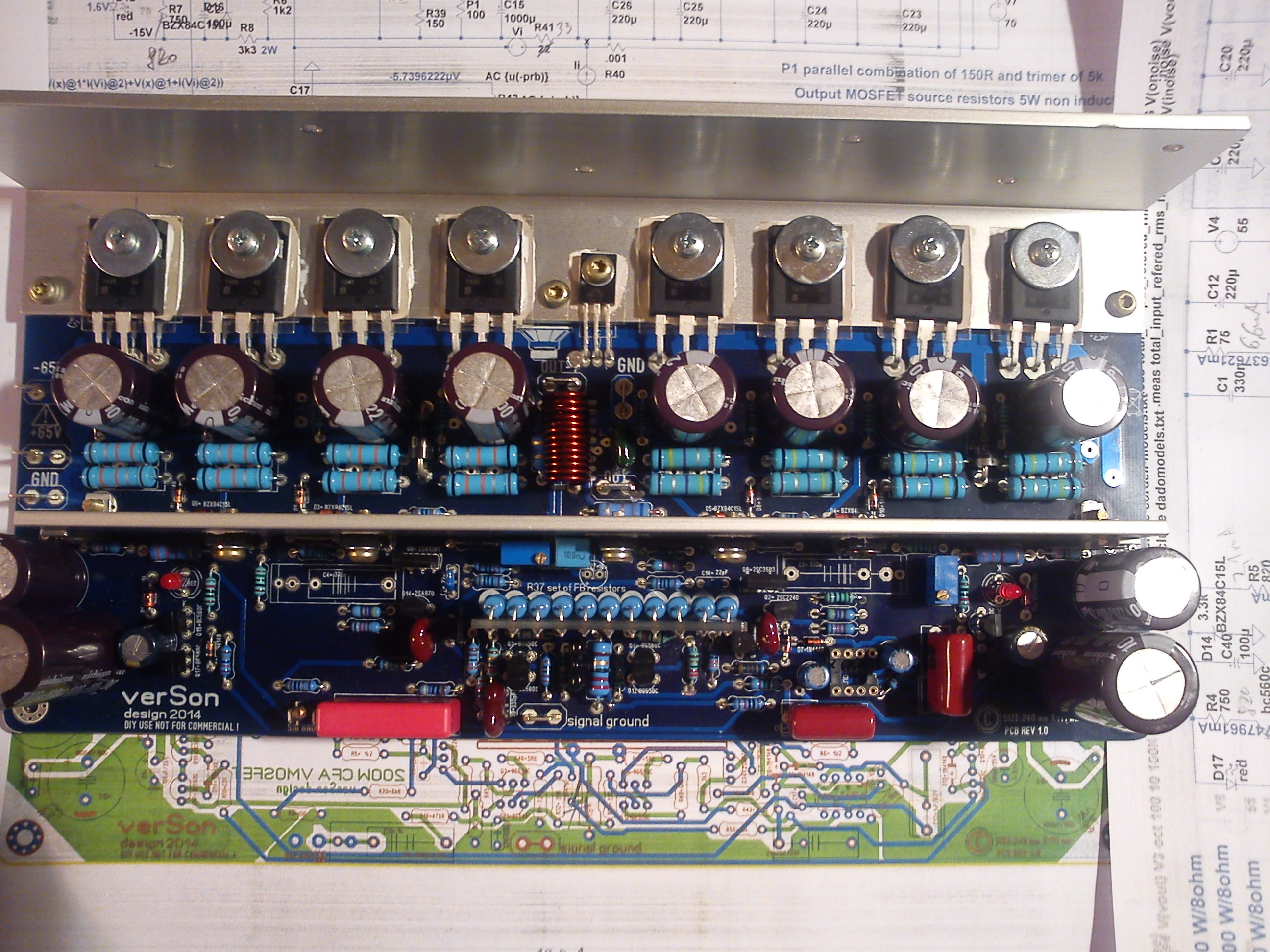

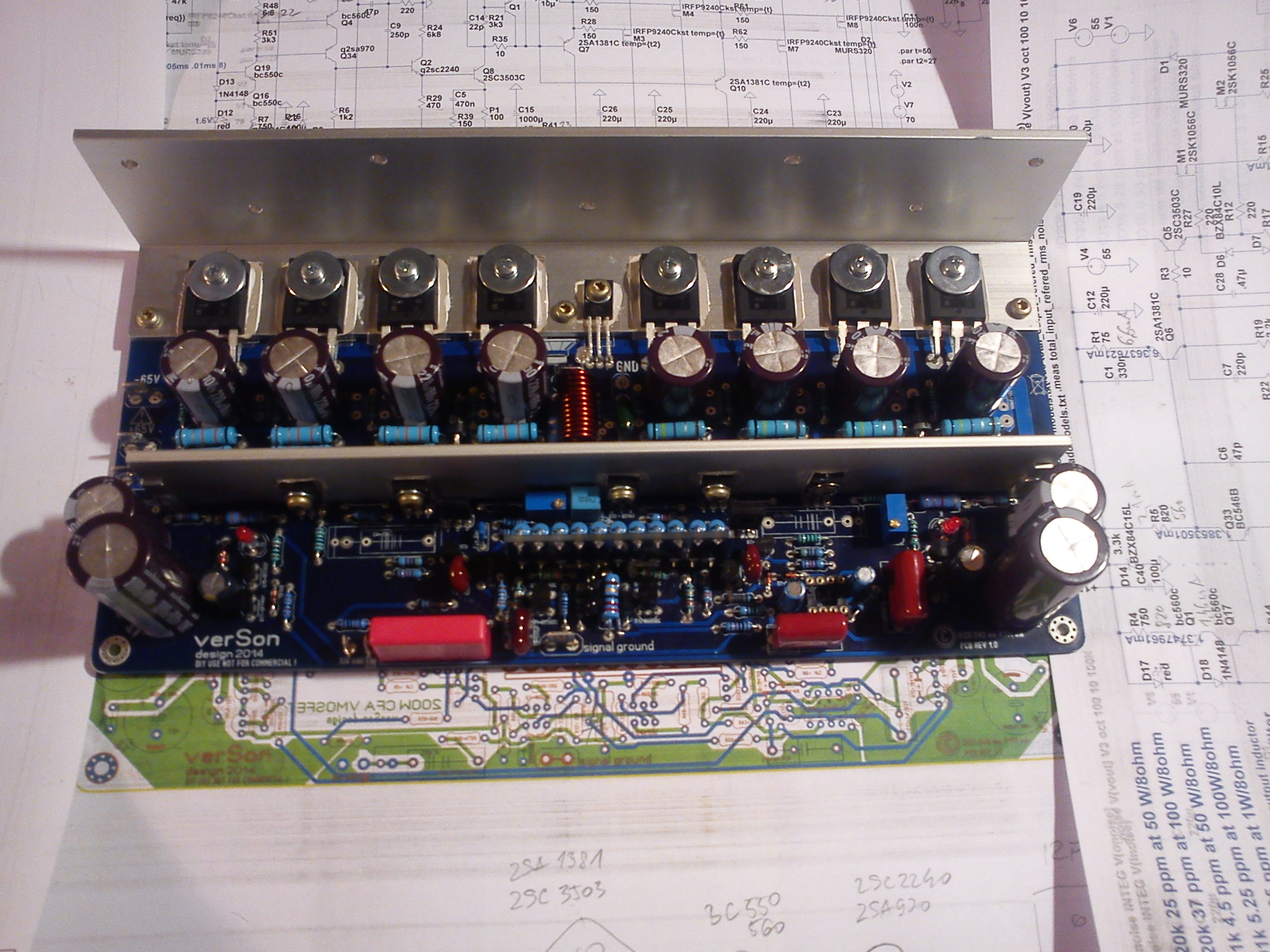

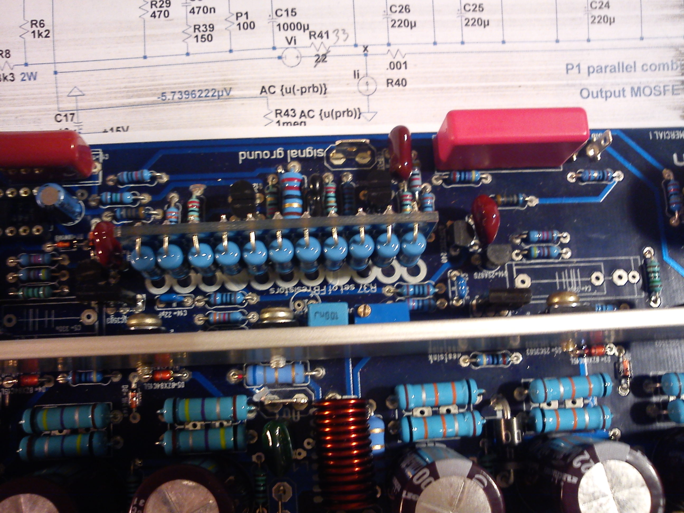

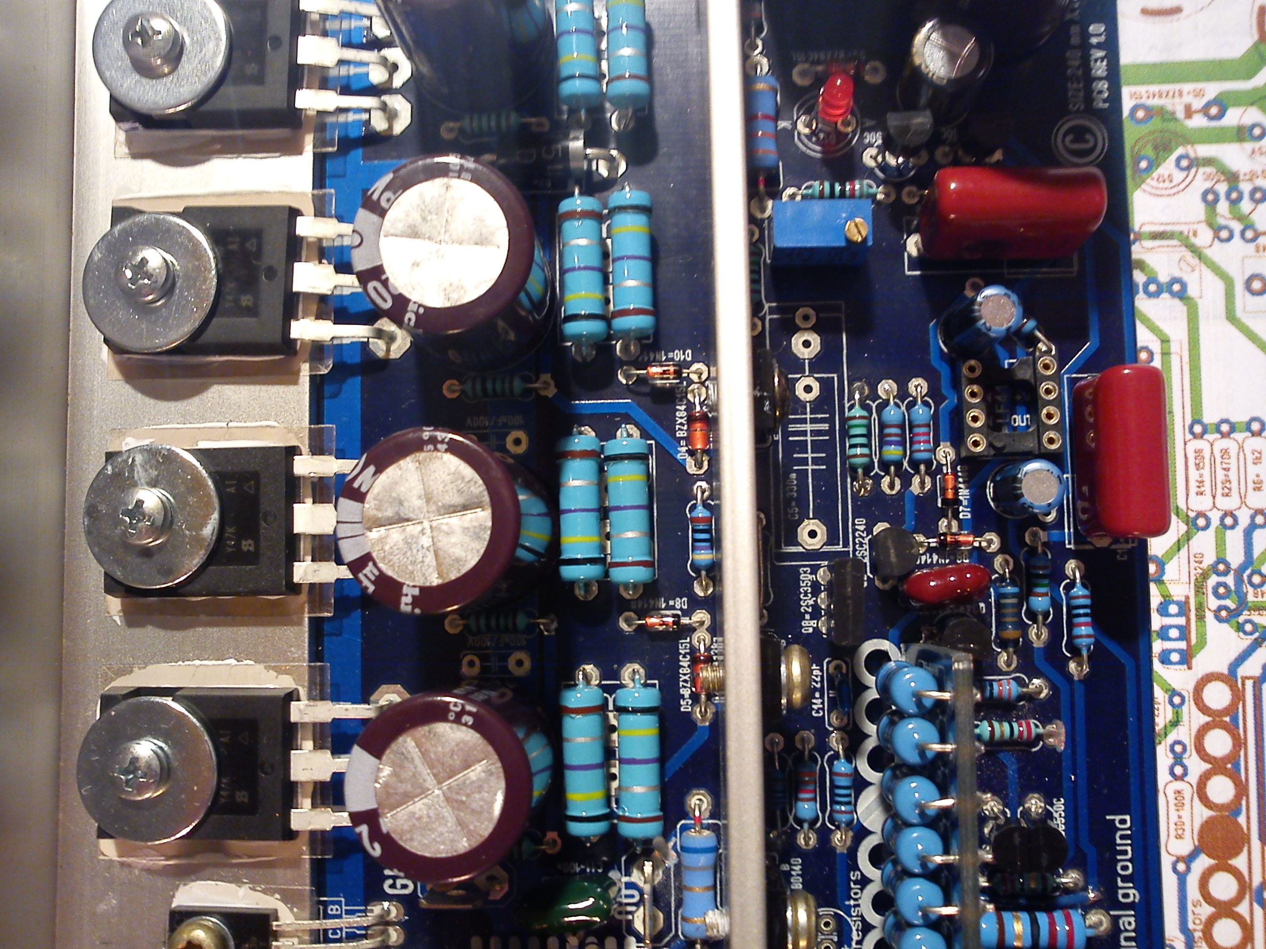

Finally I have something to show about 200W CFA VMOSFET.
I made big mistake populating first board, and I was to confident in my simulation and my layout. Nothing wrong with simulation, but I made to many layout errors, as missing connection, short connection and so on. It is not easy to trouble shoot electronic if there to many layout errors. I have found some but again my first board behaves strange and I was suspecting oscilation, but coud not see any with my scope.
Than I started second board and did it in small steps, first CCS only, than next some more connection, and then the VAS. That showed error and I found the layout error. Next where the drivers and again I found layout error. So I did it in steps and have found all layout errors.
It was thermally overcompensated and I added a blue LED between Vbe multipliers emitters and now the compensation was almost perfect, a bit overcompensate and that is good. From the room temperature up to 50 degree Celsius bias current drops less then 10%.
Not yet listening just bias setting and stability control, no oscillation.
It looks like the simulation was quite accurate thermally and electronically stability wise.
Time to repair the first board, I know now all layout errors, but during testing something happened, not sure what, and I have to find the what vent kaput. I hate desoldering from double sides PCB, metalized holes are killing me.
Here are some photos.
BR Damir

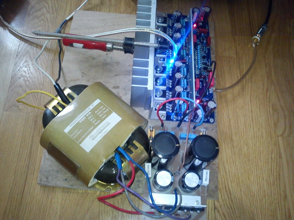

listening report-one channel
First I did some testing with +-50V power supply as that one is with the higher voltage I have and it showed good behavior with 8 ohm load. As I have only quite small heatsink I did not push it to far, but sinus and square waves were good(I have very simple signal generator home made).
Now came some listening with one channel only and without DC servo opamp in the socket. I have some problem with DC servo, it looks that it has some motor booting effects. DC offset with no opamp was about 100mV and that is not problem for my loudspeaker.
It is very quiet, I can't hear anything with may ear close to the loudspeaker, no turn on tump, and music is playing very nicely, all caps are new, power supply is new, unused yet. I am very satisfied with my first 30 minutes listening, as with that small heatsink it get quite hot, so I switched it off.
BR Damir

😎 :up:
Way to go Damir, Slow and Sure. Just let me stop drooling over those beautiful Power transformers. I hope they make them big enough for my 400 watter as soon as you finish perfecting your design, which should be soon. Who is the manufacturing company for those.
Keep up the excellent work, and do not let the grand kids down, they have a great Grand Dad.
Hi Chris, I am afraid I forgot what was the name of the shop where I bought the transformer, only remember it was French. Transformer on the photo is 500VA and not enough for two 200W channels and the voltage is only 2x36V AC, planed for my TT amp.
