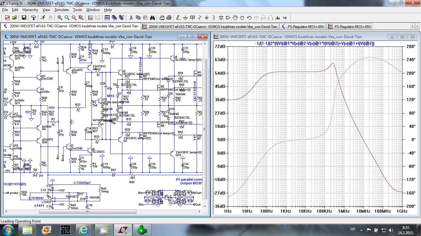

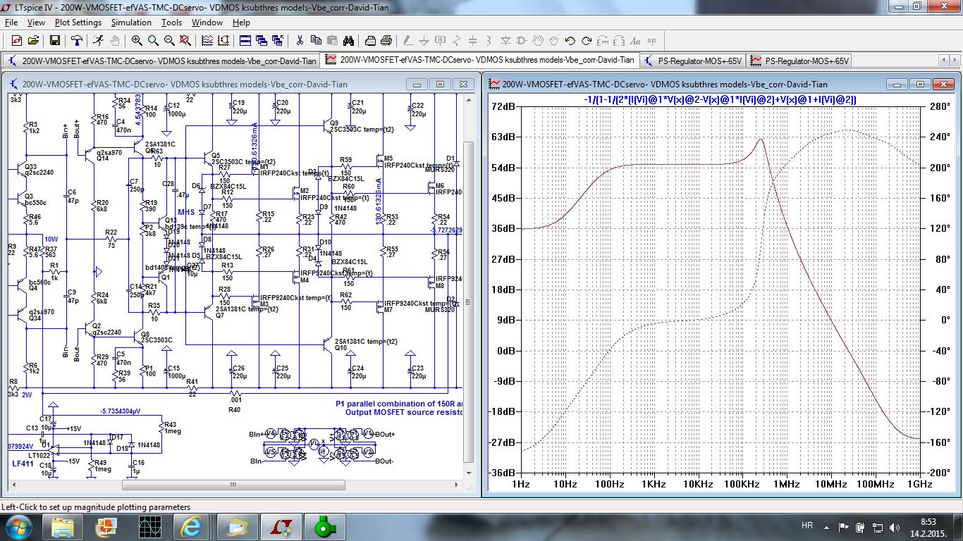

There is one question that bother me with LTspice simulation. I tried my 200W VMOSFET amp to simulate with TMC, and I did two simulation, one to check global LG, and second one to check only local compensation LG.
The global LG looks good with good PM and GM and it looks very stable on different capacitive loads, but local TMC LG shows strange phase behavior and I am bot sure how to interpret this.
This happens only if the RC was connected parallel to the VAS emitter resistor. That RC decreases THD20k from 0.000804% to 0.000365% at 50W/8ohm.
Please comment.
BR Damir
Hi Damir , hope you are well
I dont know what to make of the rather strange phase behavior but I posted months ago about the fndings by the designers at TI. They have obviously studied such behavior with their opamps and their conclusion was that stable inner or local loop phase behavior is not a requirement for overall stability. What is important is the outer feedback loop. See their datasheets on various opamps, its clearly stated in nearly all of the newer designs. Ive come to the same conclusion with my amps. Many of the so called gurus here will tell you otherwise but the truth is they should rather argue their case with the actual designers like those from TI which place actual working products on the market.
Hi Miguel,
Thank you, I am well, strangling with my 200W VMOSFET. It is very easy to get unequal currents, just small matching difference in Vbe and the currents vent astray.
Thank you to comforting me about inner loops, outer loop looks very stable.
Haw are you, well too I hope?
BR Damir

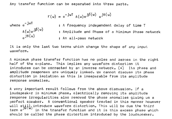

Well a necessary but not sufficient requirement for NMP behaviour is 2 separate paths that the 'signal' can take.
I wrote the stuff below in 1979. There's more in the paper Is Linear Phase Worthwhile? and even more in the Engineering Memo from which the AES paper is derived including a derivation of the Hilbert Transform relationships (which at that time) were unique to me. I did that cos I couldn't understand Bode's maths.Strictly, this is not correct. As you comment below, a time delay can cause NMP behaviour with two separate paths.
But a time delay clearly is not plausible here so it seems beyond reasonable doubt that the cause is the multiple paths.
My ref (4) is p312 of Bode.
I don't regard a Frequency Independent Delay as NMP behaviour. It's really the trivial case.
However, such a delay may lead to NMP behaviour if the delays are different for the different paths.
